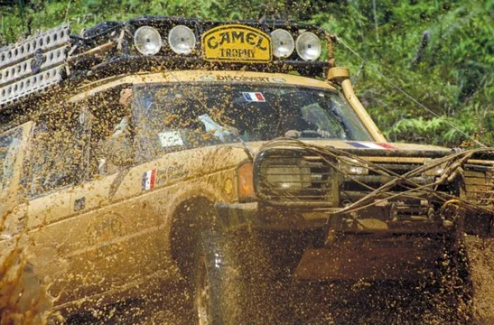

Although....
new-york-auto-show-classics-suv-etc-land-rover-luxury-off-road-04-land-rover-discovery-camel-...webp
I also ran into a Land Rover club out wheeling once, their dress code was polo shirts, dockers pleated shorts, socks and sandals.
Nice. I have done some reading on those and it seems they pretty much leak oil the whole time. The only time they don't is when there is non left to leak. I do like the look of a sweet rover though.

That's a great pic ;)
