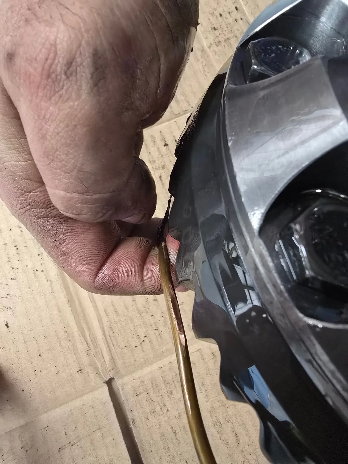

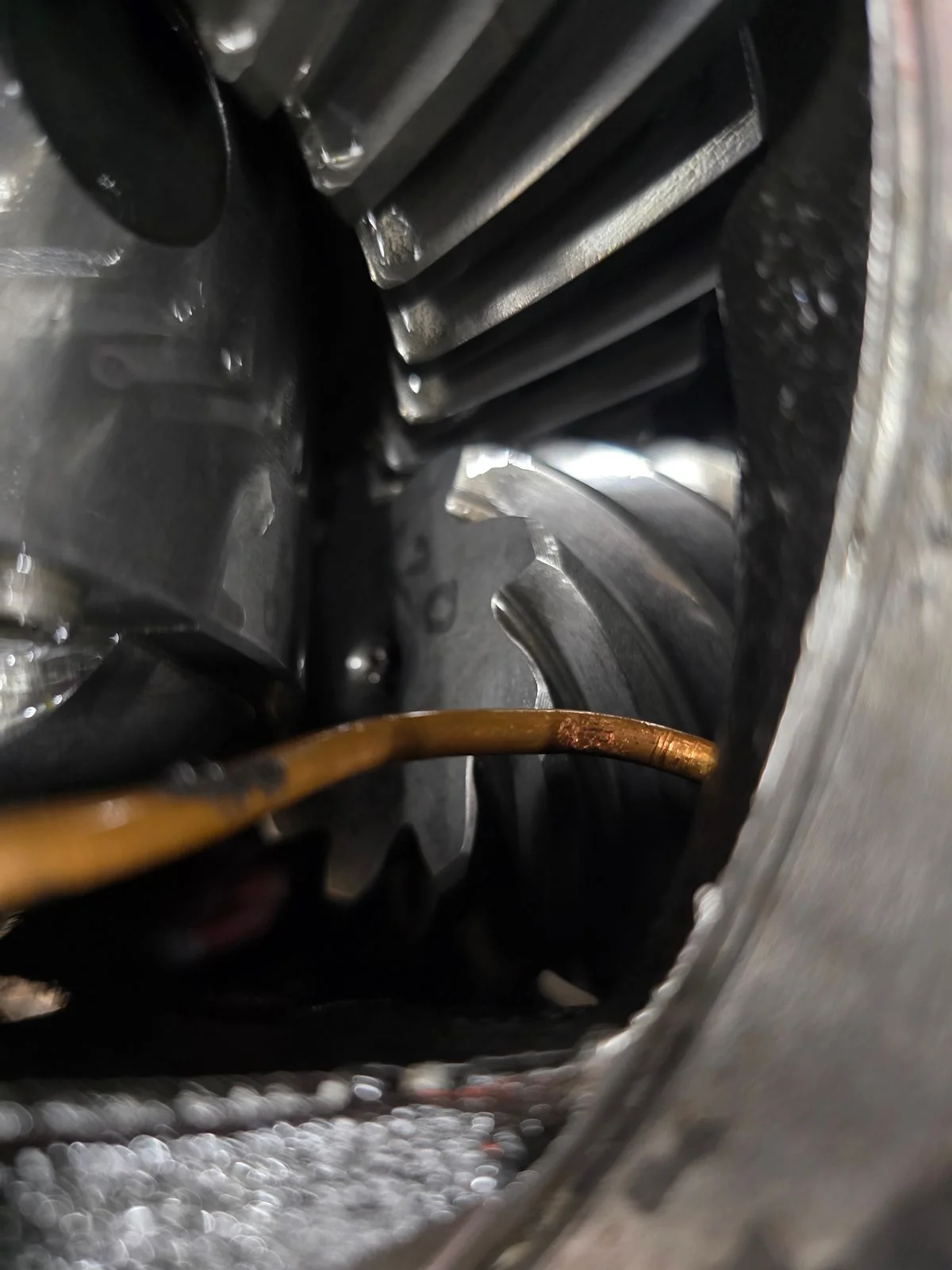

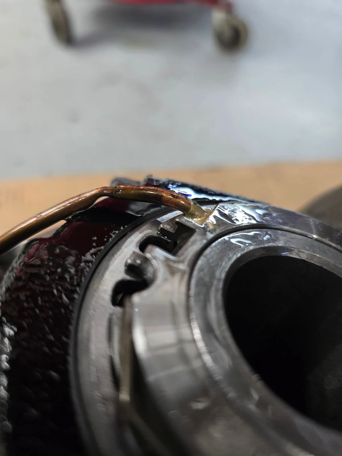

On November 24, I engaged the front and rear ARB air lockers for the first time since the re-gearing, and the compressor failed to stop running, indicating a leak in the system. When I contacted Vlad about this, he claimed the air lockers were aftermarket and not installed by his team, though he stated they were tested and operational without leaks before returning the truck to me. He advised me to take the vehicle to whoever installed the lockers for repairs.

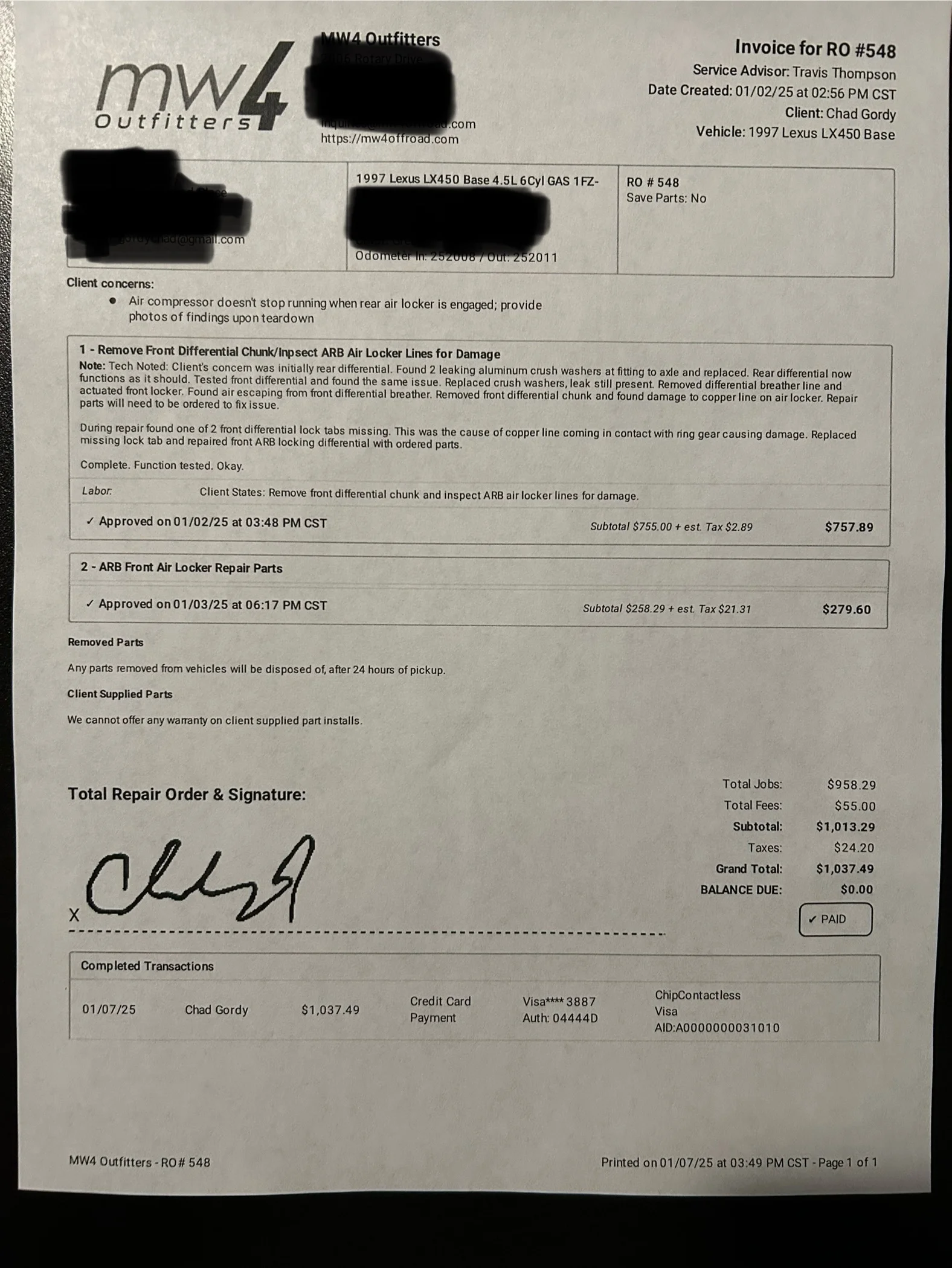

January 2, 2024 I took my truck to a certified ARB specialist who found:
1. leaking crush washers at the front and rear air line fitting to the axle.
2. damage to the front air locker copper line
3. Missing differential locking tap in the front causing damage to the internal copper tube.
I encountered issues with accountability post-service. I sent an invoice and photos to be reimbursed and have heard nothing. They did give me a bag of seat bolts and 2 molded foot steps.
