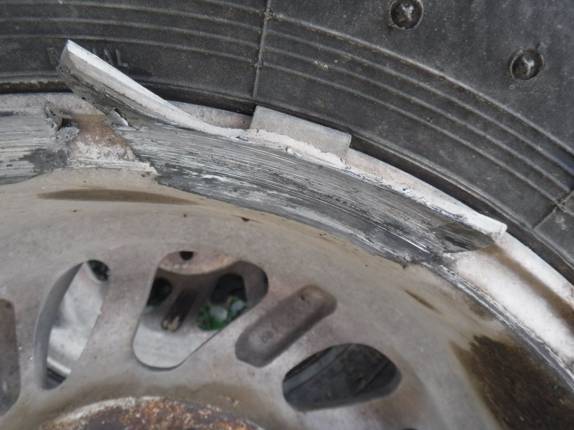

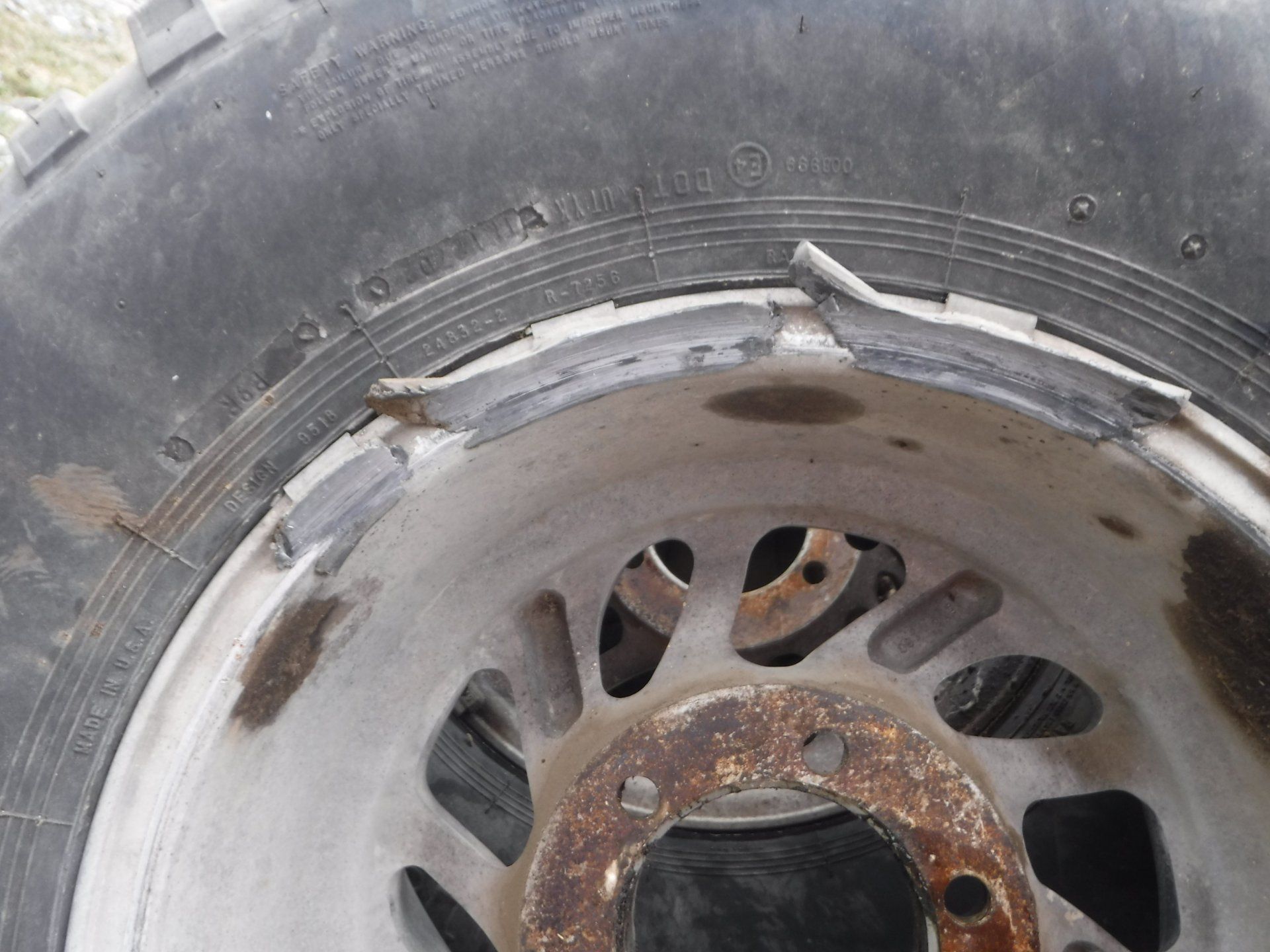

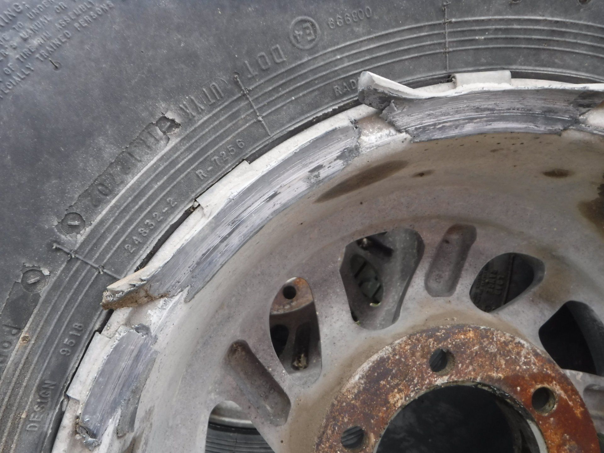

pulled this parts rig home a few weeks ago and removed the front tires and this is what I found.
Mag wheels are just so wrong. People tell me again and again 'Mark, don't be a hater' about my loathing of mag rims. But when you've seen as many f-ed up and unsafe cruisers as I have, it's reflexive.
Seen a lot too..turns a classic cruiser into an 80's yard sale!! I think the problem started when people figured out that Chevy had the same 6 bolt pattern, that really opened up the crazy wheel selection and why so many cruiser's got weird wheel and tire combos!
