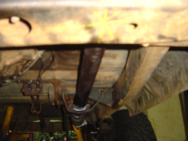

Sorry I missed your question. I haven't checked this thread for over a year.
I had a vibration/noise issue that was related to the clutch. It went away when I later replaced the clutch.
But as far as drivelines, I was very careful to maintain driveline and flange orientation throughout the project. I realigned everything as it was before. No problems there.
