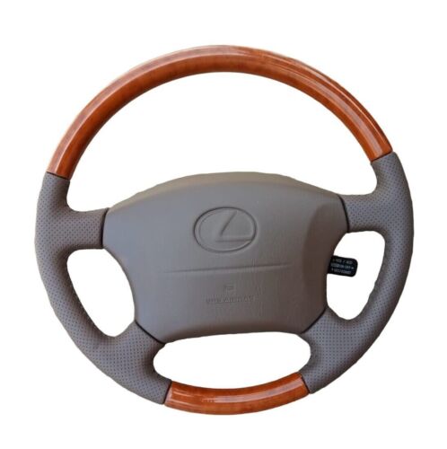

im still looking for someone to do the steering wheel. zero luck so far, no one wants to touch it because of the wood.
I've been watching your thread with admiration and interest, nicely done. Anyway, I'm guessing your going to do a nice clean up and shampoo job on the upholstery in there? I find it interesting that where others would see a pile of crap sitting there, you pictured a diamond in the rough. Very commendable. If I were closer I would volunteer to help in any way I could if you needed it, but it appears you have it completely under control.
I got really lucky on one of the eBay wheels from Taiwan.
