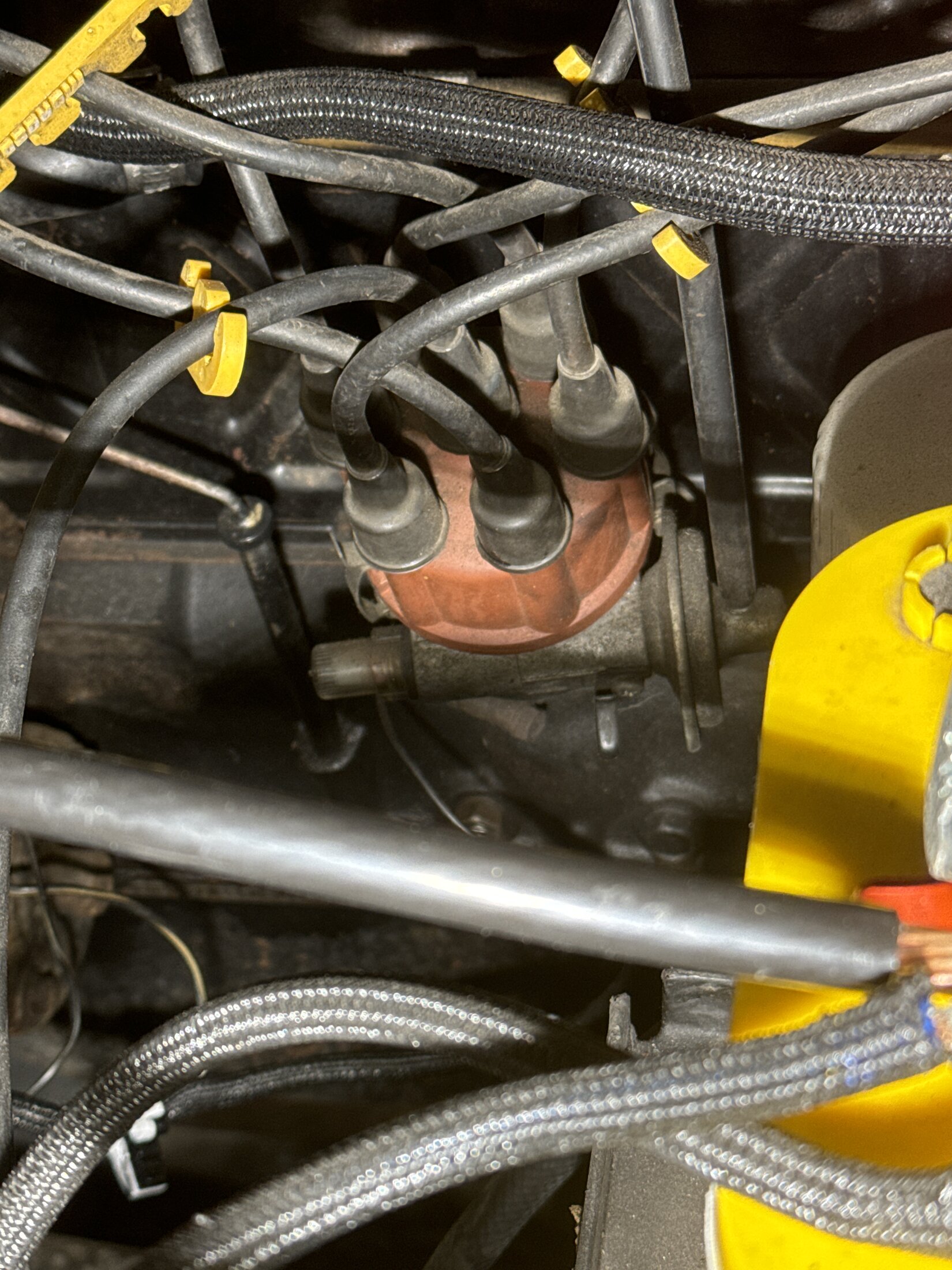

It is possible to run the distributor-points, on the negative lead of the ignition coil. A capacitor is installed on the distributor body, which isn't used with the igniter. It is how the early distributors worked. The retrofit is even mentioned in the Hayne's manual - probably the only hack / mod in there, p. 96. So, if your igniter goes out, you can keep going.On a side note: Would there be any reason for a FJ40 to not have an igniter? Is that a spareable part meaning if you don’t have one just do this … “x” … ? Or is that something i should jump on right away and get ready to wire it in?
What’s the numbers on your distributor? Pics of it? Do you know if it’s points or pertronix? Igniter could’ve gone out and they converted it for a cheaper cost.

Ok I tested the ignition switch - I had another steering column (OEM) sitting around because I will be switching back to OEM from this 84 4Runner one … anyways it has a different ignition switch than the one I’ve been trying to get car to run with and bamfires and works great. Ah it’s so nice to hear that carb running perfectly. Love that sound.
BUT, I’m still curious about this igniter guys, should I need to get one and install it regardless? I didn’t know it was missing until this thread. Also, (sorry) but i wanna quickly clarify - should my coil get key power upon one single turn forward of key?
