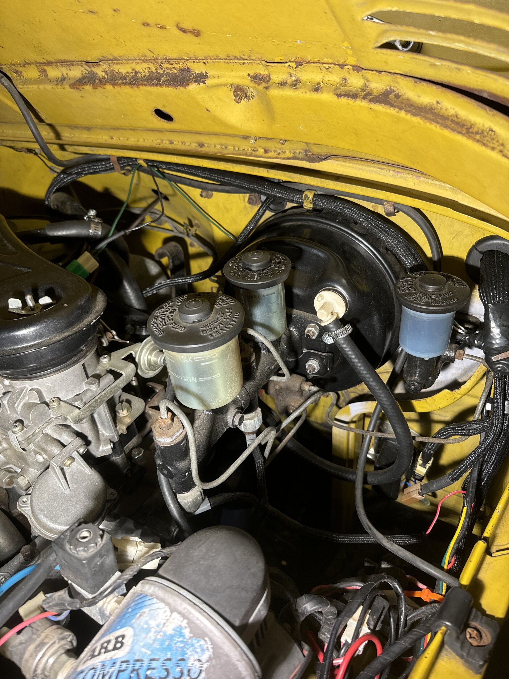

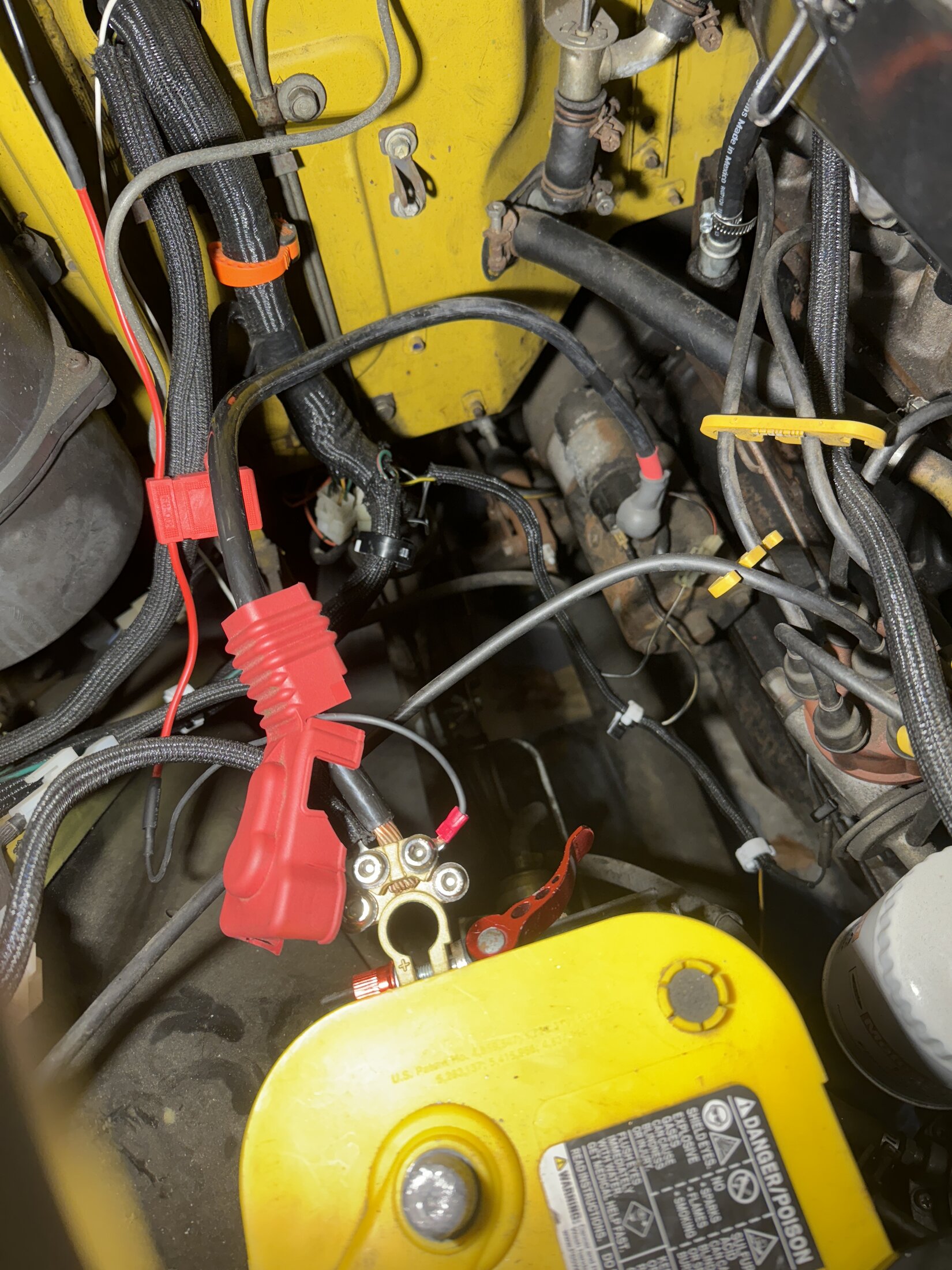

OP, let's get a pic of the DS fender showing the wire harness along the fender. You should have a wire near the brake MC that is your source of keyed ignition for the solenoid. I'm going from memory here but it comes out of the harness right were the wires to the MC come out. I converted from aftermarket to a '76 carb a long time ago and that's were I found the single wire source.

Here are pics requested.

Put a volt meter on the brown connector by the MC to see if that is the wire to your solenoid, i.e. does it get keyed 12V? I know its too short but that looks like it could be the original source for the solenoid.
That’s my wiper fluid plug I believe .. based on wires colors and diagram .. but I’ll check that for you real quick anyways. Ya those are my “blues” - wire colors - and those are part of the wipers lines. I pulled the wiper fluid tank and that’s its hook up. Checked off
