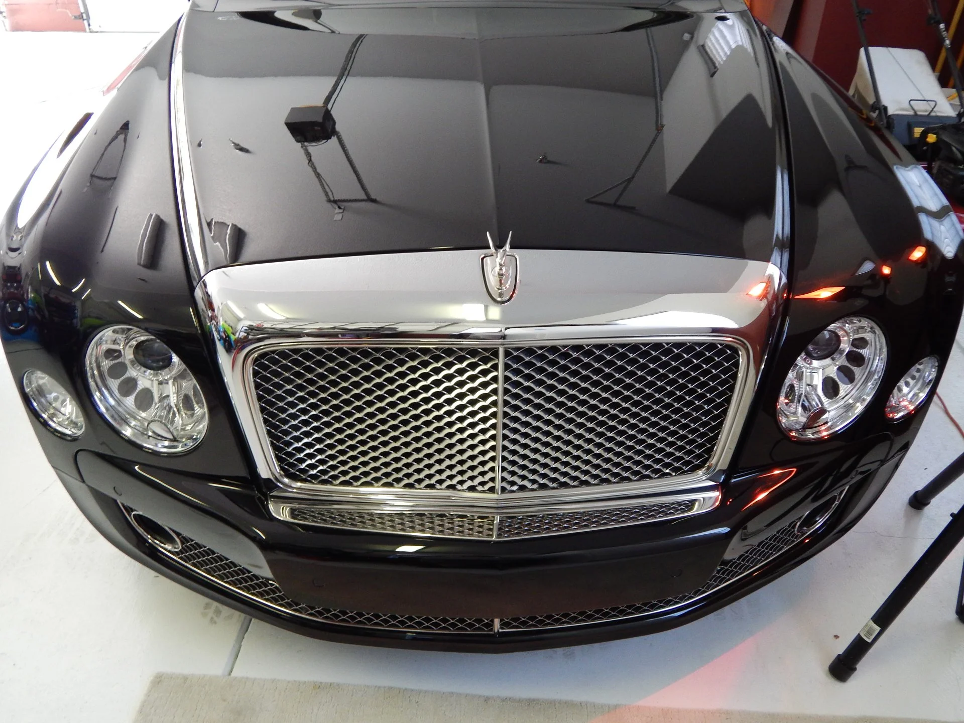

Because its a nano ceramic coating. You use a few drops on your applicator for each panel ! wait no more than a minute and then start to level wipe. I am a now retired Ceramic Pro installer , that was one of the first installers years ago , and have coated many vehicles ( Museum automobiles , One of a kinds, Exotics, classics, etc. ) The thing though with coatings , is that they will show all defects on the vehicle , unless you correct the finish first ! So you'll need to do anything from Dry sanding, wet sanding, Compounding, Polishing to get all defects out first, then use a bare minimum a spray like invisible glass to remove polishing oils off the vehicle to better to use IPA ( not beer ) and even better yet PpG solvent rinse let dry and wipe off BEFORE you Coat ! Otherwise, you'll have shiny defects that really stick out !

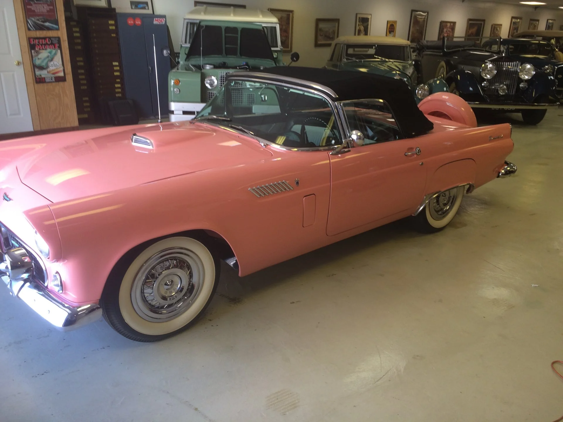

Hmmm… that is some beautiful gloss. I have a 1956 Ford T-bird that will seriously benefit from this application. There is no orange peal and the surface is glass flat but no where near the gloss level. I need to try this on a cool fall day
nice ride by the way!
you don't want to apply a coating anywhere but inside a garage ! Its not just wipe on , wipe off ... if you wait too long before wiping, you'll have to sand it off , lol
Nice on having a Tbird ! I polished and coated Marilyn Monroes Tbird ....

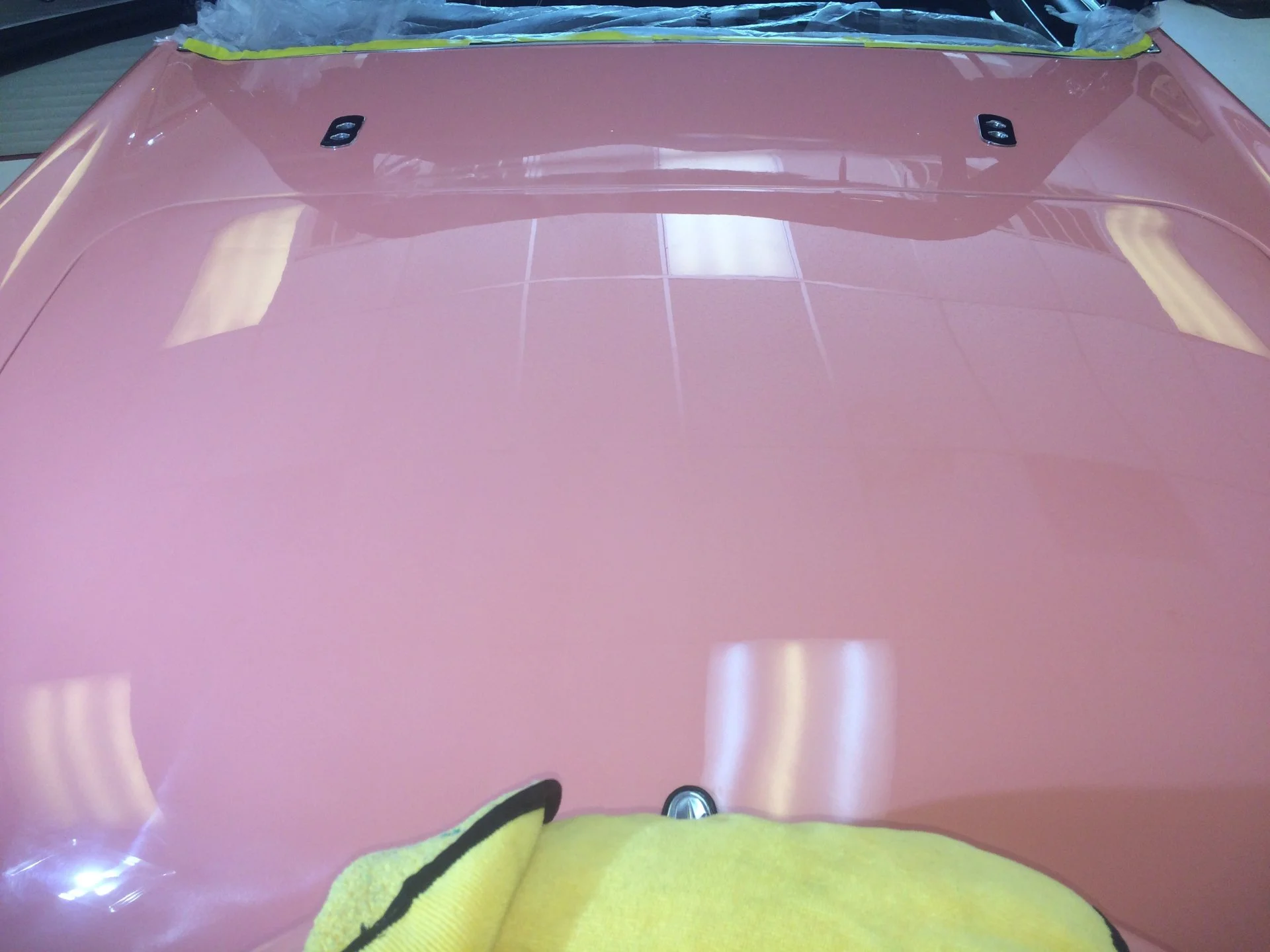

You'll need to polish it with a D A ... I use a rupes big foot 21mm , various pads , good self diminishing compound and then finer and finer polishes till you get the super high gloss , then solvent to remove those polishing oils and a wash in Dawn soap , then start to coat ! That Bentley had 5 coats of Ceramic Pro on it ! 4 coats of 9H and 1 coat of Light ! Then once your car cures completely from what ever true ceramic coating you get ( sprays are not true ) then your car will require less washings and you'll see dirt just blow off , and it just stays cleaner longer and is easy to maintain ! Oh and one last tip ... Always dry your car with a air dryer or leaf blower ...
heres after my final polish on her car
Once again….wow! Looks like a skating rink. Once my garage is done, this looks like the second project going in. I’ve printed your sequence as a reminder. Excellent work
you know, you can see the color difference in the fluorescent bulbs in the ceiling from the reflection. The middle bulb is warmer

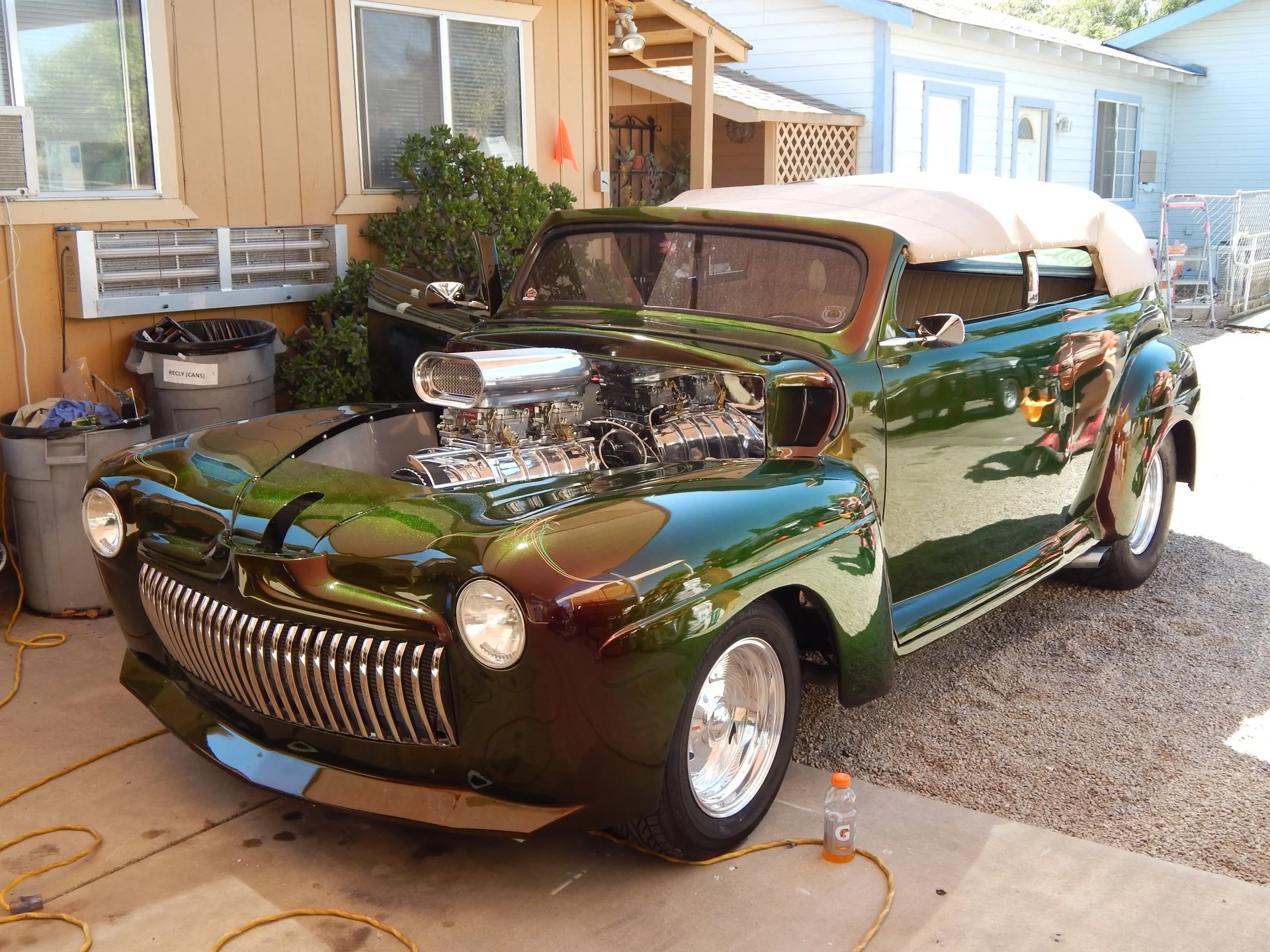

1936 Ford I sanded and polished and coated ... "detailers selfie" ...

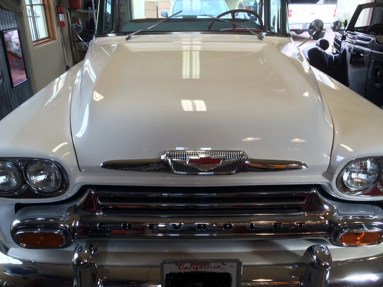

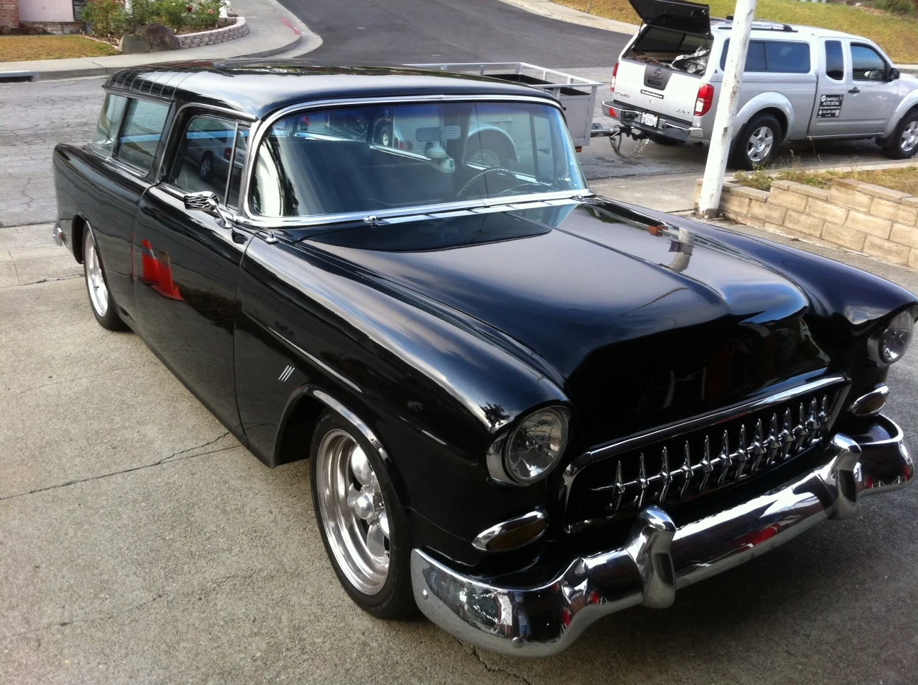

55 Nomad
