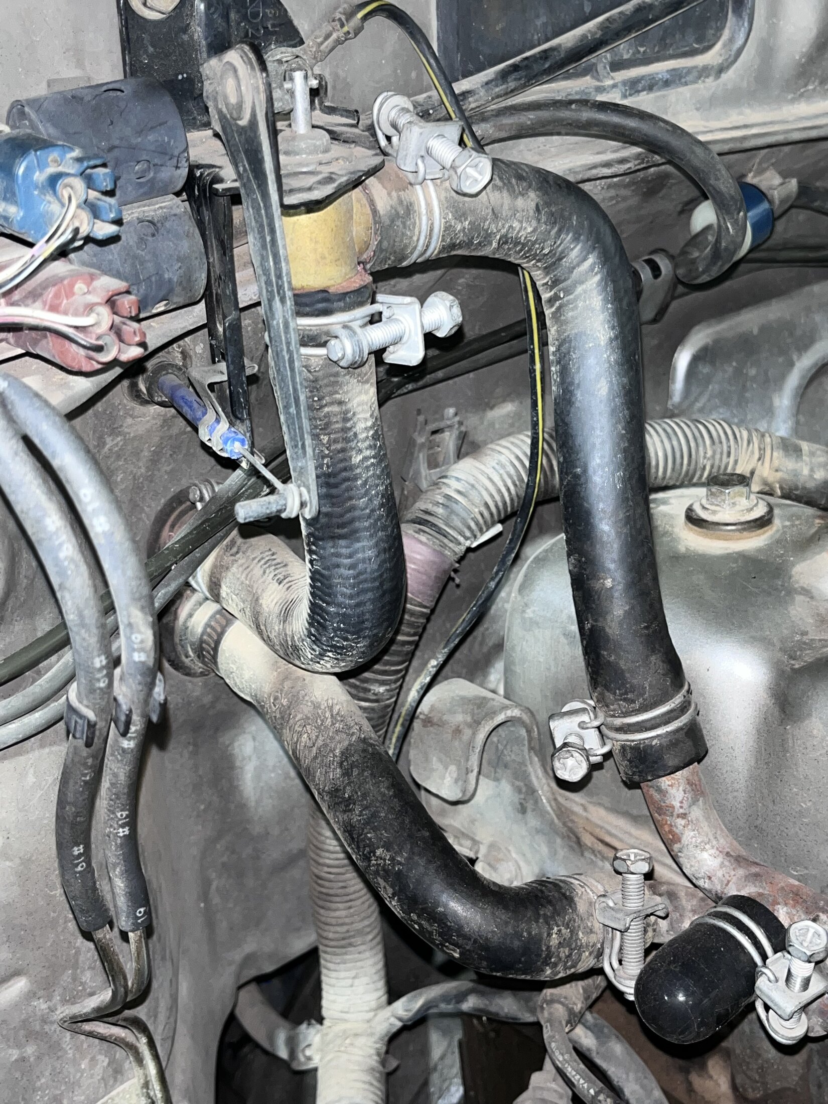

Hi, On a fj62 what’s the Gates part no. For the heater hose on the control valve on the firewall that looks like a big question mark? Thanks, Mike
28466 is a 90º that I think you would want for connecting the heater valve to the fitting at the firewall for the heater core (if that inlet is a 16mm / 5/8").

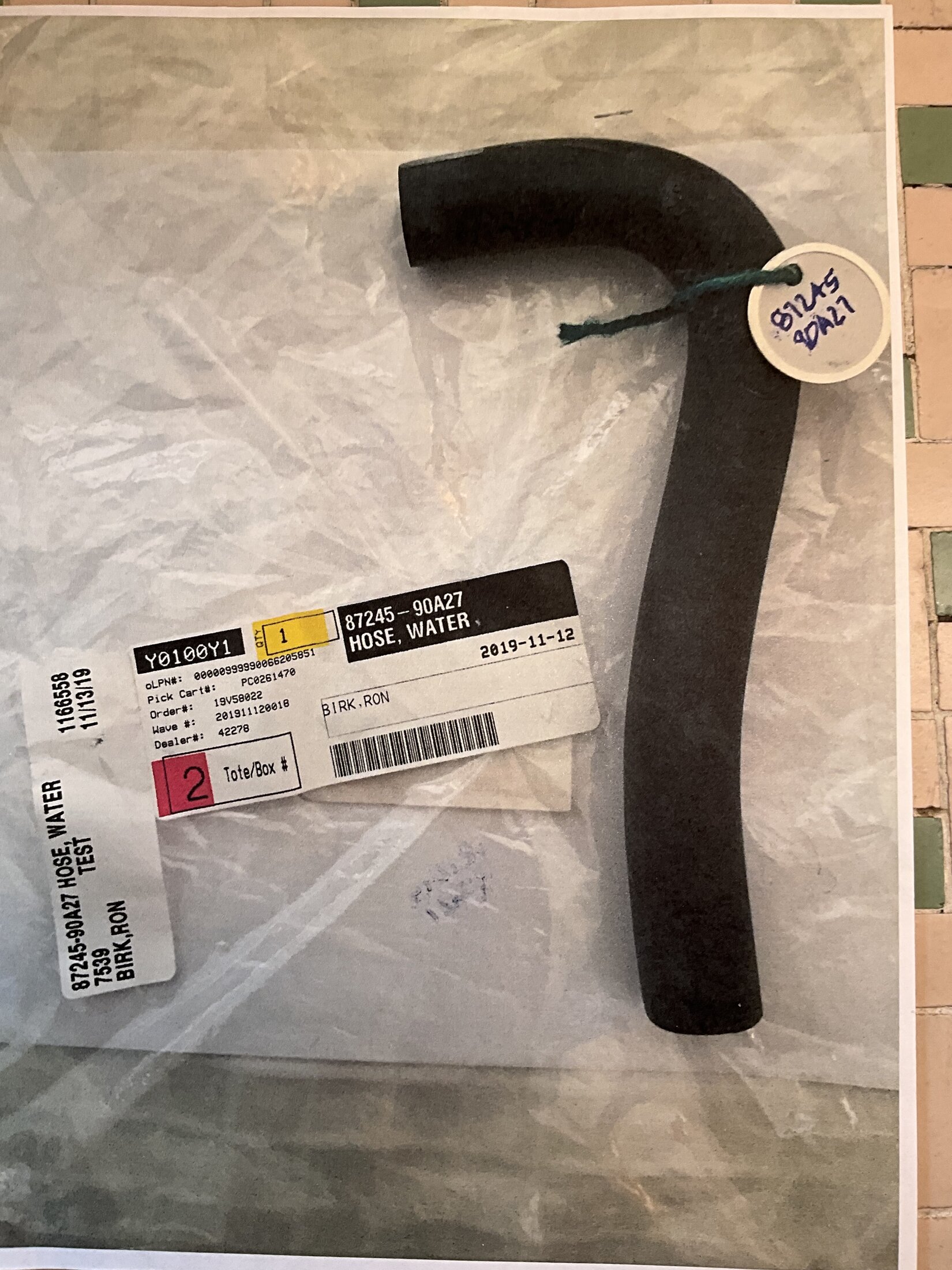

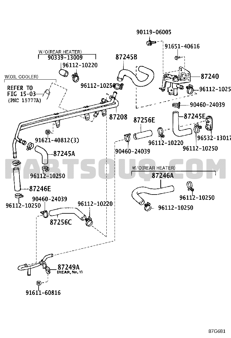

If I'm correct, you're looking for the one that goes from the "side" connection on the heater valve to the heater pipe on the block (87245B in the picture, but shape-wise looks like 87246A)?
If yes, then you might still be able to get the OEM hose, P/N 87245-90A27
I believe the nipples there are 13mm (1/2"), so obviously you wouldn't want to use an alternative that's a 5/8" diameter.

You might need this too, see it in the lower rh corner of my previous pic

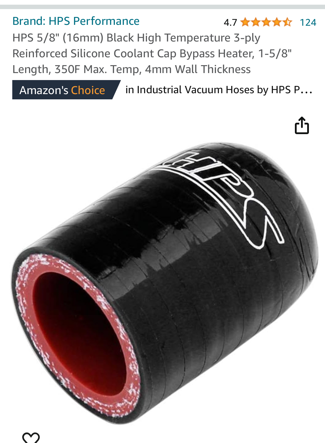

I did notice you had a cap on there. I'd definitely go the HPS route if I was looking to bypass my rear heater permanently given how long the silicon parts last, but since this is hopefully no longer than just the summer months I plan to just use an inexpensive parts store cap.

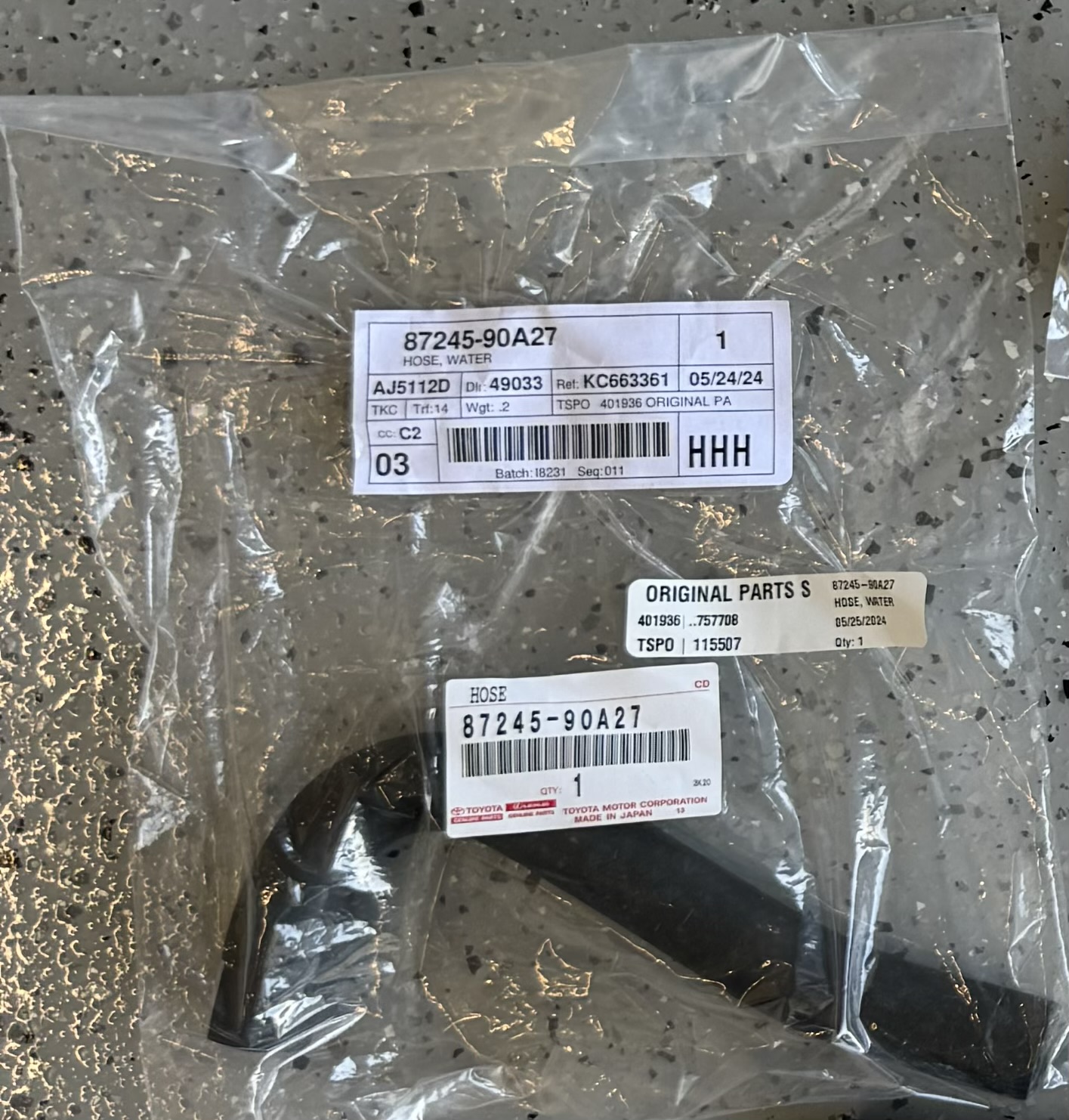

You may have already found one, but if not, I just bought a new OEM question mark from toyotapartsdeal. Here’s the part number.
