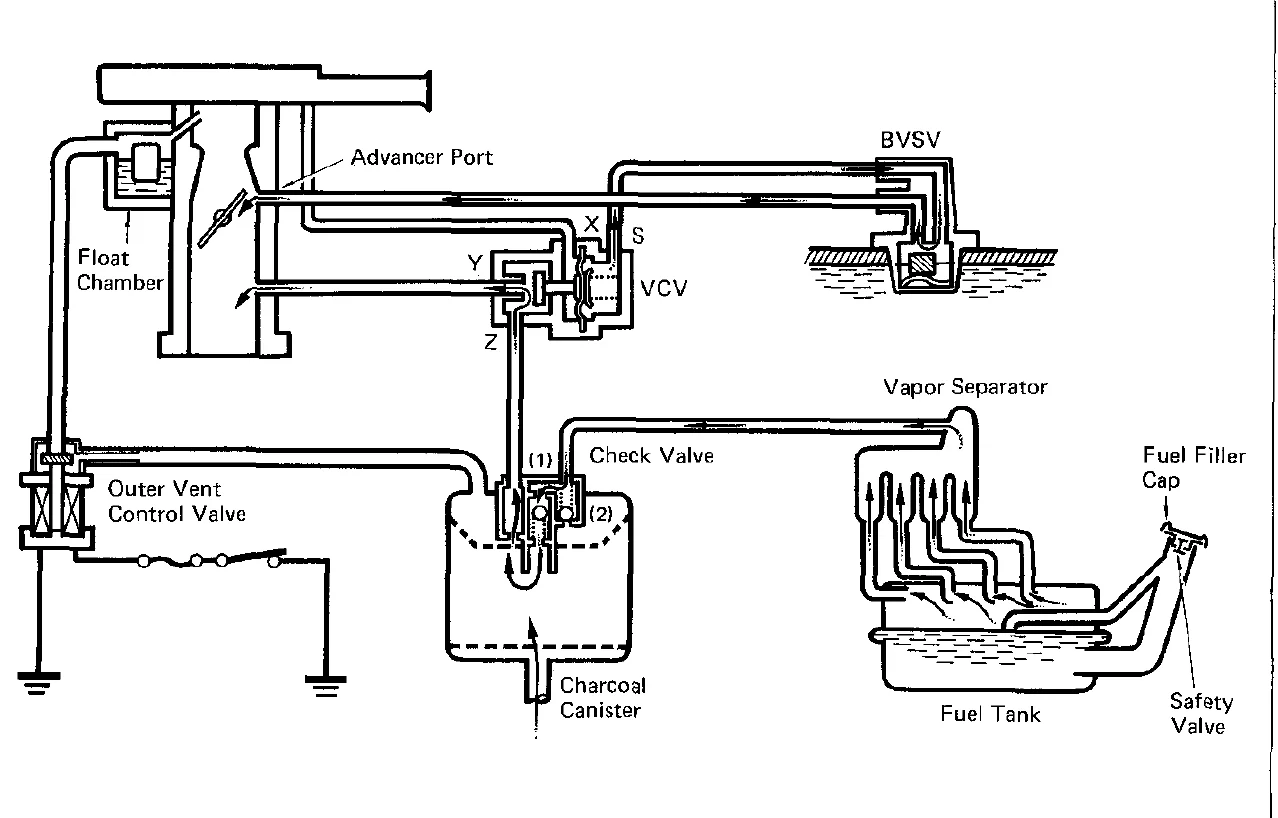

The device is a vapor separator. It separates any entrained liquid from fuel vapor before capturing the vapor in the charcoal canister. I think for it to work properly any liquid needs to be able to freely drain back into the fuel tank. The separator is located more or less directly above several ports on top of the fuel tank. If you move the separator to the other quarter panel I think you would have a hard time routing the hoses so there are no low spots, etc.
I think it would be easier to install your amplifier in the other quarter panel, or under one of the front seats.
