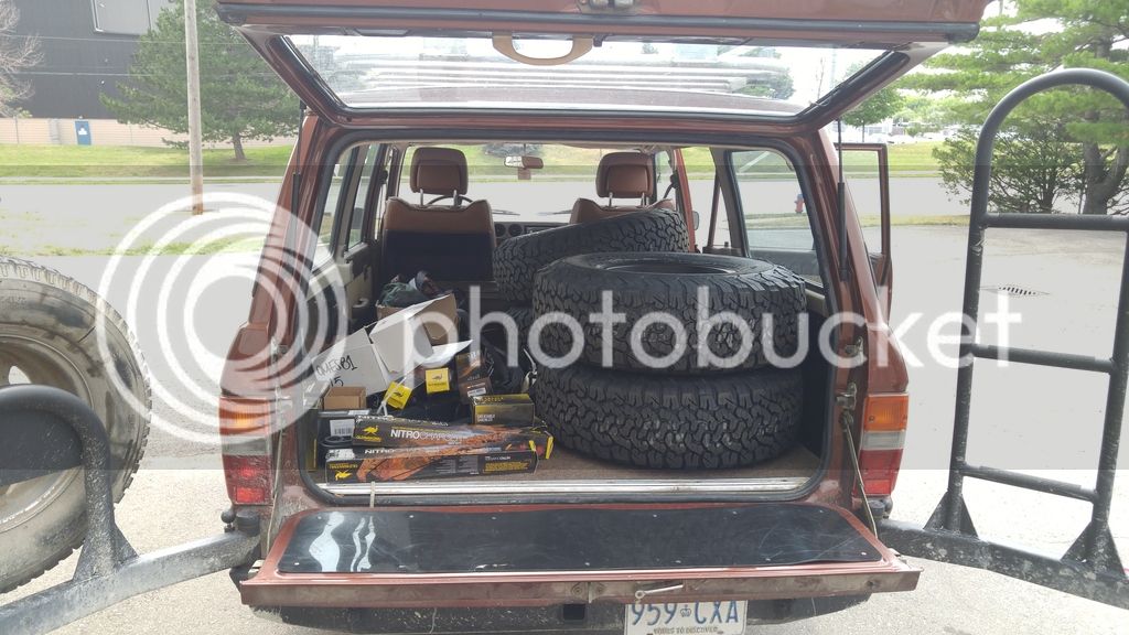

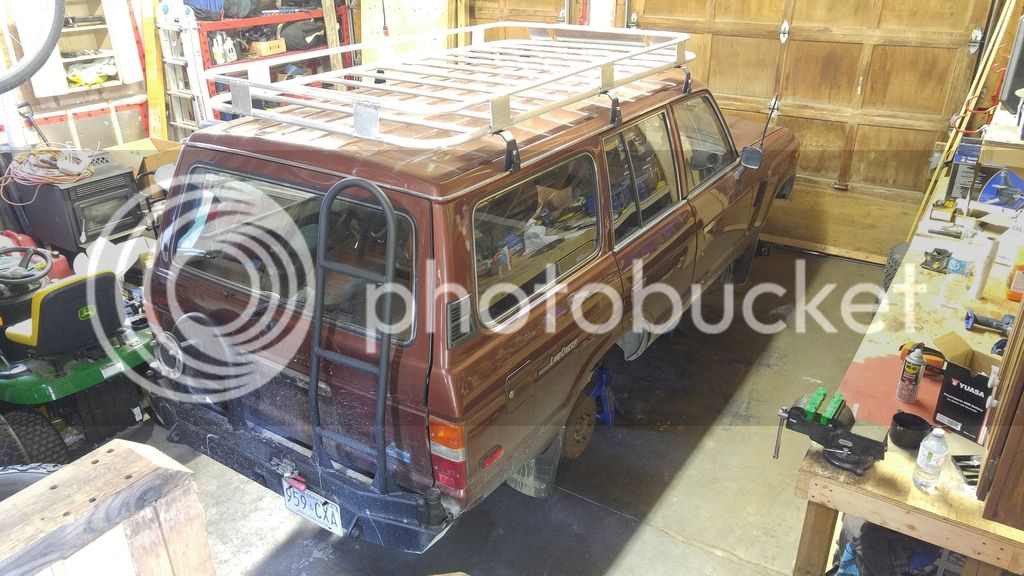

Picked up a fantastic package today.
Are those the new BFG ATs? Curious to see if they start cracking out in the center like the rest of late.... I hope this was just a build date issue that they have figured out and corrected.
I will be going with Cooper's because of this issue.....

Thanks for that info J, I did some research just now and I can't seem to find if all tires are affected or just a certain size or production date.
I dont know if that cracking would cause any serious issues, but it sure does lower your confidence in the tire, you dont want those tires failing on the highway
They were the only tire offered in 33 10.5 r15 where i am. I will keep a sharp eye on them

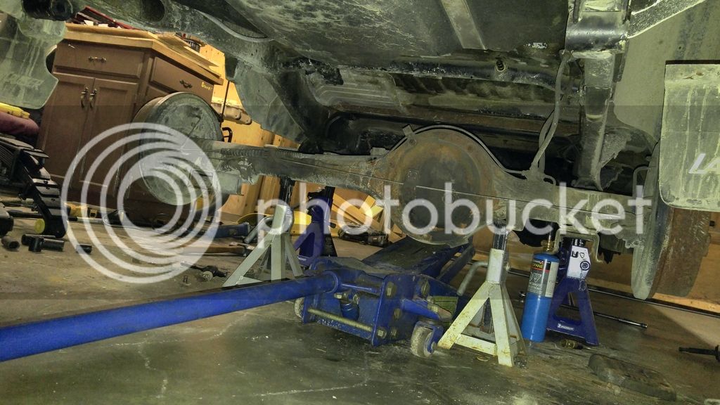

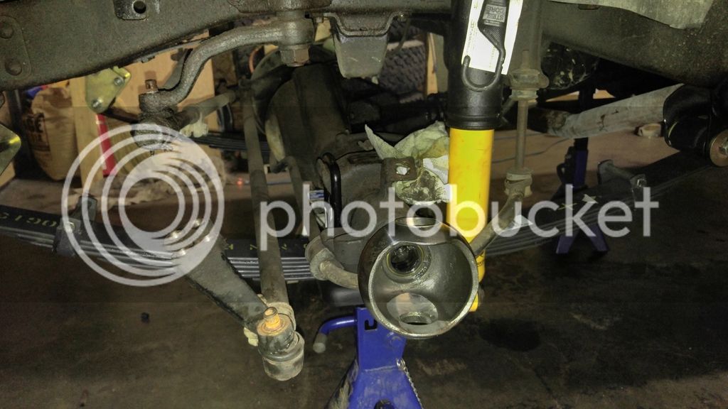

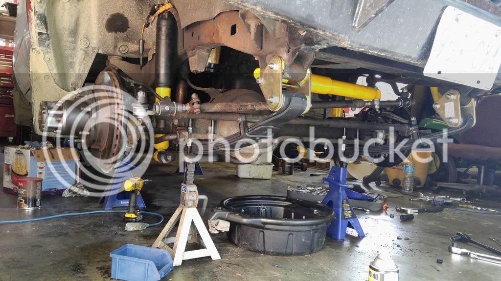

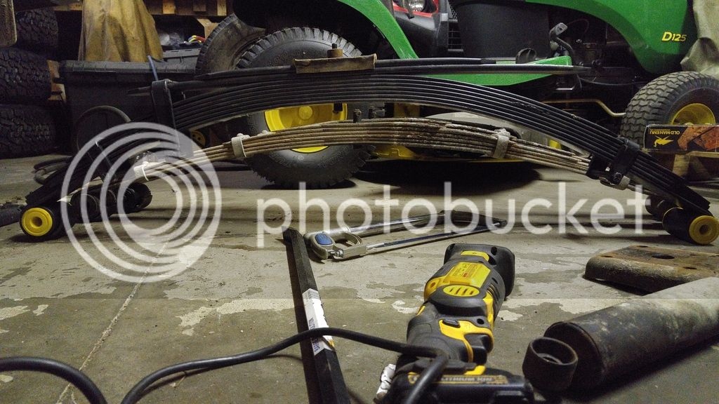

Got the truck on jack stands for the suspension swap.
Got the rears out last night, the one pin was seriously stuck, I ended up grinding it out.

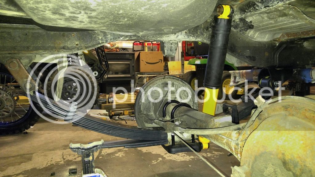

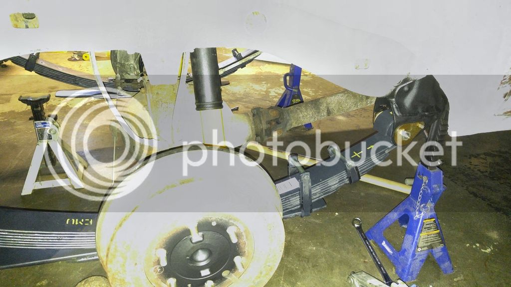

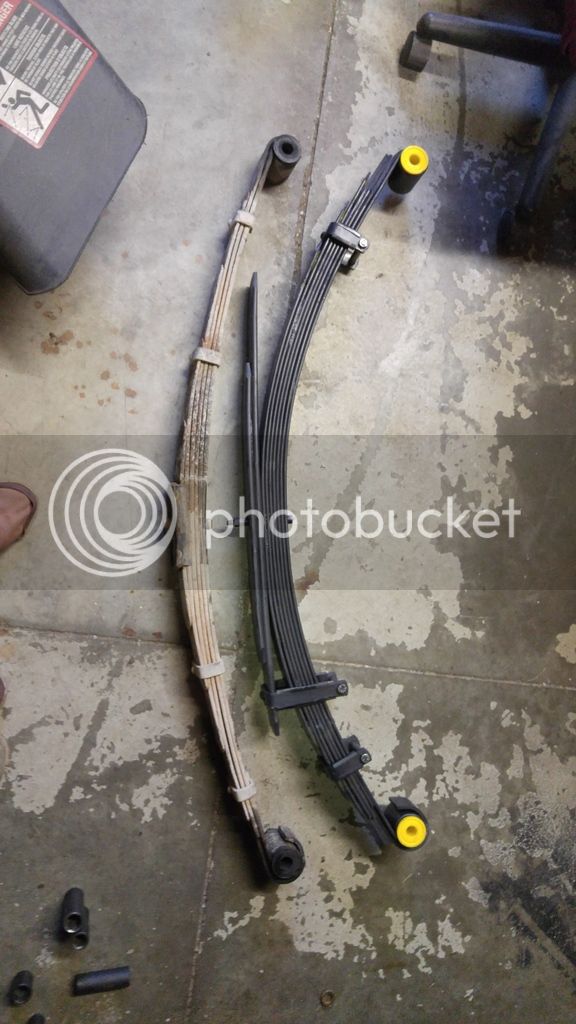

The Ome springs are significantly bigger than the originals, i was kinda shocked by the size difference
Unfortunately my one shackle kit is missing pieces, the closest parts place is 2 hours away, and it's going to be 1-2 weeks to order it in from California.
That's going to lay up the truck for longer than expected.
I'm debating s***ty rigging a shackle out of the old leaf spring

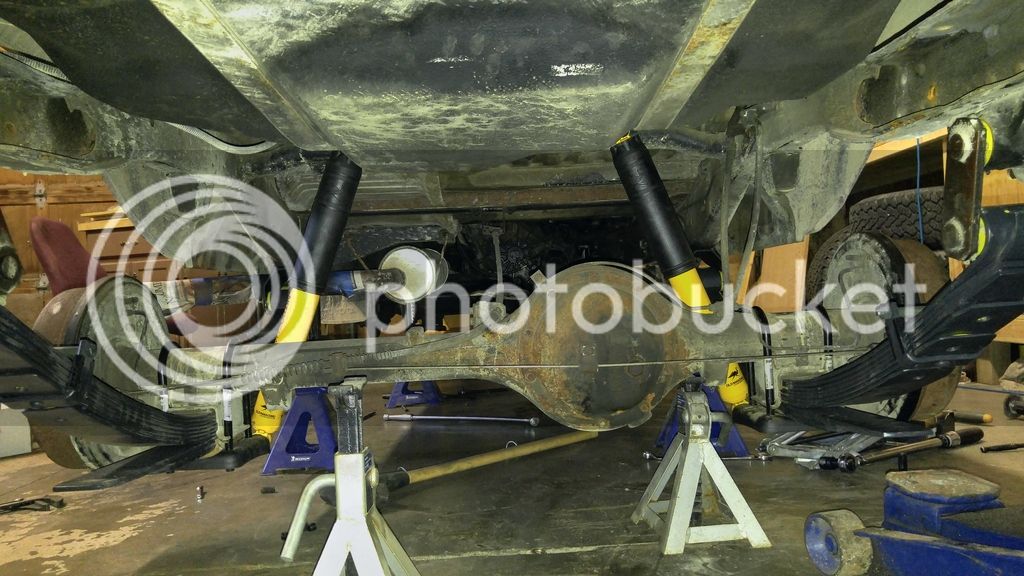

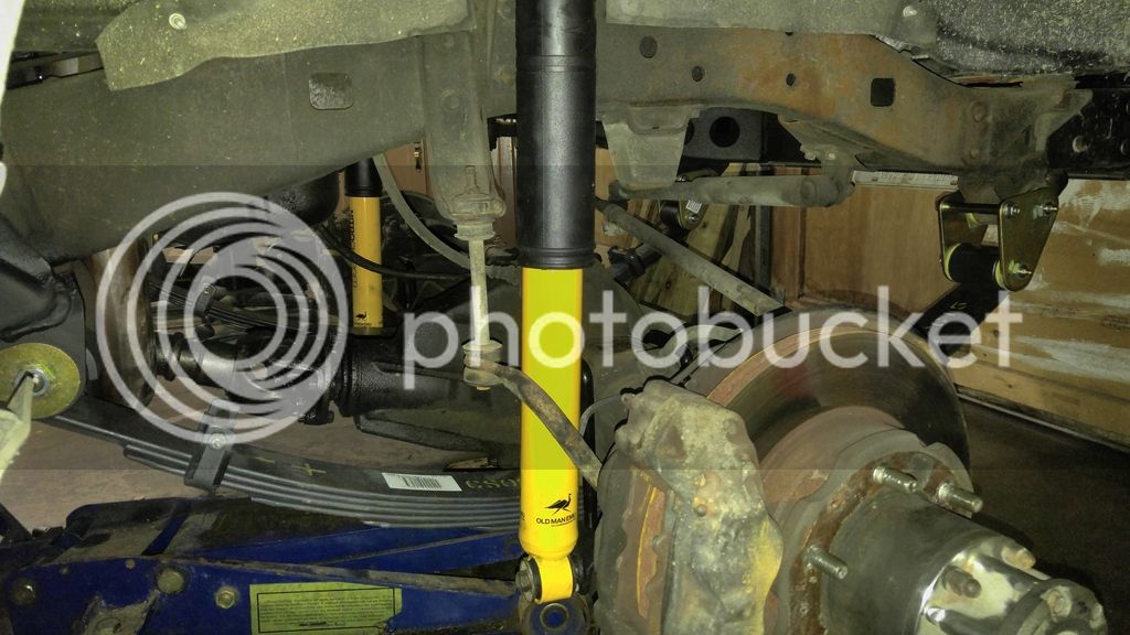

Okay, so I reused my old shackles while I wait for some pieces in the mail. It took significantly longer to install the rear springs than I figured. For some reason I couldn't get the passenger spring to line up with the axle.
It's a little concerning how tight the flexible brake line is with the springs at full extension.
How important are the rubber isolators that surround the springs? I measured poorly and cut my u bolts too short, so I removed the bottom rubber isolator. Is this going to give me any issue's. Is it worth buying new u bolts to have that isolator?

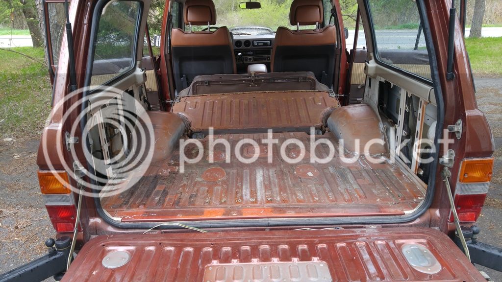

Here's my obligatory pictures of the rears done... ish
Lots of people remove the original factory rubber spring isolators. So it's not a big deal. I've left mine on
only because they are still mint but I wouldn't lose sleep over them missing.
I took a photo of my 5 yrs old OME med and new OME med springs and there was a 1" difference. Doesn't take
long for them to settle.
What is your source for the OME inversion shackles? Seems like too long to get them shipped in, unless the cost is
an issue.

Thanks for the info on the isolators. I was a bit worried. I live in ontario canada. Getting parts is a royal pain, it takes a long time and they are 2 times as expensive, It had to try 3 different suppliers of FJ60 suspension before I stumbled across a place sorta local. Truck Parts & Jeep Parts - Lift Kits, Winches, Tonneau Covers, Tires, Wheels, Bumpers, Performance – 4 Wheel Parts
I can't even get them shipped quicker because it's a warranty thing, it has to go through their system

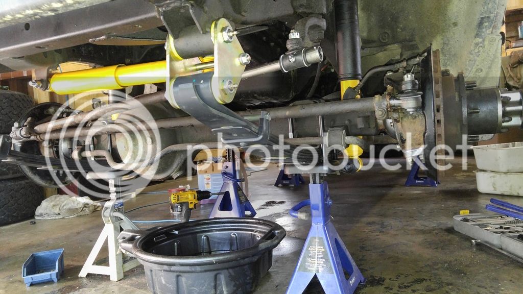

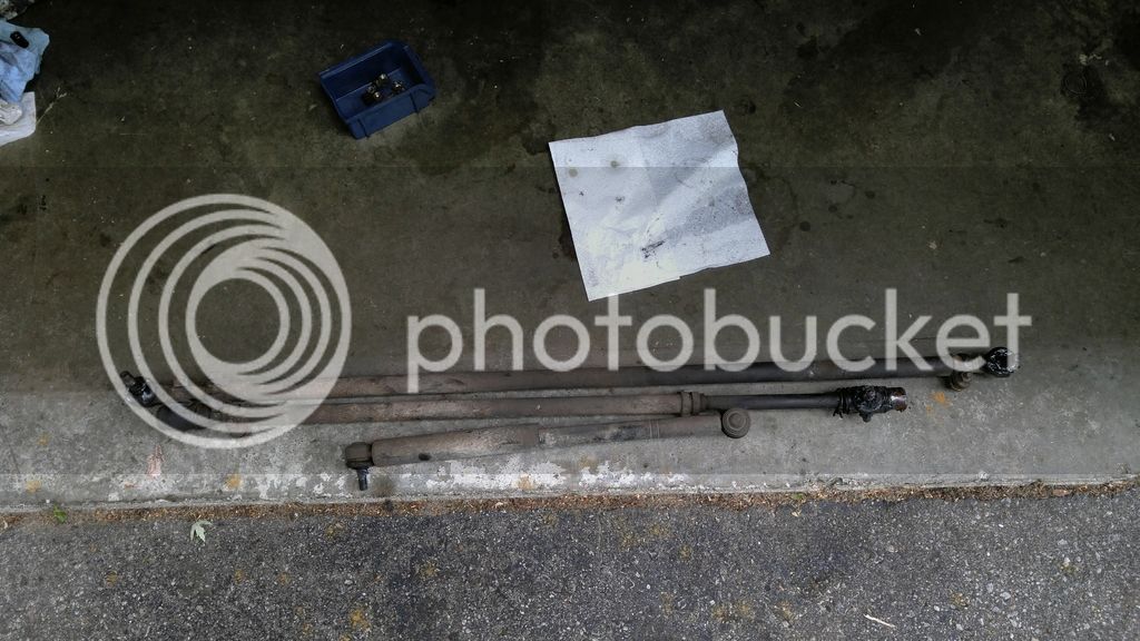

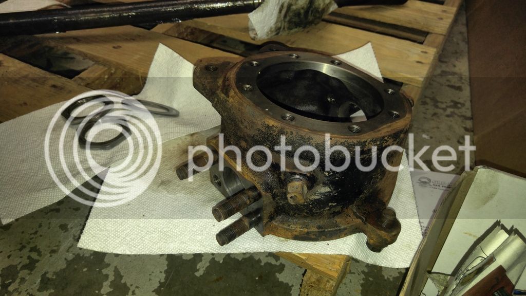

Made some more progress the last few nights. I have finished the suspension and moved onto rebuilding the front knuckles.
I can't wait to see how it looks on it's wheels.

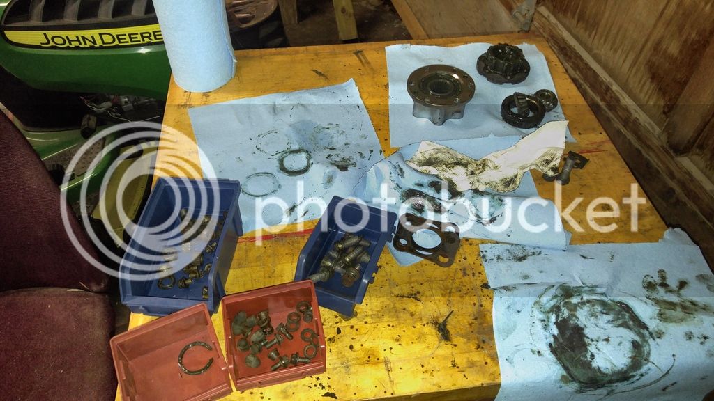

The knuckle rebuild is going quite well. Fairly straight forward, just messy. I got one side taken apart and almost clean.
I finished up the knuckle rebuild and finished replacing all the tie rods. I have a universal on the steering shaft that has a bit of play. Once all that is done it should ride like a dream.

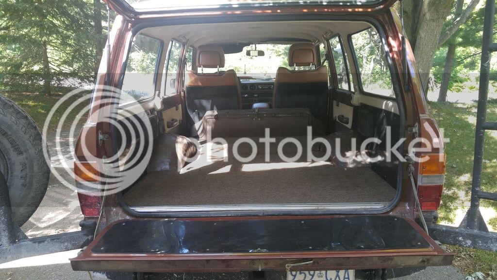

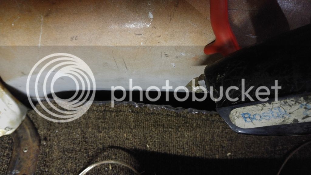

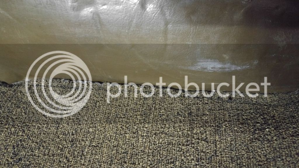

Then I burned it pretty late finalizing the cargo area. I bought a cheap piece of carpet to throw back there until I replace all the carpets.
The only problem with cheap carpet is that the ends aren't bound and it will unravel and fall apart. A really cheap fix is to use hot glue on the ends to bind it. Works perfectly, just looks a little bad.

Good work so far. No biggie on missing the spring isolators. I took mine out when I installed my OME suspension back in '07.
To note on those brake lines: The stock lines are not long enough if you ever droop that tire closest to the brake line. I would replace the frame to axle lines on front and rear with extended lines. Keep rubber or go SS. You should be able to source something in your area.
I noticed the rear brake line issue, I had the spring at full extension and the line was as tight as a banjo string.
My front flex lines have a tiny bit of cracking. So this winter I am going to replace all the lines with ss
Right now the drivers side suspension is pretty level, but the rear passenger spring is about 1" taller than the driver side. I hope it will settle out.
The truck drives amazingly smooth with the new springs and new rubber, it's nice not smashing off the bumpstops all the time.
