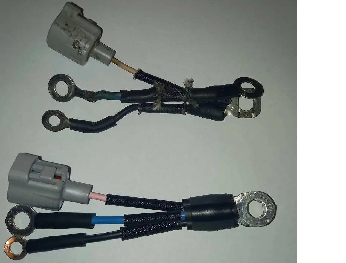

Also my new fusible link came in today, compare the dirty (and partially burnt out) 27 year old link and the new one. I guess this explains why there was some discrepancy in the described colours. :) Note the main wire was even dirtier and darker before I gave it a clean with some degreaser.

I think you got your moneys worth out of that link. Good job on finding the problem.

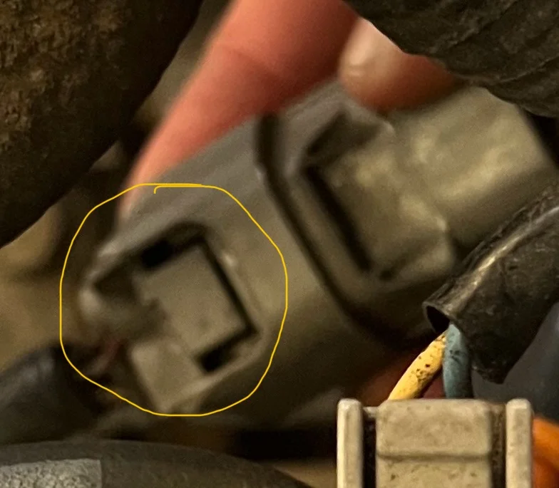

Tried to separate the PB1 connector, no dice. Pretty sure if I push or pull too hard in the wrong direction, the 30 year old plastic won’t survive. Anyone know how this tab releases?
Look at your spare to see how it releases 😜
