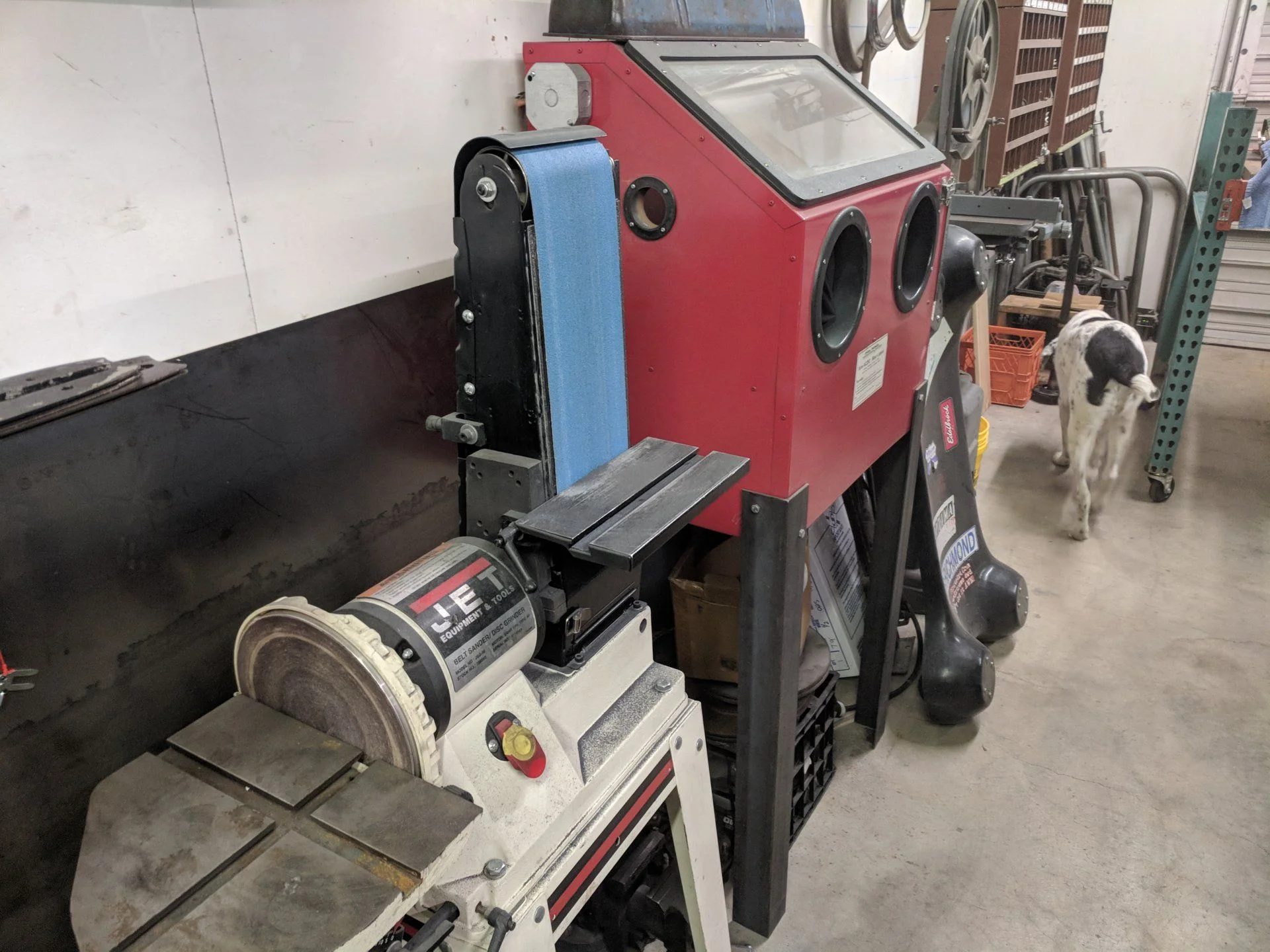

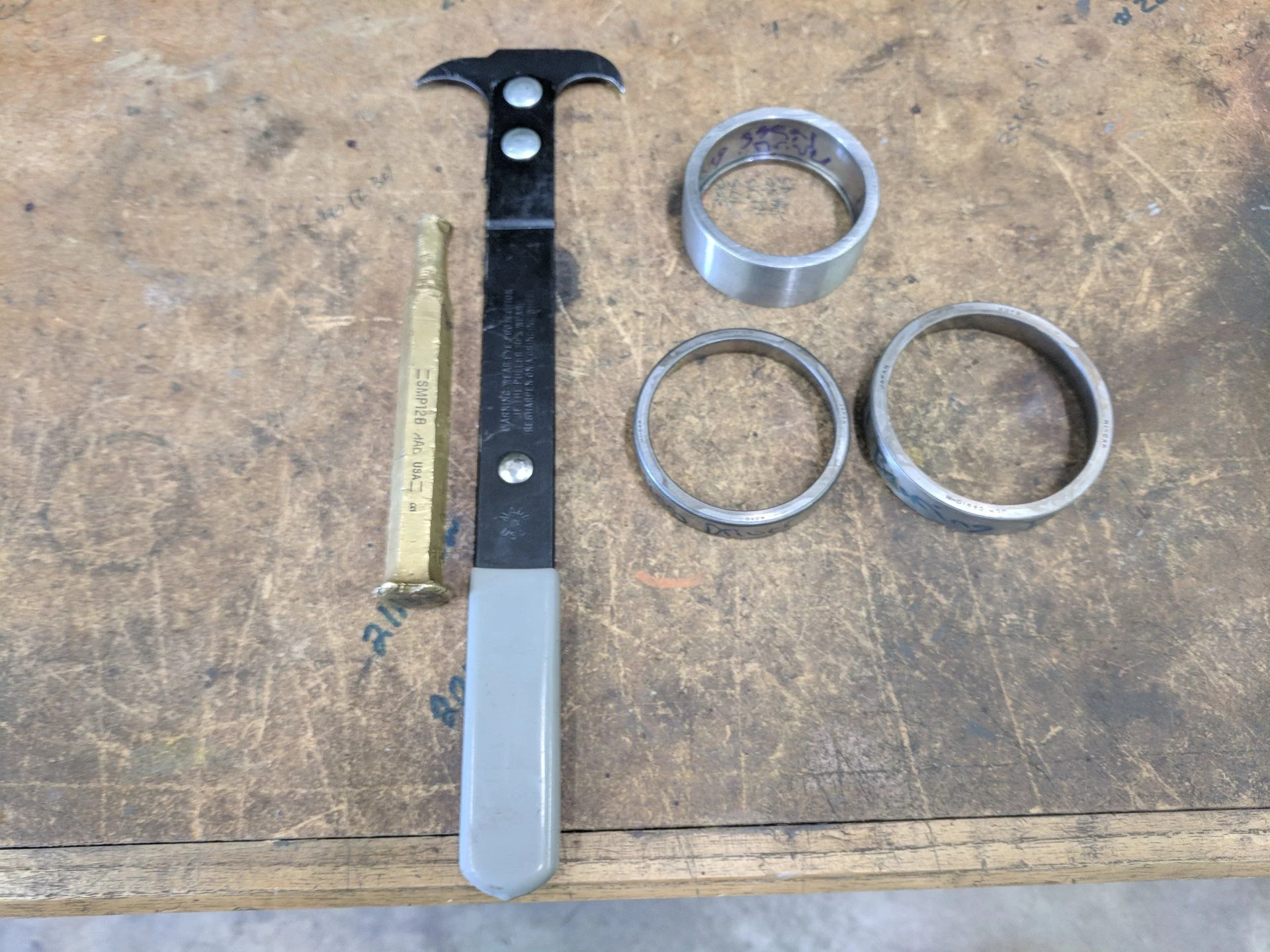

Use your used bearing races as seal and bearings drivers. All you need to do is sand or machine the old ones down just enough to not be a pressed fit anymore. The rest you can get at vato zone.
