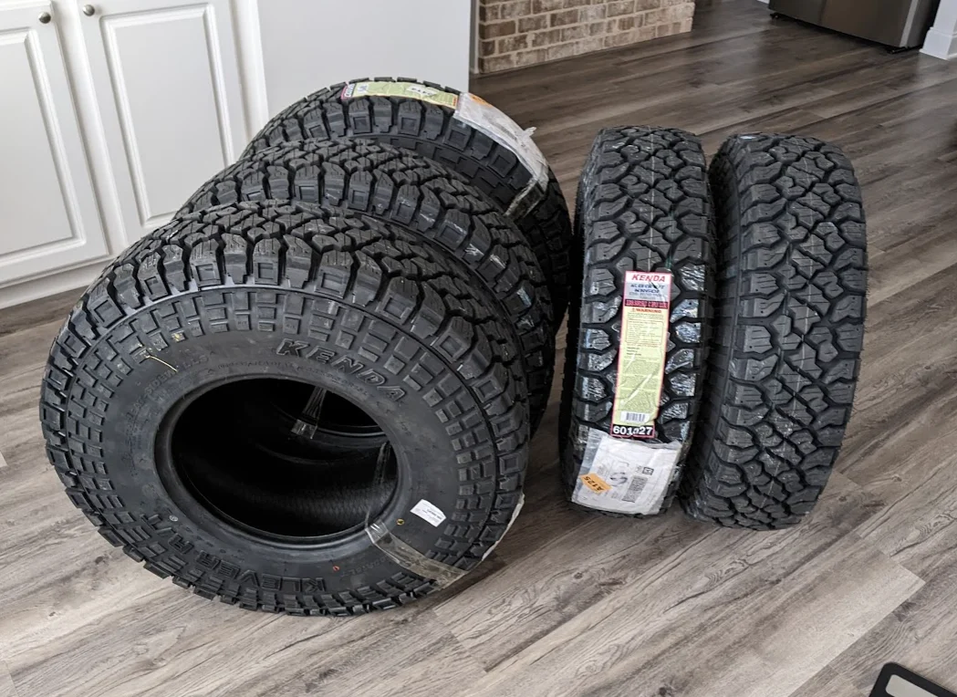

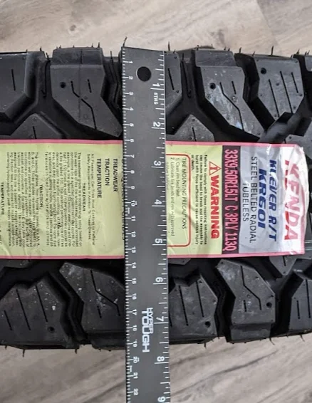

I got a set of 5 delivered today. Initial impressions are they look great and are skinny. Unmounted measurements are
32 1/8" tall (1/2" crown)
8.5" section width
7.5" tread width
50.5lbs each
I'll get some more measurements after I mount them on stock 62 chrome wheels. If you want anything else measured let me know.

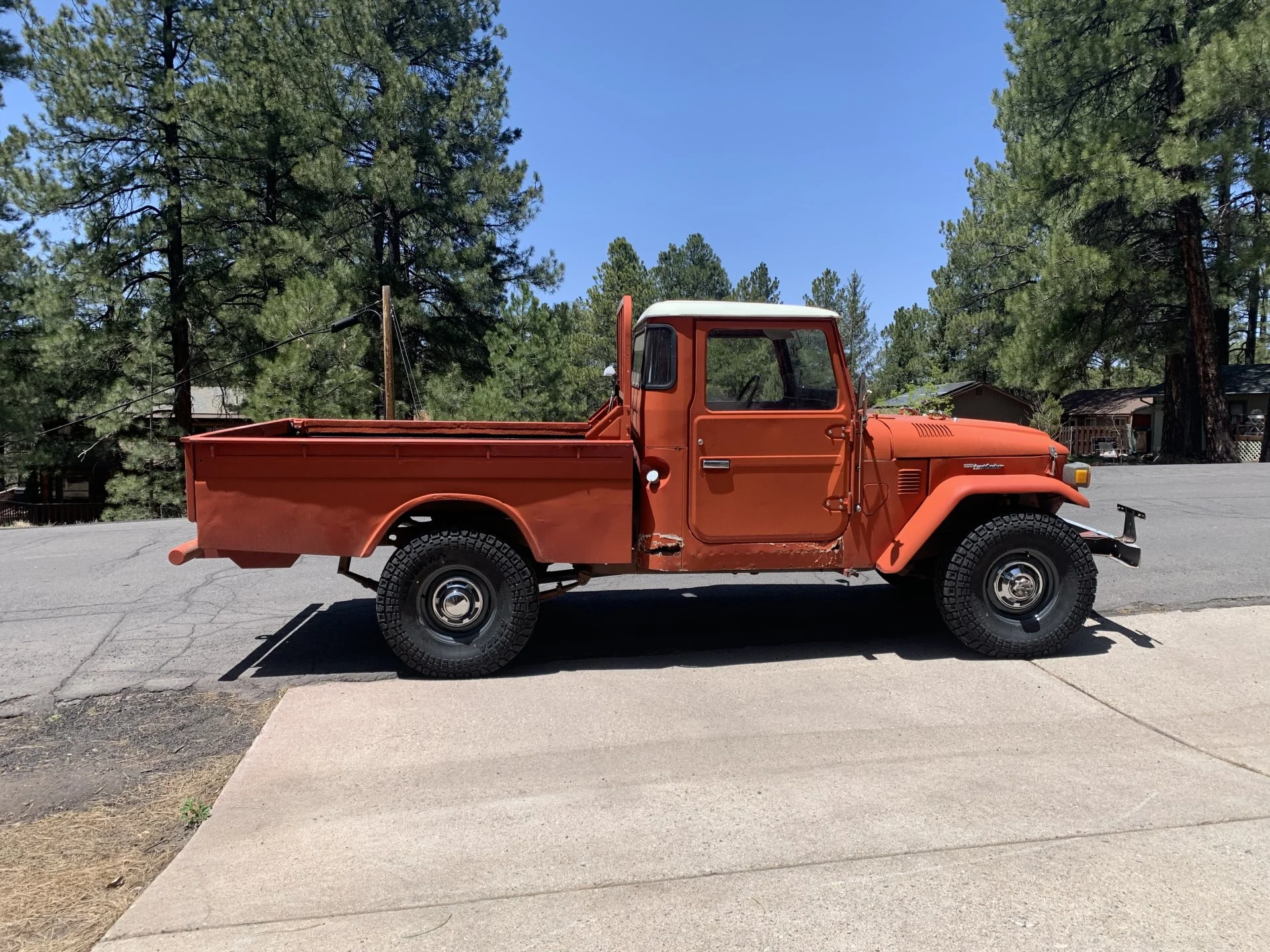

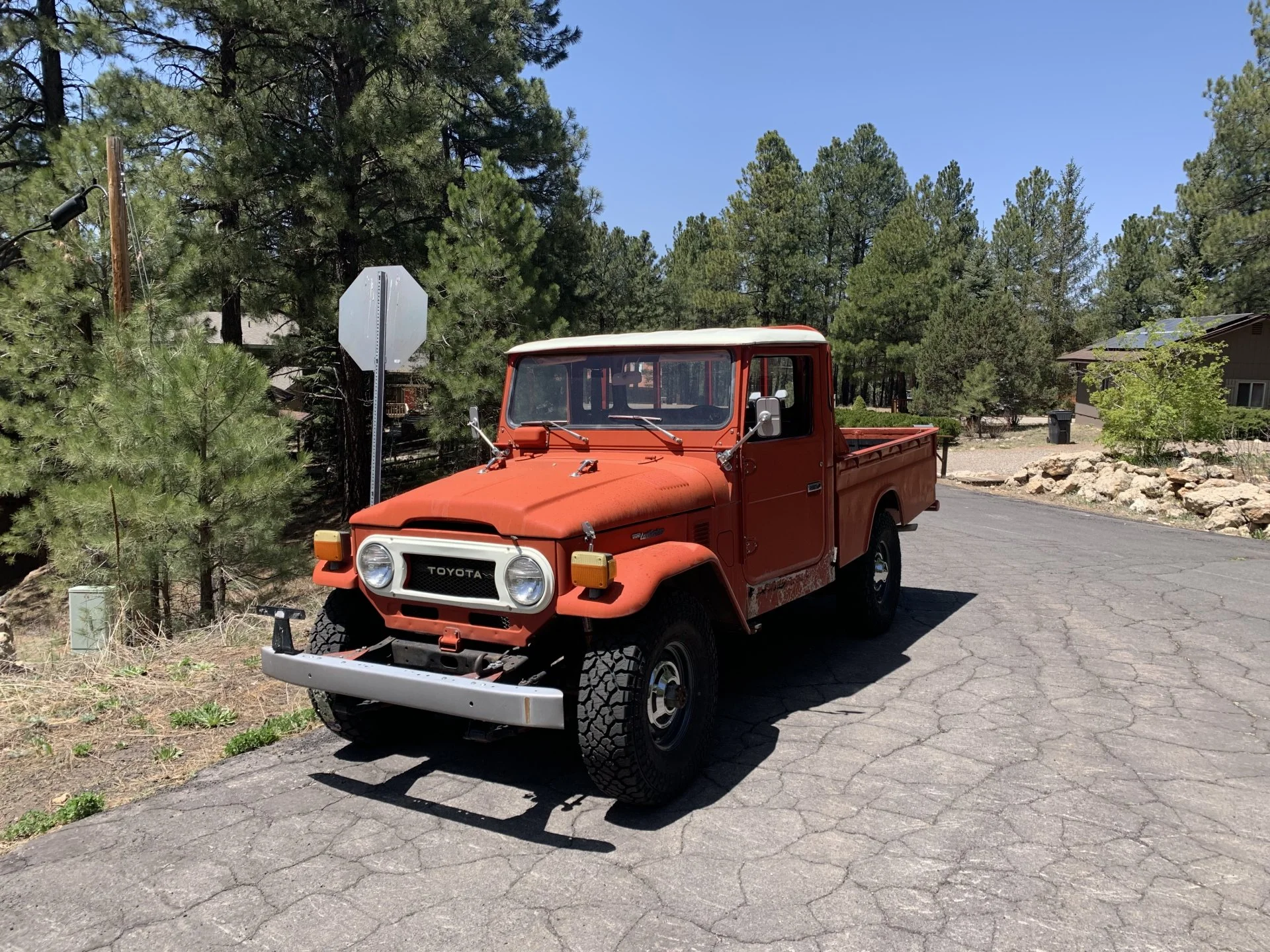

Mine came in last week, got the wheels painted, hub caps cleaned up and tires mounted, then put them on the truck today. They came out exactly perfect, 31.3 at 30psi in the front. Truck drives and looks much better

Glad someone scored off of that deal. I was pretty surprised as how deep the tread is on these as well, I’d buy them again from what I can see so far.

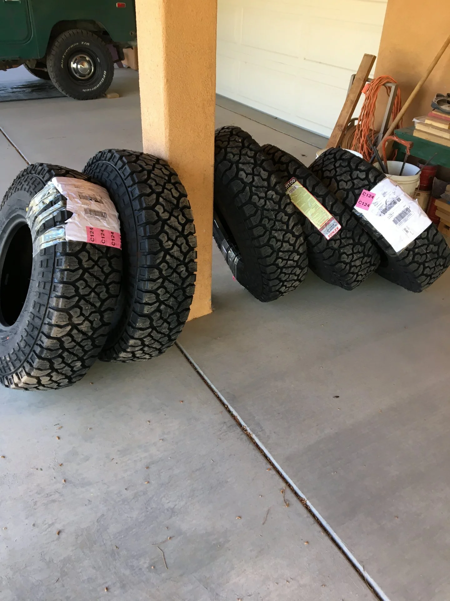

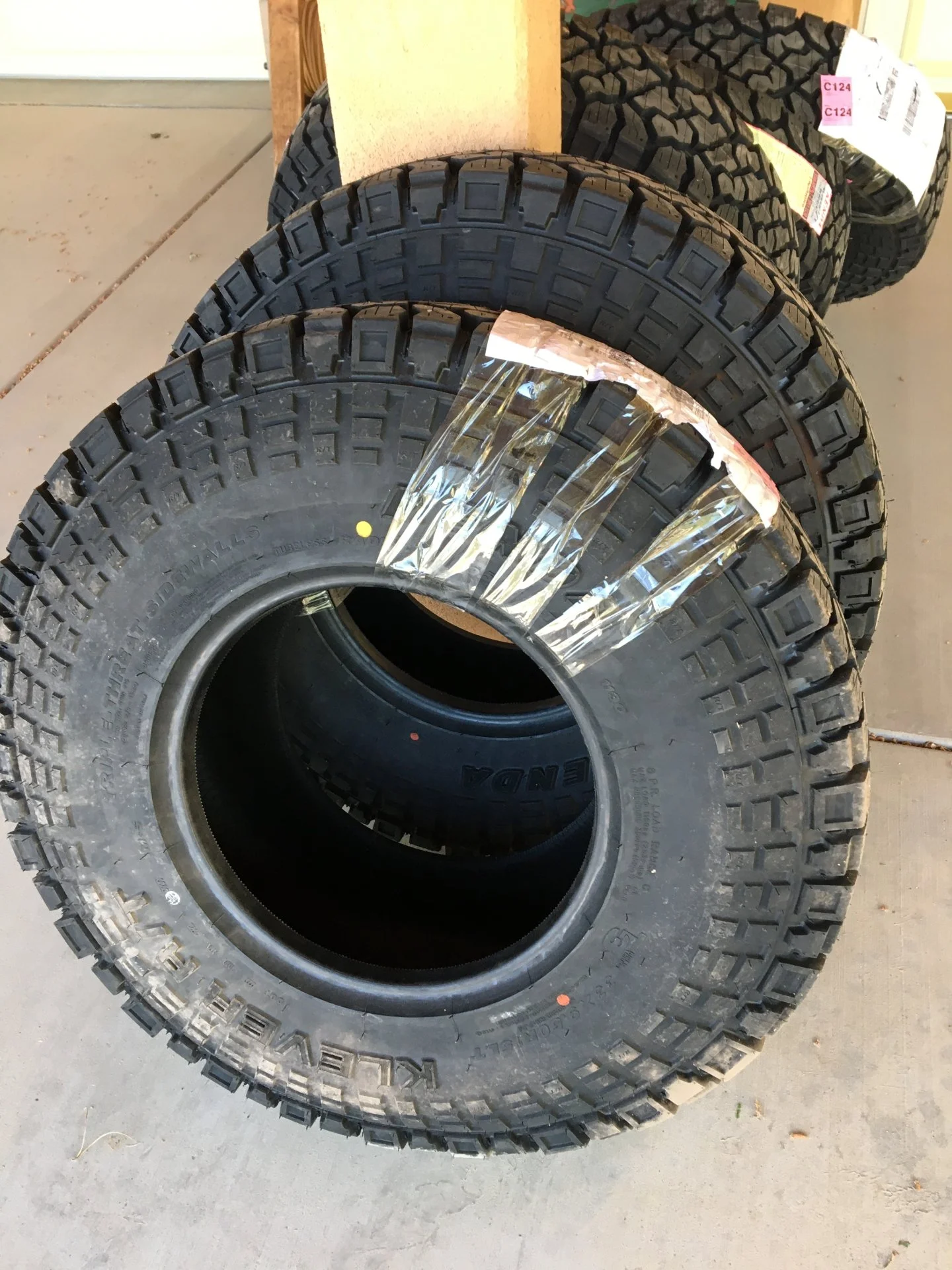

Something was left on my carport an hour ago:
4 days early!
