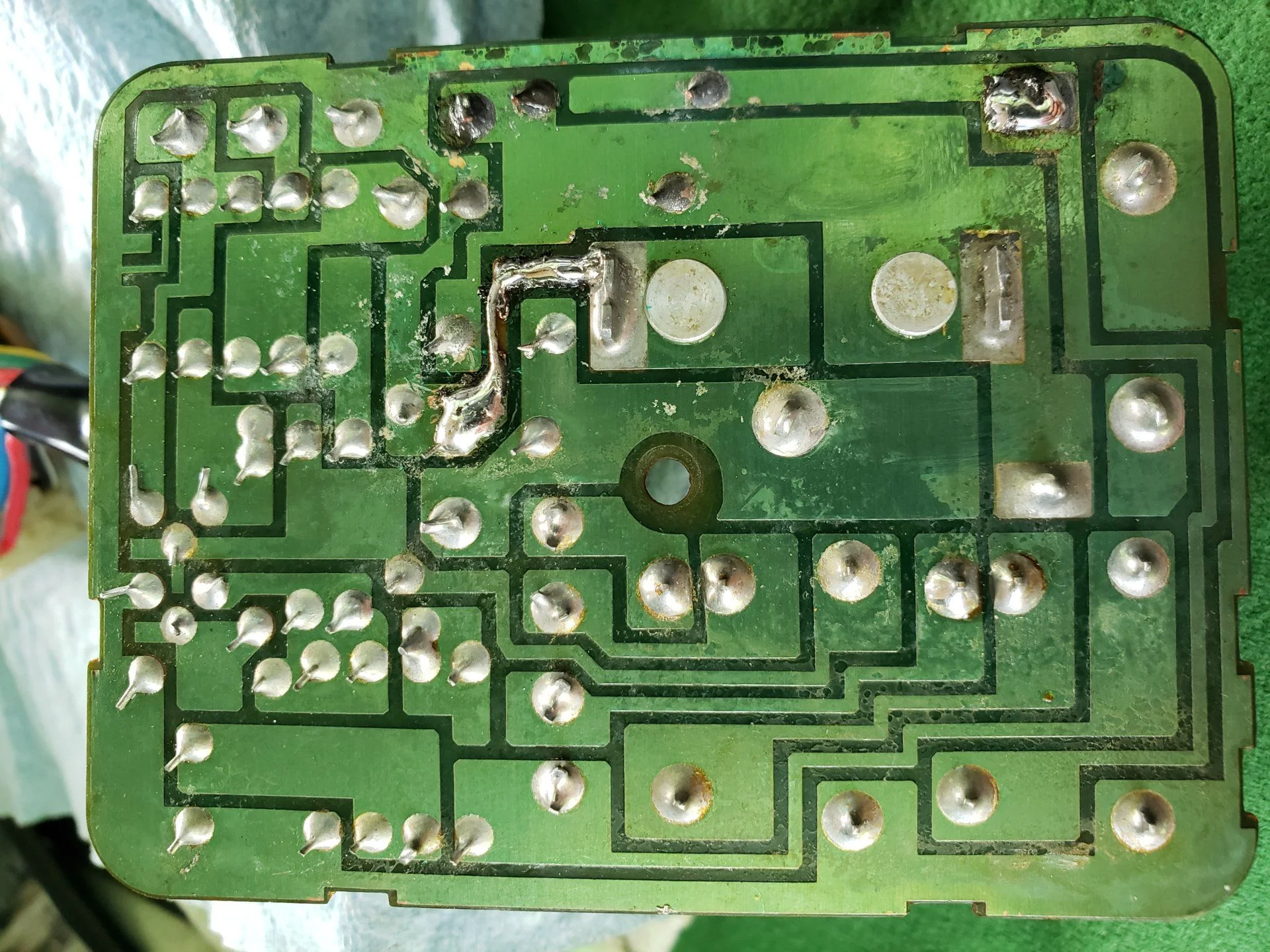

After cleaning and tinkering I bought a Manual Push Pull Tractor Cable which luckily is still sitting on the PS floor because I wanted to stop the engine from inside. Now luckily for me as I am traveling I came across an old fashioned TV repair guy who soldered my hunch issue and hallelujah my FCR is back in business!
Best part was he refused payment, did give him coffee money.
