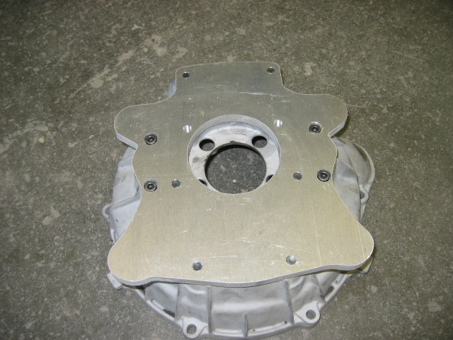

I emailed 4x4 labs last week about the mb conversion and got an email response.
They said they just got an adapter plate and were working on it.
That I would hear back from them in a month.
That is all the detail they provided....
That is good you got a response. I'm sure I will get one in awhile. Well if they have an adaptor plate that is one step (biggest one I think) In the right direction. I would hate to hold my breath and can always work on my other project but before I put money into this gas engine anymore I wouldn't mind doing the swap first.

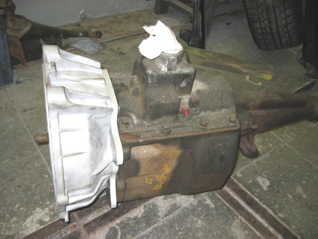

Read thru the Toyota runner swap. He used the Automatic so that is cheating. I still want a 4x4 machine just with a familiar diesel I can trust on the trail. Still trying to figure this whole 2 bellhousing thing. Guessing it is the Mercedes Bellhousing mated to the Toyota Bellhousing but with the right distance between in order for input shafts to mate correctly. Also of course using both flex/flywheel plates. It makes sense and shounds eay but how easy is it really?
