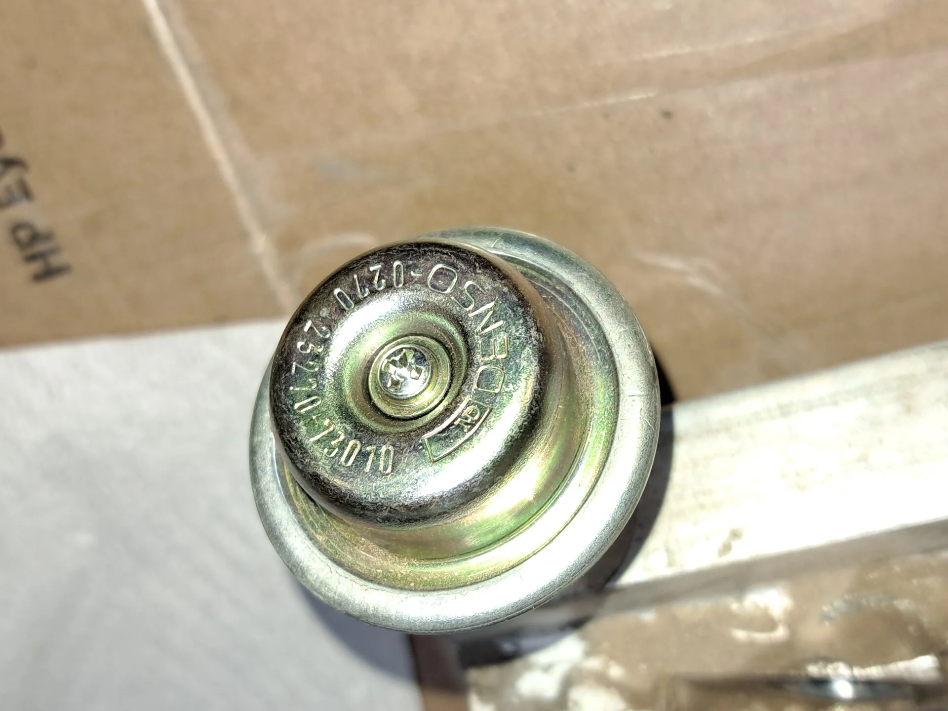

I found the dumper with the completely unscrewed screw held by the plastic cover.
is it possible to put it back?
“Damper” 😉
Never tried taking one apart. But that might just be a cover for the spring.

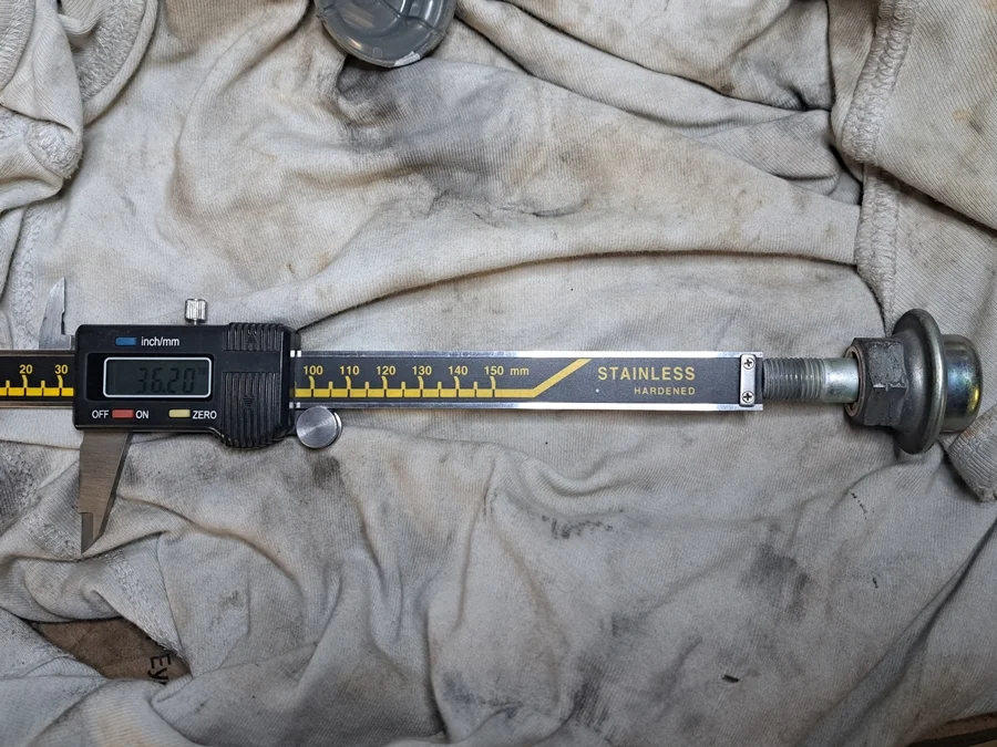

could someone please measure the depth of the membrane?
I want to adjust the screw
Thank you
I remember reading somewhere that the screw is supposed to sit flush when there's no pressure in the fuel rail, and slightly raised when there is pressure, making for a quick and easy way to check if there's fuel pressure in the system. So if you have the FPD out, I would just turn the screw in until it's flush, and then maybe a smidge more? Maybe with some locktite to keep it in place?
Or, just replace the whole unit. They're not expensive. :meh:
