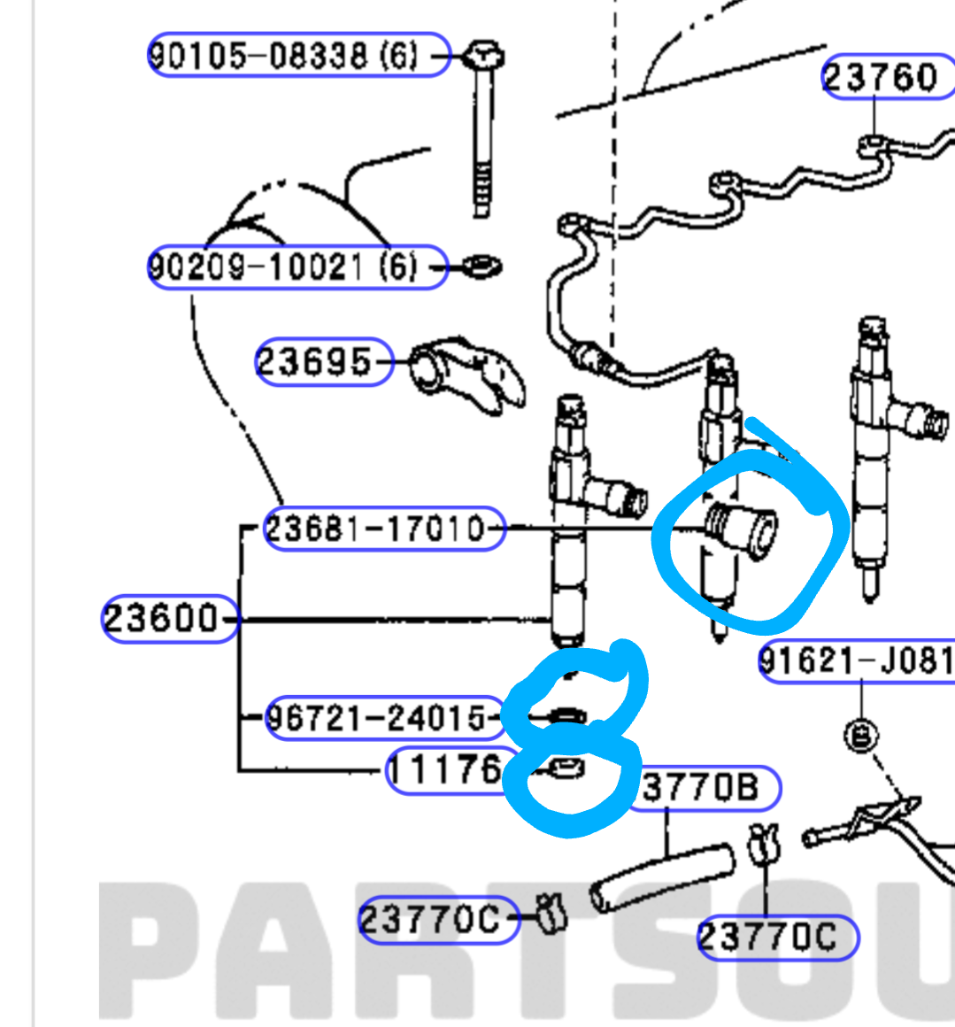

Has anyone ever seen the isolator (96721-24015) split after being replaced? Replaced all three pieces with OEM when I rebuilt the engine about 2 years ago and I just noticed most of mine were cracked and split. Not sure if it was a fluke or what.
I wonder if they had been sitting on a shelf for a long time before you bought them?

If you have the intake off. I would at least pull them and replace the three rubber bits on them. Could send yours out to be cleaned if you want. I did that when I pulled mine.
Unfortunately, I need to pull mine again since the insulator failed again within 2 years. Pretty sure the part I put on was an OEM rubber bits, but it’s possible it got mixed up with a non-OEM.
