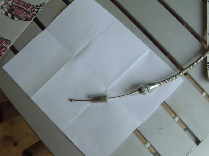

I think I found an "easy" solution...

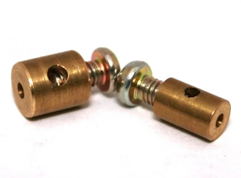

I used a Lokar cable. On the TBI end, I used a screw on cable end from the Help section of Autozone.

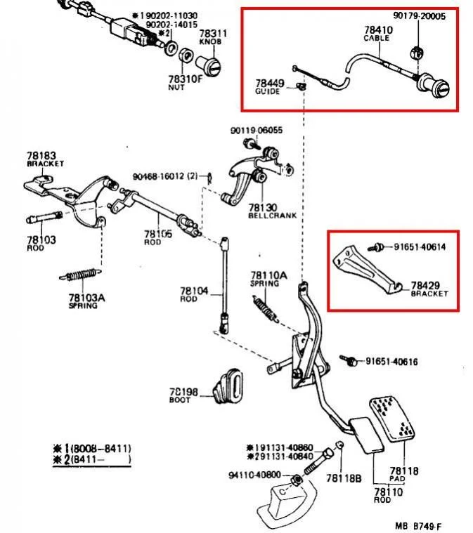

On the pedal end, there is a clip for the hand throttle that snaps into the top arm of the pedal. (I think you can order that separately from Cdan or the like. He pieced together my hand throttle years ago.) "Guide" 78449 in the pic...
If you pull the clevis-thingy off the Lokar cable, there is a ball end that fits perfectly into the hand throttle clip. Or you could leave the clevis on if you wanted.
The hardest part is lining up the hole for the cable as the drill bit walked all over the place on me.
The downside is that you lose the hand throttle.
I think FJ62 pedals have two attachment holes if someone really wanted a hand throttle, though.
