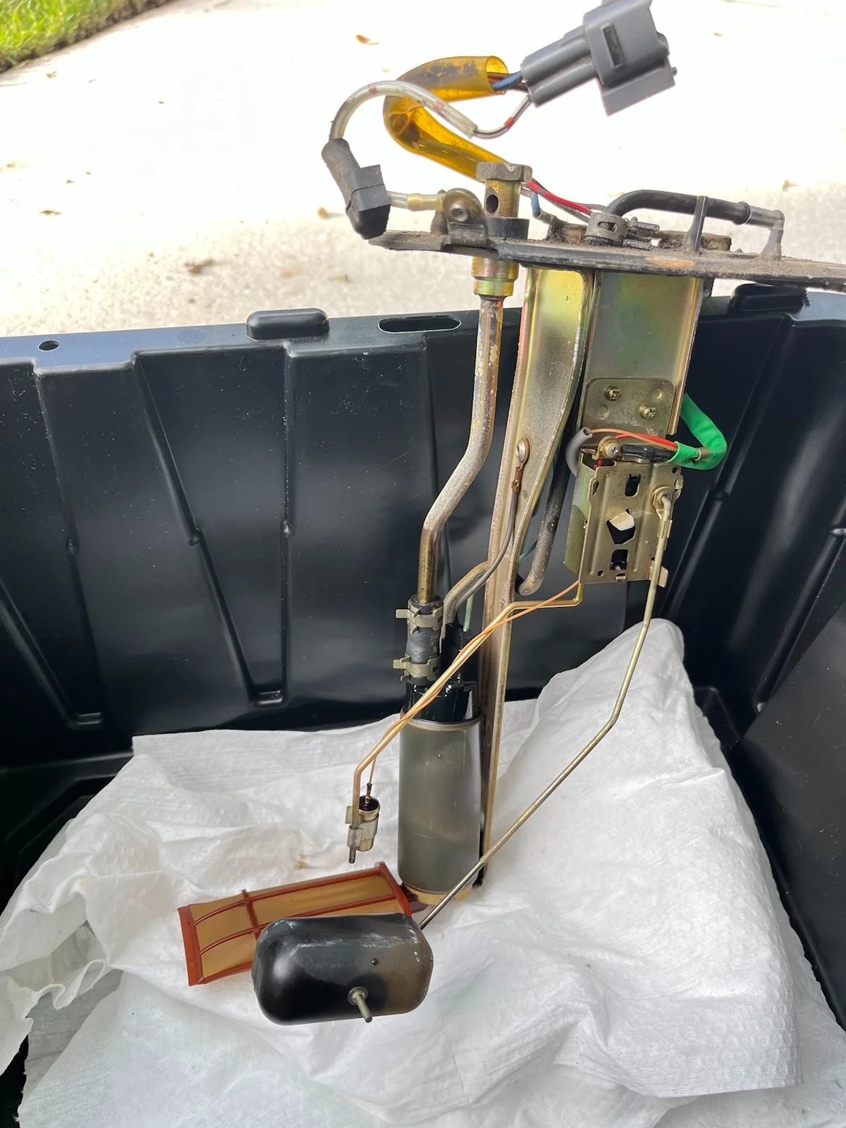

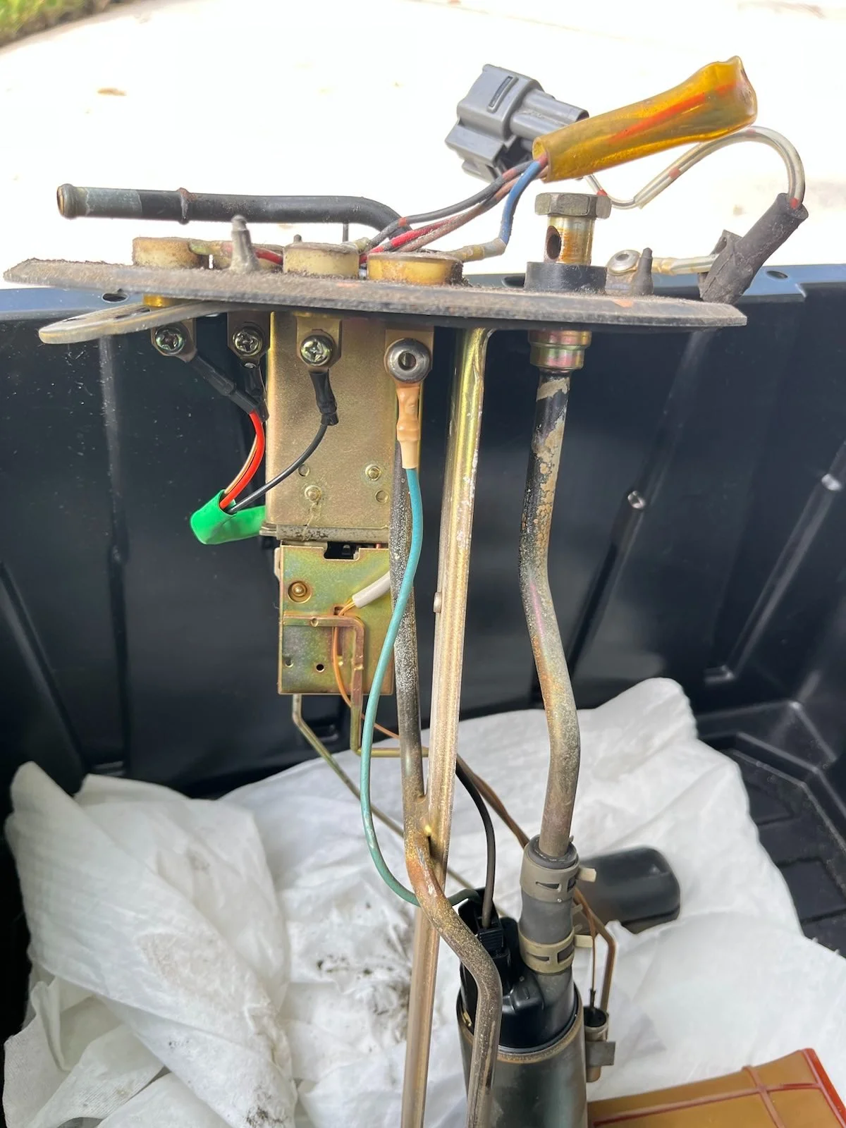

How typical is it for the fuel gauge to be inaccurate on the 80 Series when everything "looks" to be in good condition? Trying to determine if I am chasing results that are not realistic before doing the FSM procedure to test everything.
My gauge often says there is less fuel than I really have. At empty on the gauge, I still have 8.6 gallons left based on my last test. That was a 170 mile range after the last fill up and 16.6 gallons to get the tank back to full.
I have not re-tested to wait for the fuel light to come on, although that worked in the past.
I removed the pump this weekend and everything is surprisingly clean. No rusty or deteriorated rubber. Although, it's possible the pump had slipped out of the rubber cushion at the bottom but it's hard to tell if that happened on removal. The float rotates fine and the wiring looks good.

Slide that little capacitor-looking thing down the rod a little and the light won't come on as quickly. Slide it up and will come on sooner.
You can do the same on the fuel level by bending the float rod. Maybe when someone was in there before, they bent it and messed it up......

Ah, I didn’t think about the rod being bent. I might have to actually test the resistance at the various levels to get this right.
