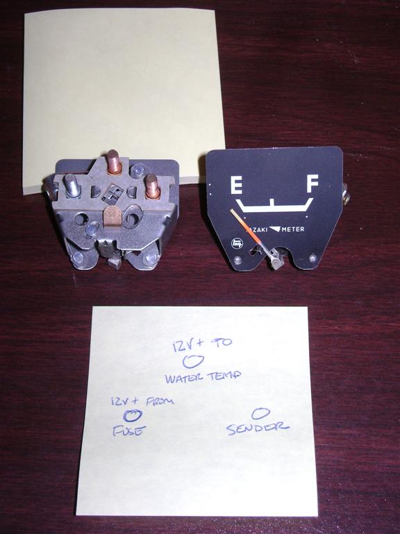

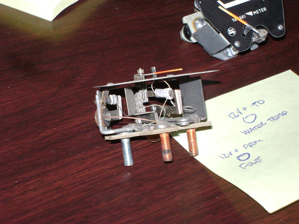

UPDATE: - I was able to get the problem to duplicate, so I was able to pull out my multimeter and get some readouts. To my suprise my Water Temp guage is powered THROUGH the fuel sender, not off of the same fuse (such as the Oil Press.), rather the Temp guage gets its 12V power through a 3rd post on the fuel guage. I'm still trying to figure out exactly how/why it all works... the leg of the fuel guage that sends its power to the Water Temp has a "switch" of sorts that is adjustable by a very small screw on the side of the fuel gauge. When this "switch" is closed, it allows the 12V to travel through the 3rd post and into the Water Temp. Also, when closed, it allows the 12V to enter the "coil" that makes the fuel guage work. Easy enough to bypass the "switch" and run the 3rd post directly from the 12V fused source, and this in turn will power the Water Temp guage always. What is the purpose of this switch???. I'm 99.9% sure this is OEM, I've got a couple of guages this way, and 2 complete instrument clusters that are all wired completely the same in this fashion. I beleive they only used this from late 72' - mid 73', possilbly less than a 6 months? I don't have an FSM for either a 72' or a 73', so I havn't been able to see if the FSM covers the "switch" or not. Anyone have one they could check?

Here you can see the 3 posts, viewing from the back, the left is the 12V from fuse, the right is the from the sender, the top middle (what I call 3rd post) is the post that eventually powers the Water Temp Guage, but only when the "switch" is closed.
Close up of the fuel guage, as you can see, there is a small set of contacts, adjustable by a screw that will divert power to the top-middle post, as well as the fuel guage coil itself. Why?

However; manual 98154 gives some clues to the way this water gauge and fuel gauge are coupled inside the combination meter.
Page 12-26 show the interconnect of the two gauges, but not the internal switch u have found. There is a voltage regulator common to both gauges (2-7 volts); i.e., these two gauges want to see 2 to 7 volts (not 12 volt battery). Perhaps the third terminal is for this purpose. For example, when u turn the ignition "on", 12v is applied to the voltage regulator (inside the fuel gauge); as the fuel gauge coil begins to activate, it trips the 'switch' applying 2-7 volts to the "water temp gauge".
This may be used (the switch) as a de-load system. In other words, get the fuel gauge moving first, then kick in the temp gauge. When it kicks in is determined by the set screw.
Or, the third terminal was used as a calibration point for factory use.

That is the most reasonable thing I've heard thusfar. Though I don't think the switch I have would act as the resistor itself, rather as the voltage regulator proper, if it gets more than a certain voltage, I can see how it would drop power to both guages (via no power to the top-middle post).
...Or, the third terminal was used as a calibration point for factory use.
I don't think that is the case, seems the voltage regulator theory is the best yet :D
I don't see why these gauges would need regulated power other than the chassis power that is already regulated. If there is a regulator, it isn't indicated in any of the schematics.
From what you can see in the picture, I can't see how this "switch" device would function as a VR. It seems more likely to be some way of adjusting the full scale swing of the meter.
What side of the "switch" is the center post connected to? Can't really see this well in the pictures.
