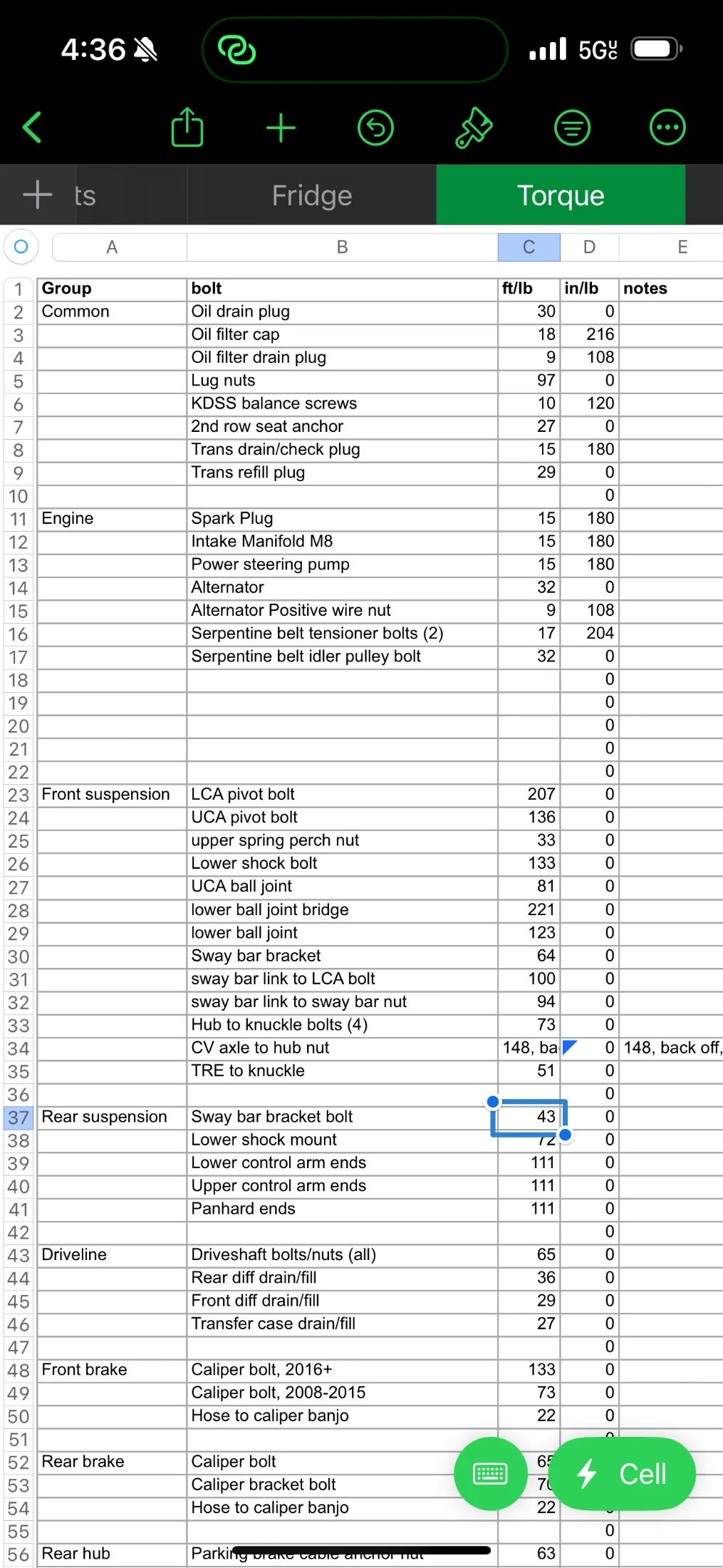

You guys should consider adding torque specs to your cloud-based maintenance spreadsheet. When set up to save for offline viewing all these numbers (including the calculation for when to use the smaller in-lb tool) are available anywhere I have my phone. Or computer if I am already sitting at it.

Either you shared this on here before or someone else shared theirs because I have a sheet that looks just like this on my Cruiser excel spreadsheet. If it’s not yours it’s another mudder… at this point I probably have gleaned something from every mudder in the 200 section and owe beers well into bankruptcy at this point.

Yeah I started a thread about people's maintenance spreadsheets, partly to collect other people's ideas and see if they could improve my system.
The torque sheet is particularly useful though. I've definitely spent time digging around in the FSM looking for a specific value, but having the common ones a couple clicks away on my mobile or desktop device has saved me a ton of research time by now.

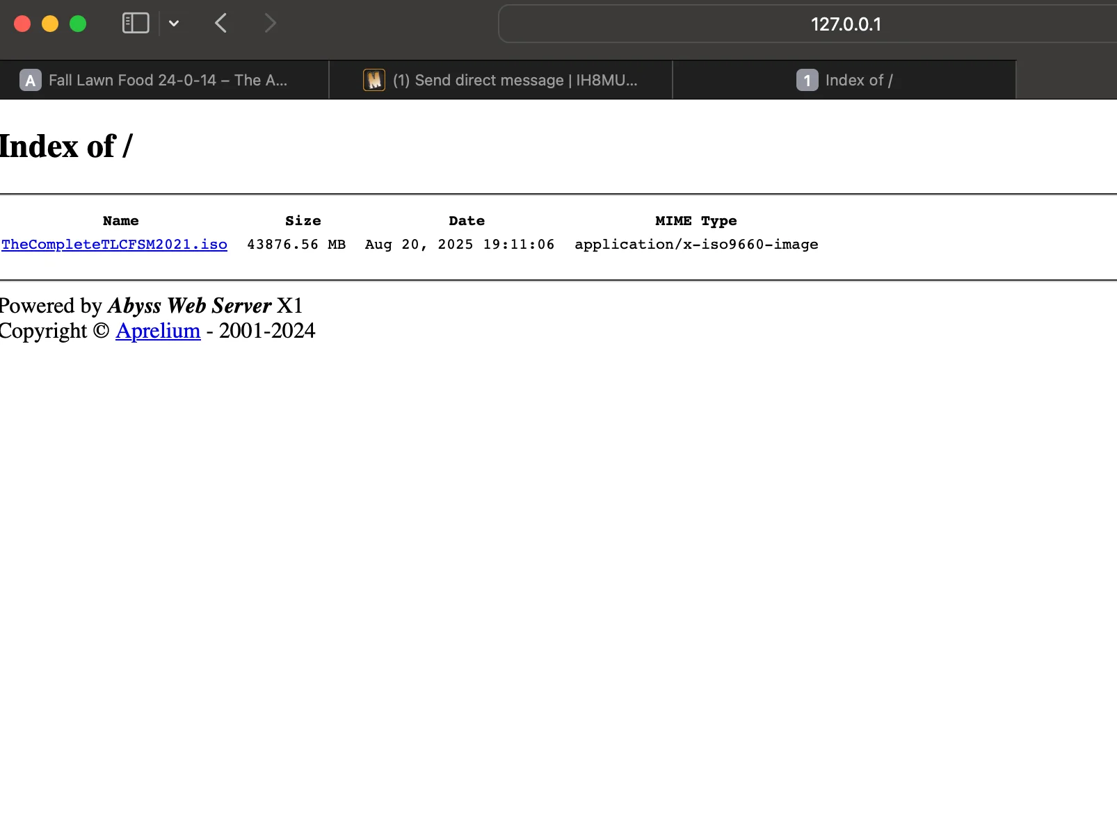

This is as far as I got -- I followed the instructions and once I click the link nothing opens up.
You need to mount the ISO (if it’s windows open up Explorer, right click, and mount). The ISO is its own file system and you want the “root” of Abyss to point to whatever drive letter the ISO mounts as

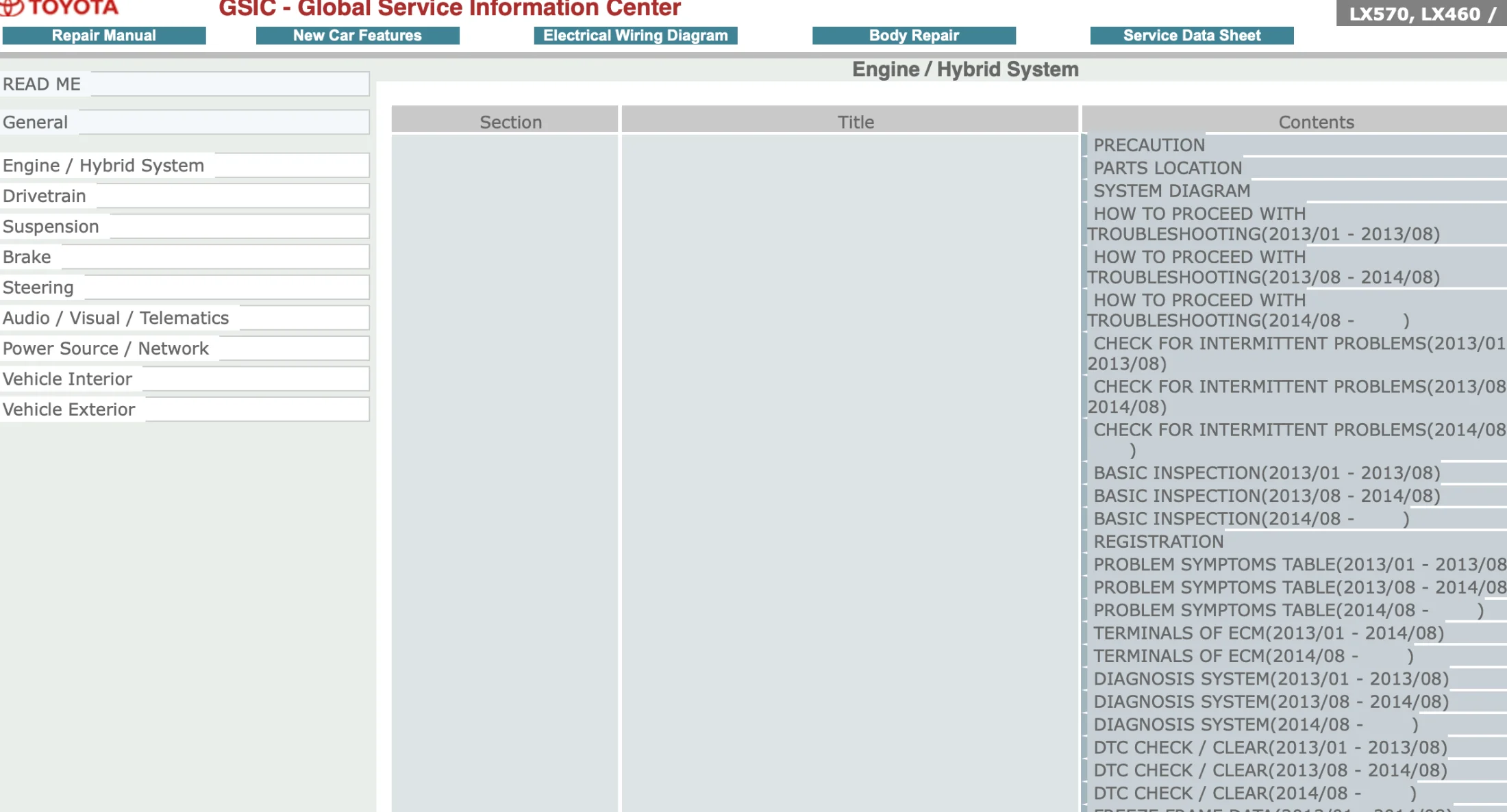

I think im in!!!
Question: I found out where the V belt inspection/removal/install is but not the idler...also -- does the manual not state what size bolts are required for each task? Thanks again!

If you’re in the US (I assume you are) use the first link “TIS” in the menu. The GSIC versions are international and there are engine differences. Also this TIS link is a bit easier to navigate IMO
No it doesn’t, just the torque values. Parts of it can be a challenge to navigate but it’s (almost) all in there…
