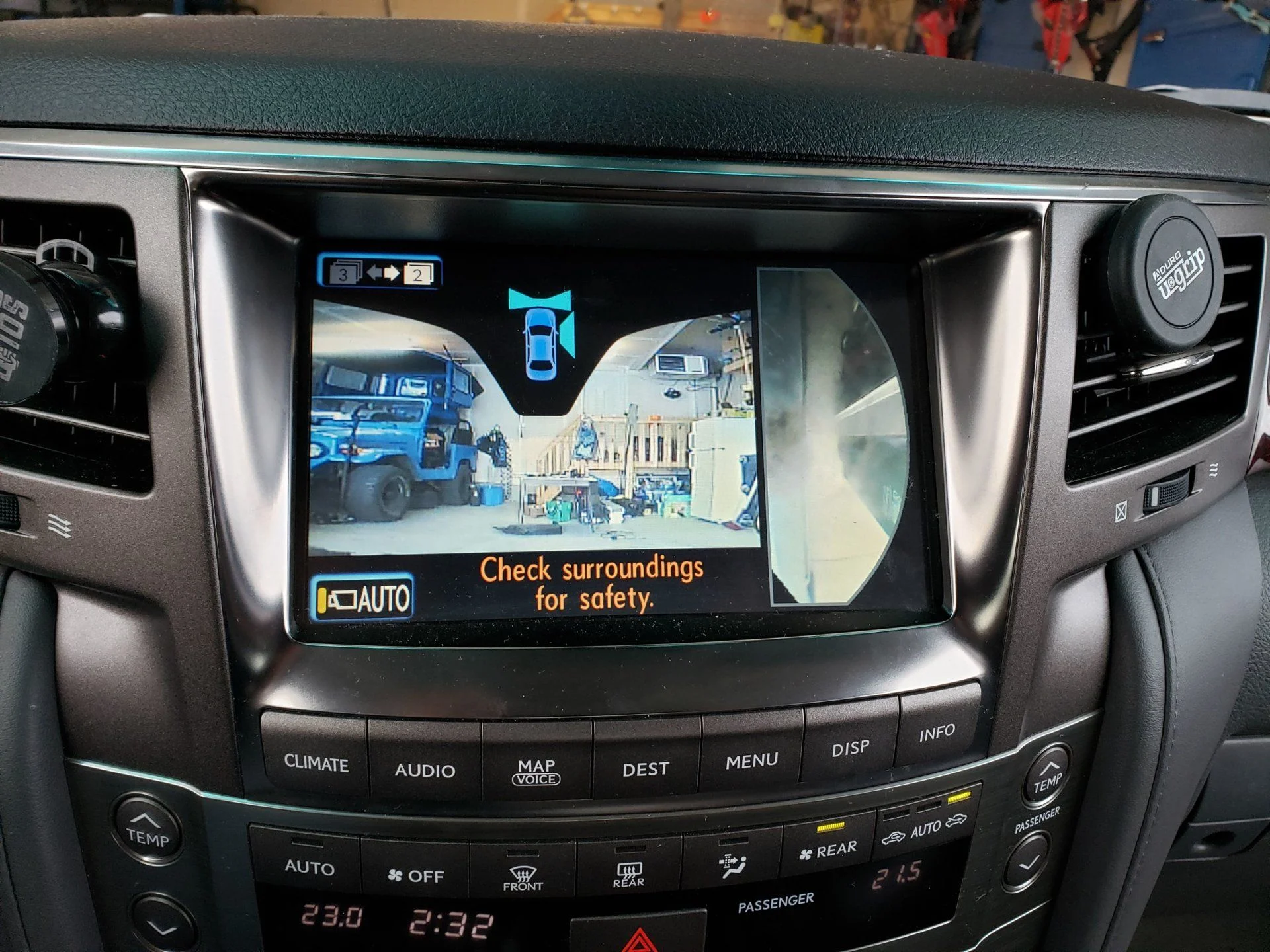

Hello.
My 2009 LX570 front wide view camera shows up cloudy on the screen. I have tried to take it apart but can not get deep enough in to the lens with the film. Has anyone else had this problem and figured out a solution? I did search google with the Toyota part number on the camera and found nothing.

So, after a long and arduous road. I have come to the conclusion that one of the lenses was shatter and rendered the camera useless. So I was faced with paying $500 for a new one or get creative.

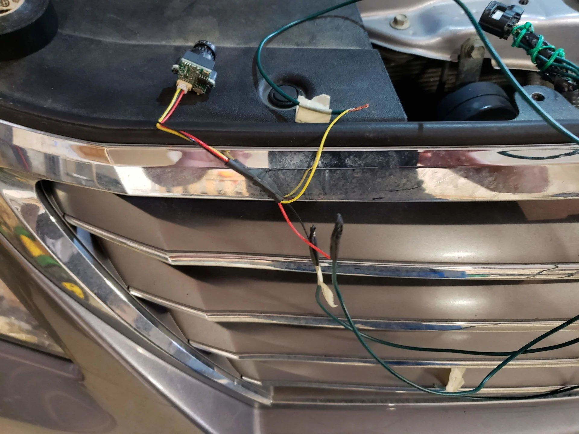

I learned the ins and outs of the wiring diagram. I found it somewhere online. Thanks @grinchy I hadn't seen your post yet.

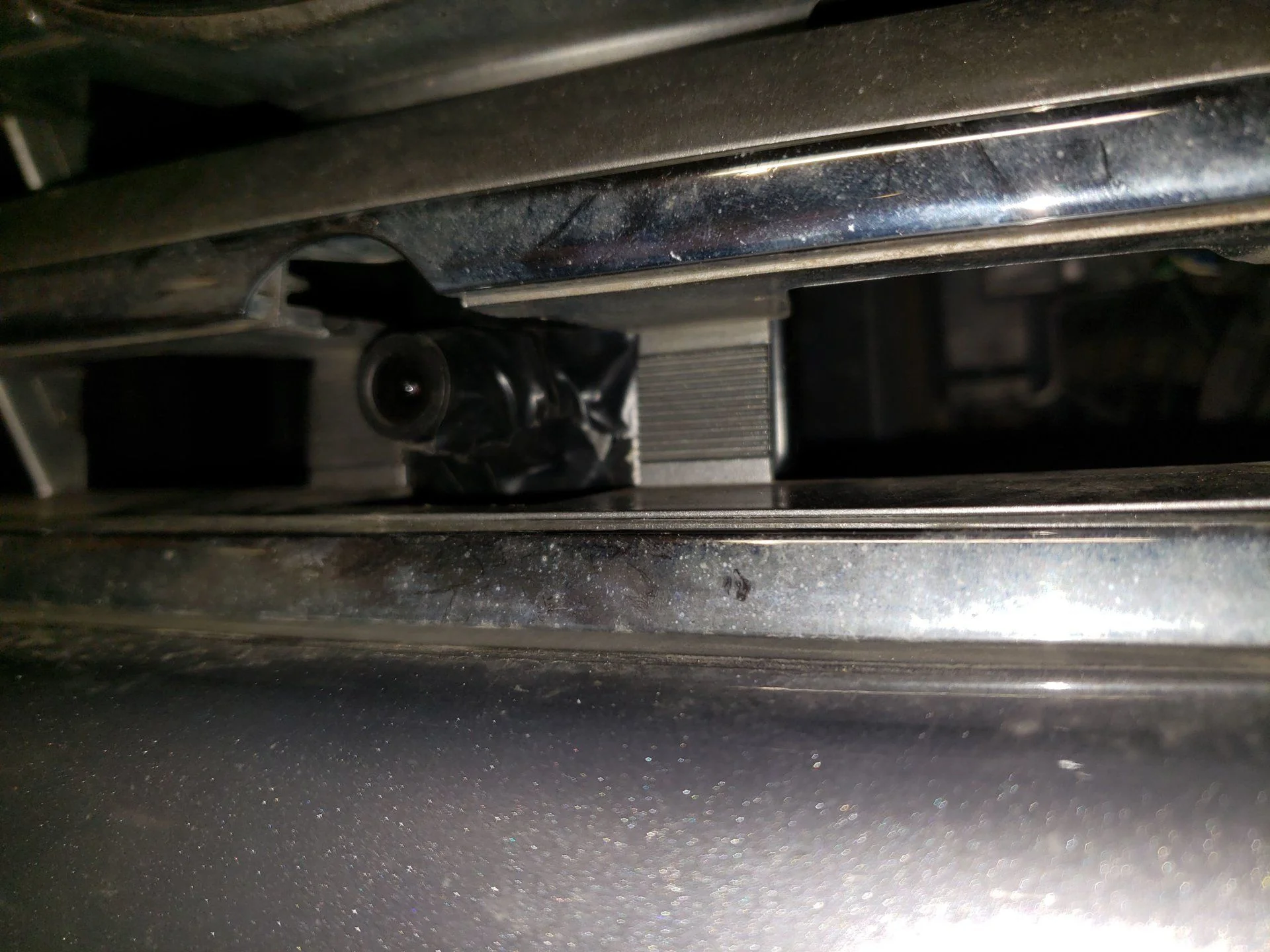

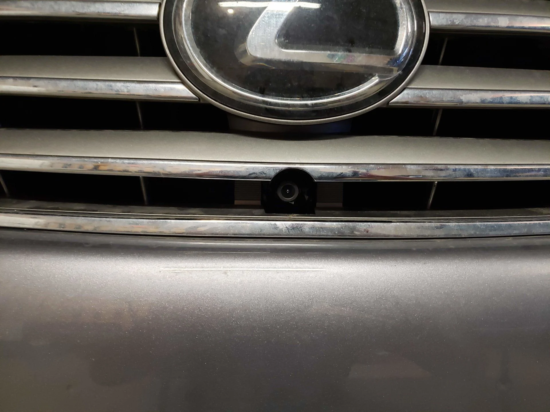

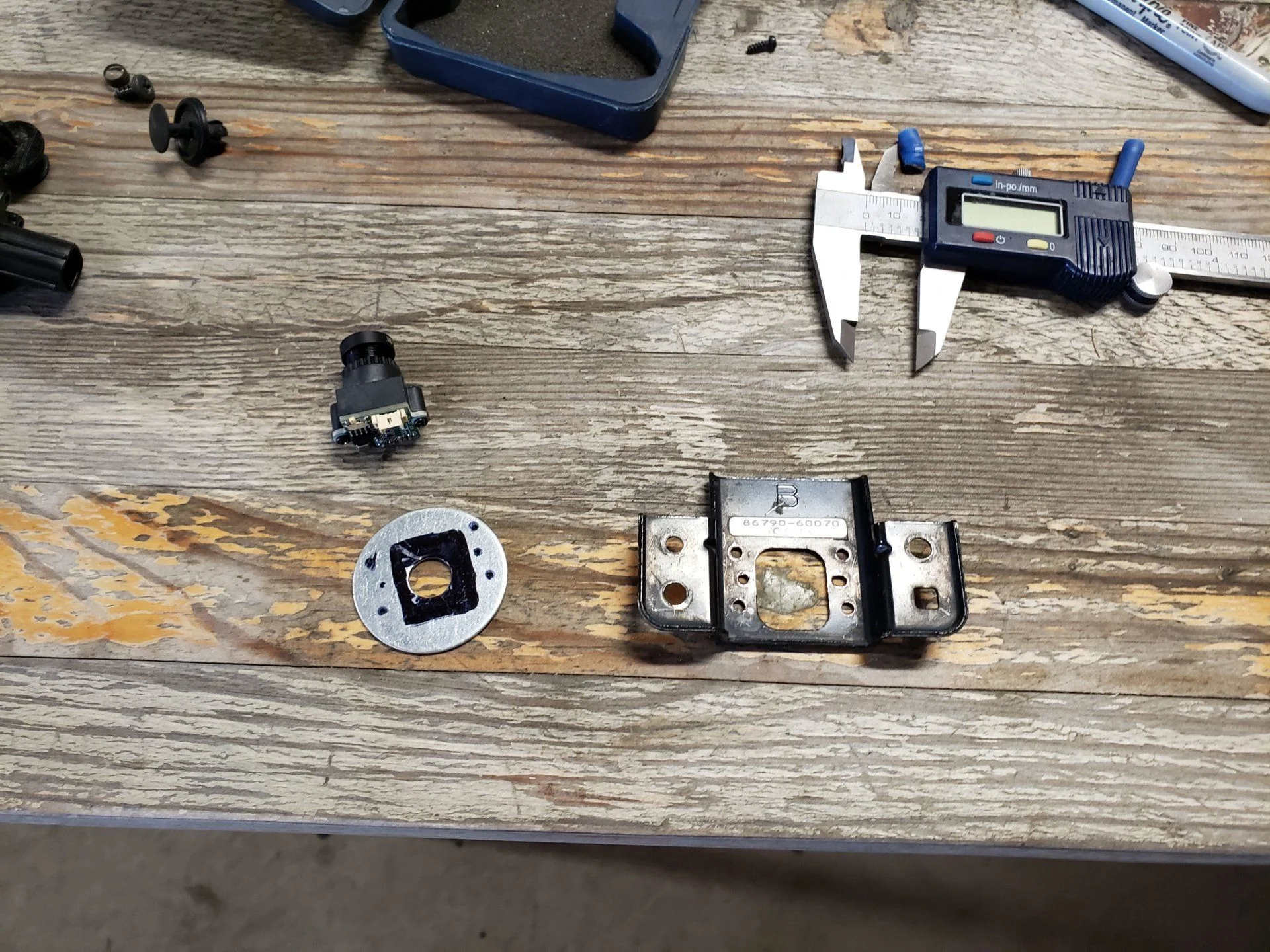

The only issue with the new camera was mounting it and making sure it was waterproof. So I chopped up a large washer and used a liberal amount of electrical tape.
Overall I am very happy with the results. I may go back and replace the camera with something that is waterproof and has a wider angle. But I will ride this one for now and see how long it lasts. I sure as hell wasn't going to fork $$$$$ for an OEM camera.
