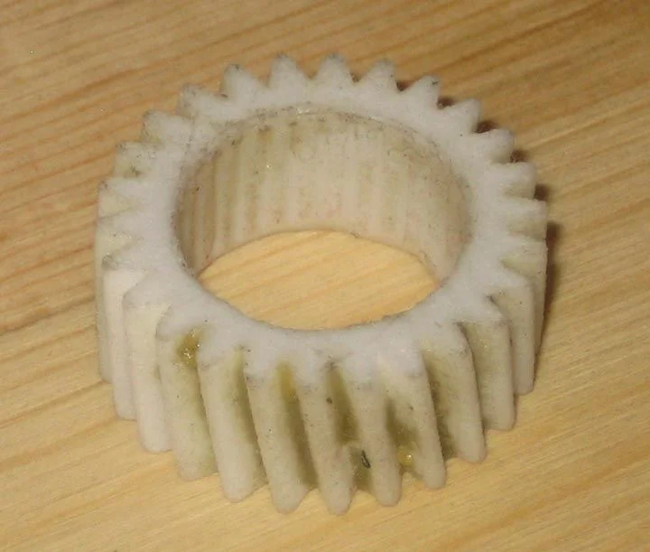

I've got a "test gear" with the guy who donated the one I copied. I am still waiting for his feedback, mainly because it would be completely unbiased. But I haven't heard from him, will try to send another PM to shake that loose.
But we did a 4-day wheeling trip this past weekend, so I was able to test mine out. It works fine, many adjustments were made to the seat position over the course of the trip. However I noticed more backlash in the seat than I have on my driver's side, like the seat will shift front-back a little bit. It was most noticeable when wheeling, going from uphill to downhill, you'd feel a little shift in the seat. Of course my wife didn't notice at all when I was driving, but I picked up on it.
One thing I didn't do was measure the gear before installing, but it's possible it ran a little small. If so, I can easily scale it up, by whatever factor I want. I still think it's best to err on the small side though just to minimize any binding, but am honestly not sure on that one. If it's too loose then we risk stripping that worm gear, and that would be an even tougher one to draw in CAD, I'd rather not go there. I've got an extra one at work and will measure it tomorrow to see for sure.
But worst case is these should at a minimum restore function to a non-functioning seat, for those of you with stripped gears. Best case is I can tweak it a little to get it a little closer to stock performance. So give me another week or so, hopefully by then I'll have more feedback and if not what the hell let's just run some anyway.. you guys have been super patient and I'm sure if they suck we can work out something fair for a refund.

I tested out the "2nd gen" seat gear tonight, and it works really well. What changed was an increase in the gear angle, from 10° to 13°, as well as a small leading edge ID to help get the press fit started. My seat is running really smoothly now, much better than it was with the 1st gen gear in there.
blame that one on the installer.
and thanks for taking the leap of faith, also thanks to a few others for the PM's. yes I still have some if anyone else needs these, see the for sale thread (linked above) for more details.
