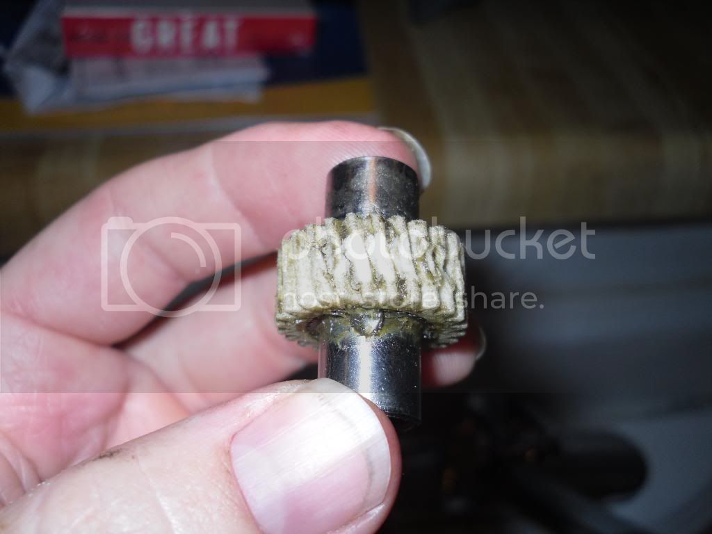

Anybody install a new gear just to have it chewed up like this:
yep
yes, I had the same happen to me but I know that when I put the gear It went in tilted to the side.
so since the begining it made some funny noises before it colapsed.
Just ordered a new set, made sure to get it straight and no problem so far, I´m very happy with the gears.
