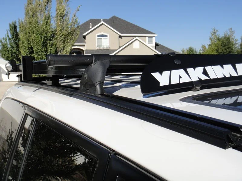

If I am understanding you correctly, you are interested to know if you can use your Yakima system on the front half of the track set provided in the 1.4m Front Runner Slimline rack, where you would have the FR SL basket at the back and the Yakima bars up front. That answer would be yes. Front Runner has a very stout set of track in their system, and it is very similar to the track dimensions offered by Thule, Yakima, and such. It should work fine. The track in the FR SL rack system span from just behind the rear factory rack mounting points, to just in front of the front factory mounting point. I guess that is pretty obvious. But what that means is that there is plenty of track in front of the basket to mount your bars and accessories.

Thought I would throw up some pics of the finished rack install. Here they are...
...and a couple more.
