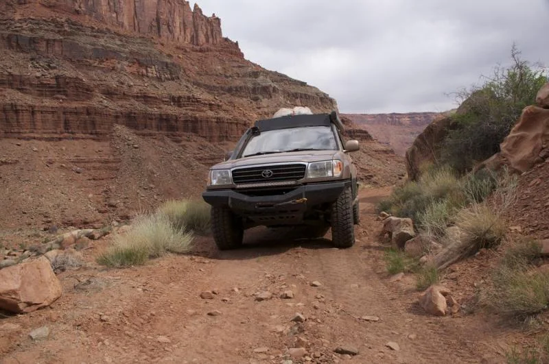

Got a request from a Mudder for some additional pics of the rack.
Here's some poser shots . . .
Couple more . . .
Made some recent changes - shortened the round Yakima bars to minimize wind resistance. I also looked at a number of fairing / wind deflector options and eventually went with the largest Yakima fairing (50"). Since this size rested on the rails and made some noise, they were notched slightly using a Dremel.
Overall, the rack is great. Have a few more items I need to get for some of the trips we have planned for this summer and fall, but so far no complaints!
