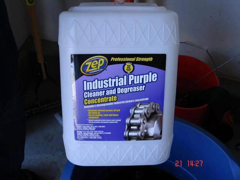

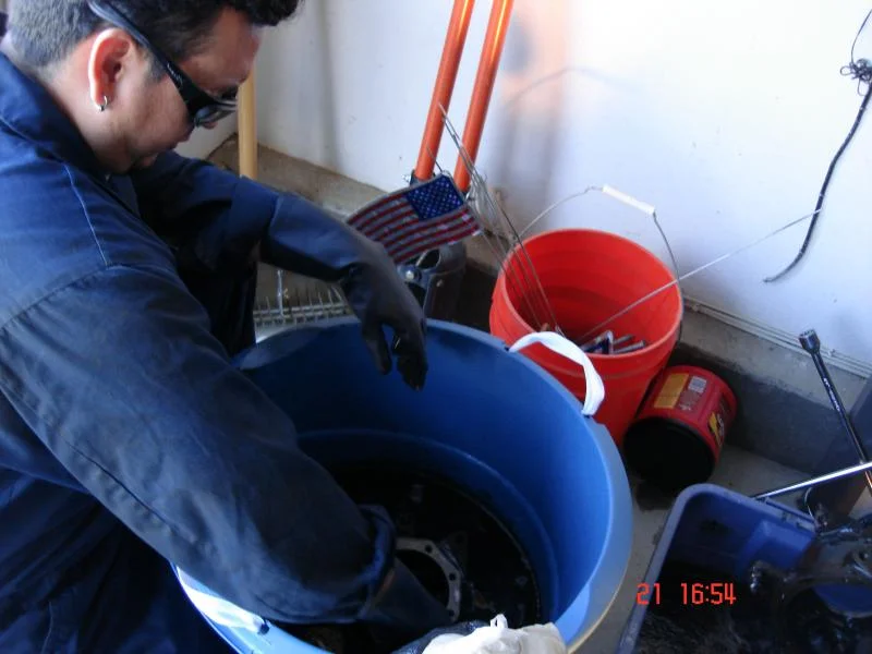

Well had to do it after about five years of clicking. Some tips that I may offer.
For cleaning agent I used ZEP from Home Depot. This stuff is potent and nonflammable. It is less expensive than solvent and took the grease off in less than five hours.

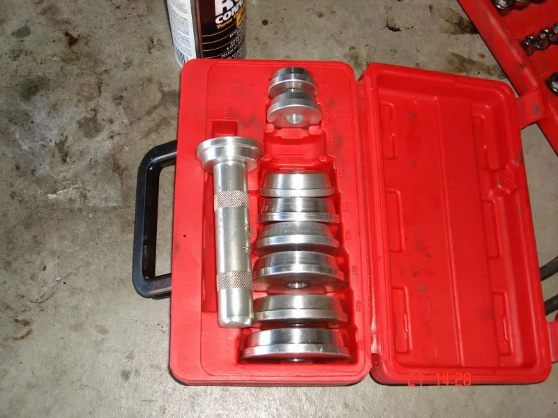

I was also fortunate to find seal and bearing tools that you can rent from the local Oriellys/Kragen/Autozone. These were the biggest time savers for getting the races and seals in properly.

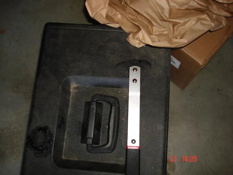

The oil seal puller was a big help. 10 bucks at NAPA.
