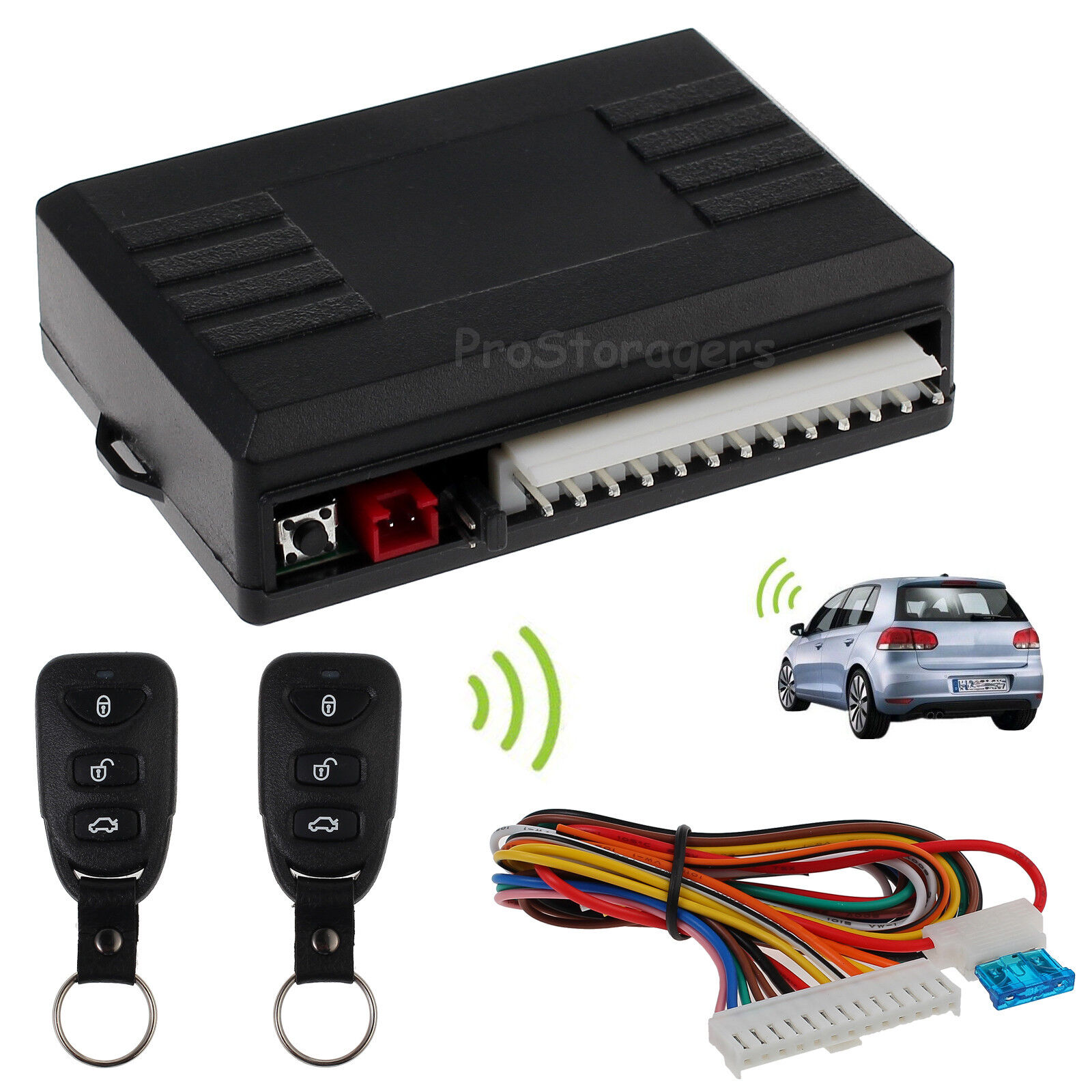

I have this:
Universal Car Keyless Central Remote Control Kit Locking Door Lock Entry System 799493429503 | eBay
and thinking about using (EDIT) one of the other wires as my ignition kill switch. wiring it to a hidden relay that I run the coil ignition wire thru. The arm & memory light that comes with the unit runs to the dash. Blinking blue light at night ...maybe scary to a night-time thief thinking an alarm may go off.
I agree that a decent alarm with a very visible blinking light is a good call for stopping opportunistic prowlers just looking for a quick grab. I live in Portland, OR and literally every night there are tweakers going around and trying door handles. I have a camera aimed on my rig and so far haven't seen any issues. My alarm also has a two way remote that goes off if the alarm is triggered, a starter kill and a backup battery hidden under the dash. Finally, I use a club (I know, can be defeated, but most of the loser car thieves around here are too lazy and are looking for an easy target) and also have a gps tracker. Another good, inexpensive option could be the combo of a cheap alarm with a bright blinking light for deterrence, combined with a separately installed hidden starter kill switch.
