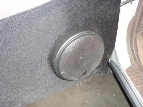

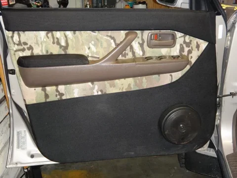

I moved mine down there is a second hole not round but speaker size if u made a ring like i did . it will work .2 pcs of 3/4 plywood glassed together then painted .wiith a foam baffle on back to keep moisture out and a little sound improvement. memphis 6.5" mclass.And a 8" woofer in center console to help with front mid lows.77777 003.webp
Nice work on the center console. I have a couple JL 8s sitting around...... It looks like I found the placement.
