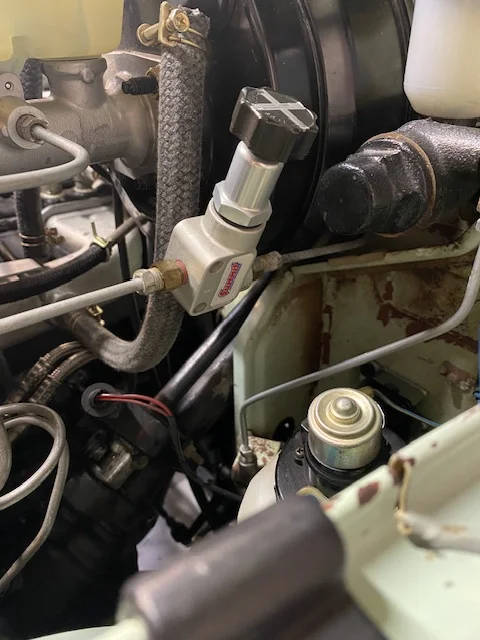

I imagine I’ll have to make some sort of bracket to mount this thing, but I’d like to see some ideas first.
Front disc, rear drum.Are you running disk brakes all around without a booster?
I should have gone that route. I got word that this one had an internal valve but I think I got bad intel.I didn’t end up needing one in my 1970 with the 80 series master front disc/rear drum. Looks like your master is different though.

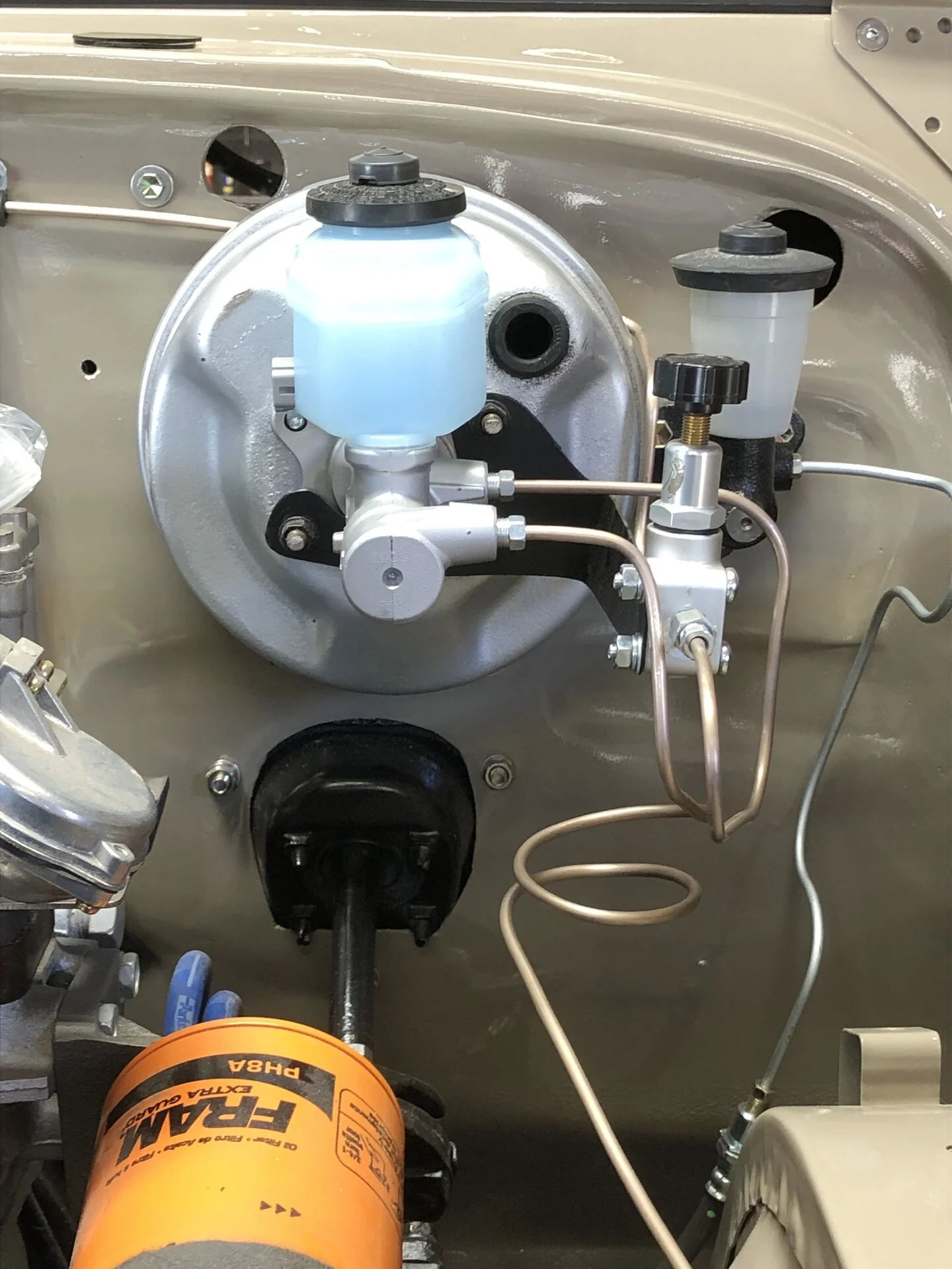

Here is what I didI imagine I’ll have to make some sort of bracket to mount this thing, but I’d like to see some ideas first.

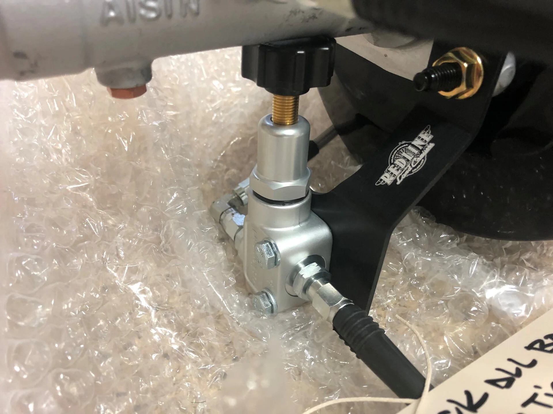

They’re out of the kit, I emailed about just a bracket.
