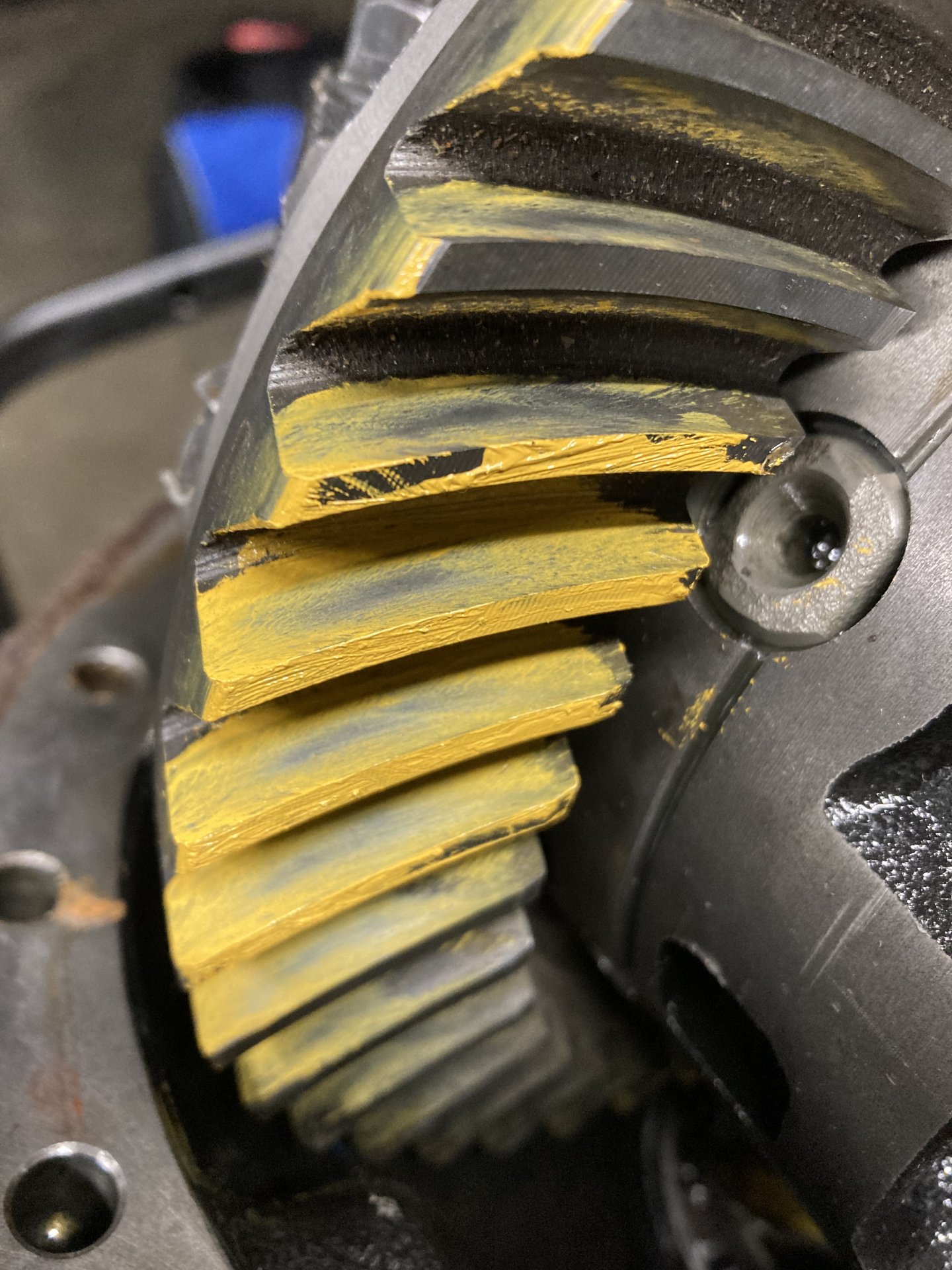

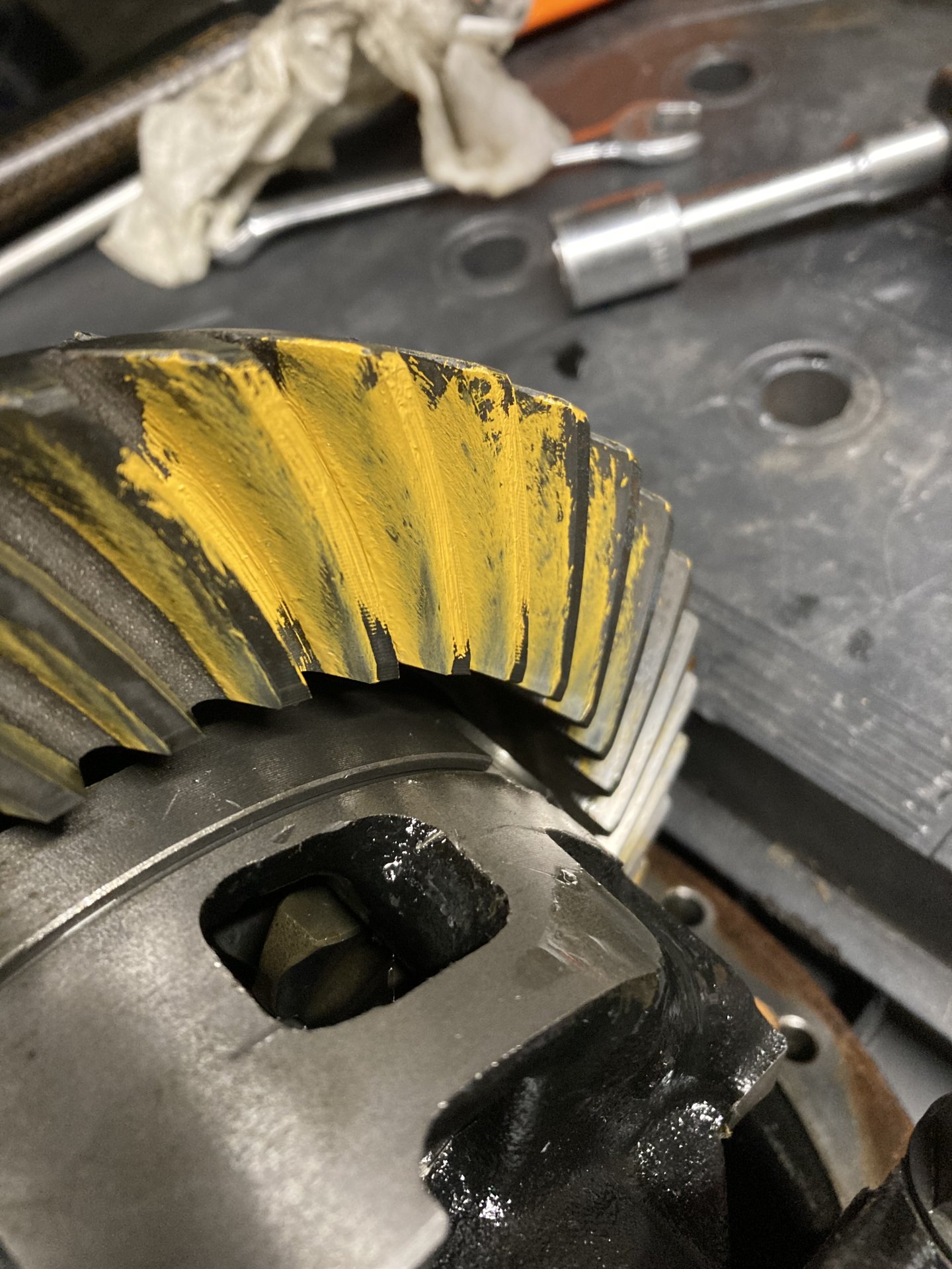

Howdy,
First gear set up here. Using used set of 4.10s, I’ve heard that might change the pattern on the regear. My drive side pattern looks good but my coast side is too deep into the toe (I think) and I’ve heard the coast side pattern matters more when regearing (Yukon gear and axle) Backlash is .006” and I have pinion drag set at 20”/lbs so that correct. I’m using a crush sleeve.
I’ll attach pictures but let me know if I should change the bearing preload and in which fashion (which bearing should I adjust)
Thanks for the help folks.
First two pictures are drive side, second pictures are coast side
