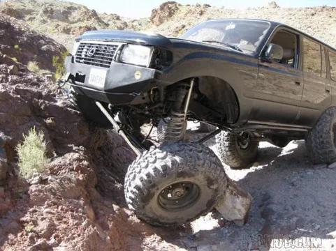

more flex is almost always better --the tire that unfortunatly falls in the hole in Nays example of the overly flexable jeep will be the same tire that stays on the rock and offers needed traction when a stiff 80 series lifts a tire.
flipping a rigid 80 series radius arm is such a waste of time. if one is to spend all the fab time to flip the arms they could almost as easily make a 3 link or make a jeep-like radius arm set up (which has a joint the the "y")
note that my 80 has radius arms in the rear that flex like mad.
THE OE 80 SERIES RADIUS ARMS SUCK ON THE ROCKS compared to almost every other solid axled rig out there. the 80's only saving grace is its lockers and wonderfull rear 5 link.
The easiest way to make the front end flex like mad is to make a better radius arm. you need a joint at the "y". do this and she will flex.
Dusty, your 80 has some serious articulation. Did you do a "Y" setup in the front? It looks like it is just a single control arm with one link on the axle end.

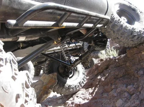

Dusty,
That makes sense now. I couldn't see that you had the 3rd link on top of the diff. Nice build thread, I had to force myself to stop reading it. D-60's seem to be the ticket but man that looks $$$$.
front is a 3 link.
rear is a radius arm with a joint at the "y"
pics of rear are in my build up
I don't see your point on the "y" link, your shock are just longer witch let the axle drop out, I would call that a bad idea with no control over your axle and loss of stability. Some times it's not all about flex.
