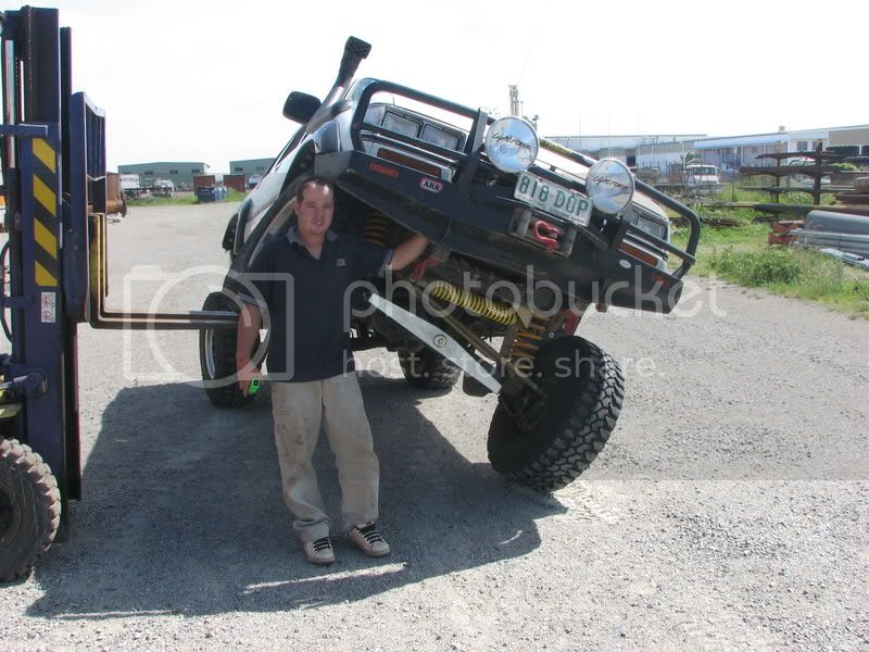

Truck with flipped arm's and stock setup (7" suspension lift, 2" body):
Truck with stock arm's and X-Link (looks like 4" coils and 750 mm shocks):
Truck with flipped arms and X-Link:
38" tires dropping below the door sills. :eek:
