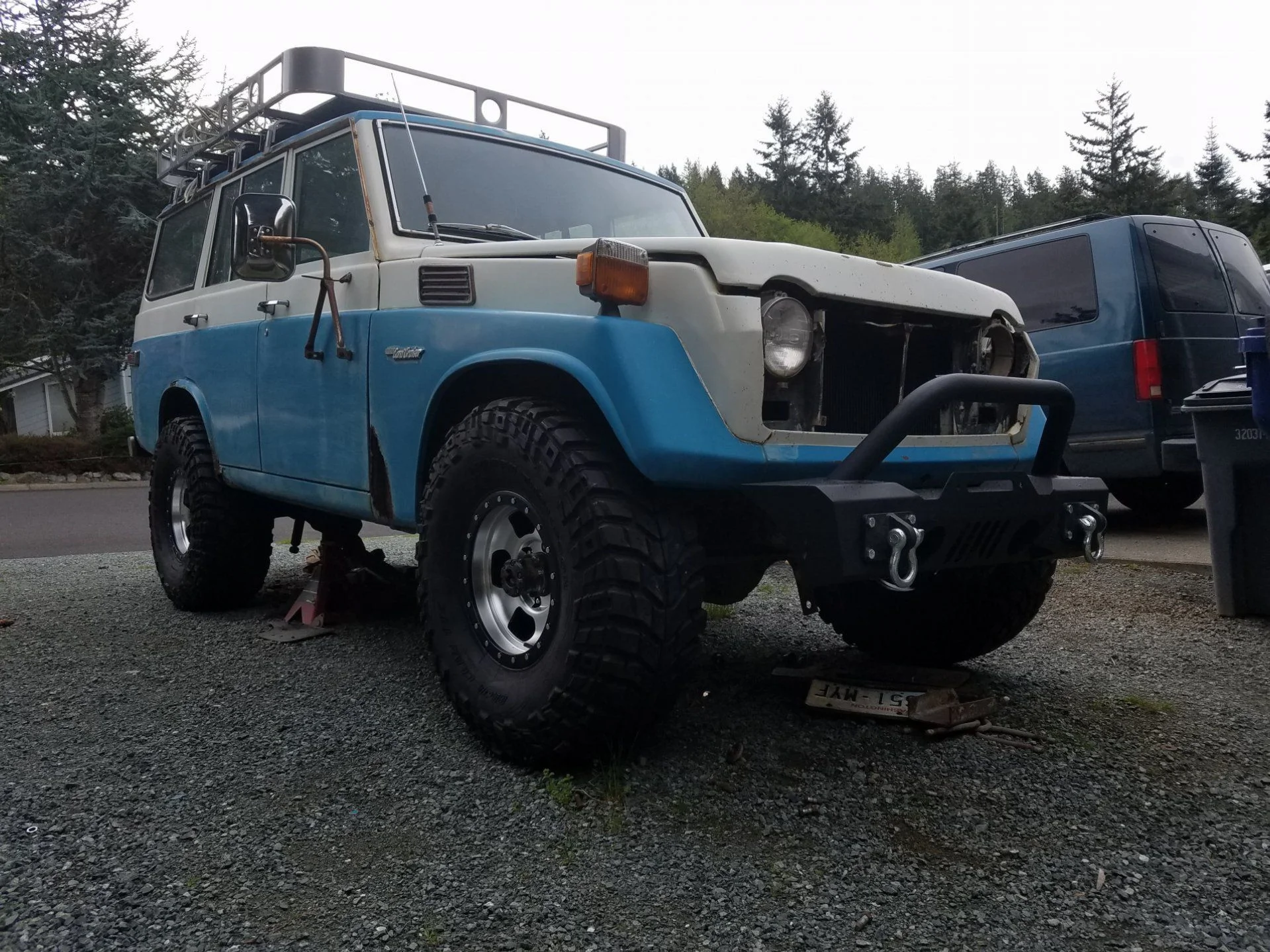

So a quick question, I'm getting ready to do a drivetrain swap and want to know if you can remove the front clip in one piece or do you have to remove everything individually
I believe it can be done. Most remove the fenders 1st. Check Scrapdaddy, Lil'John, or J Mack s threads. Or do a search
Thanks I did a quick search didn't really come up with much , I will look closer when I get a chance, just didn't really wanna add work if I don't need to
IIRCC the inner fenders are attached to the radiator mount, it comes apart as 1 piece.
Ok, keeper comin. That wouldn't really count as from clip, if you have to disassemble half the front end anyway. But if that is as close as can come then it is what it is.
Ok different approach, how difficult is it to remove old engine and tranni and install v8 and auto tranni with just the hood off?
that depends; how long is chinese?
it's not to terrible to just remove the front clip in 4 or 5 pieces...that said, a decent cherry picker and zero lift ought to do it. I pulled and placed a 3FE h42 splitcase combo from a 62 without pulling the clip...it is a loooong combo
Fenders have to come off first to remove the inner fenders. As others have said it’s possible to do an engine swap without removing the front clip but you’ll spend more time trying to navigate around the parts then the time it takes you to remove them. I think I had my entire front clip off by myself in about three hours this last go around and it made the rest of the job of engine removal and reinstall so much better I wouldn’t consider doing it any other way.
I'm just gonna have to bite the bullet and do it, I have.to can up mounts and redo the steering system with ram assist. So it's gonna be a lot easier without fenders in the way
