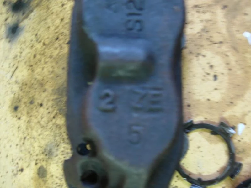

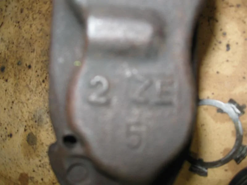

Pics added to held ID these calipers.

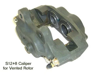

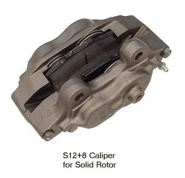

From the same Z site:
There are two different Toyota 4x4 calipers with the casting mark "S12+8". One for a solid rotor and one for a vented (wider) rotor. The 1979-85 4x4 calipers are for use with a solid rotor but the 1986-88 4x4 calipers are also marked "S12+8" but they are designed to fit the wider, vented rotor.
If you examine and compare the two different S12+8 calipers you will see that they are the same casting, (actually they are a pair of castings, one for each side of the caliper) except one is machined more that the other to be used on the solid (thinner) rotor.
There are advantages of using the S12+8 caliper (for the vented rotor) over the S12W caliper: It is lighter in weight; The S12+8 caliper body is not as wide as the S12W caliper, so clearance to the wheel is increased; The S12+8 caliper has two 43.0mm diameter pistons and two 33.8mm diameter pistons whereas the S12W has four 43.0mm diameter pistons. This increase in piston area requires a larger (1") diameter master cylinder when using the S12W calipers.
The belief that only the calipers with a “W” will fit a vented rotor is a myth.
