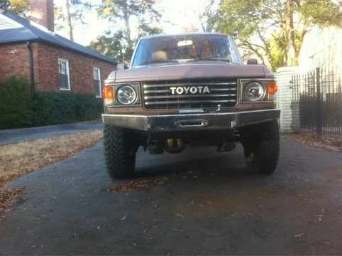

Front Bumper Build
Ready for paint!

Thanks my brothas!

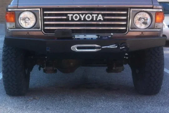

I already got a chance to try it out on the new year's ride. Heckler was stuck on some rocks in a river and I got to winch him out. Worked like a champ!
The clearance is great, too. The wings never once got in the way.
Where'd ya get the steel? And would you like to assist me in building my front bumper for the tow rig?
I got it from Southern Steel on Dunlap. I bought a 20' x 6" x 3/16" for $55. I also used some leftover 8" x 1/4" that I had laying around.
I reckon I could help you, but it might be a while before I'm ready to cut out big pieces with the angle grinder. That sh!t got old quick! Got a plasma cutter?
That seems like a decent price.

Good work, looks great! Hopefully you won't have to test out your weld strengths in real life! :D

Cameron, that looks awesome!!! I just got the same winch and am going to be doing something similar + a light bar.
What thickness of metal did you use?
Thanks! I've been pleased with the winch so far. I wish it was faster, but it sure beats being stuck!
It's mostly 3/16". I used some 1/4" that I already had when I started on it. If I was doing it again, I'd use all 3/16. Much easier to work with with my limited tools.
