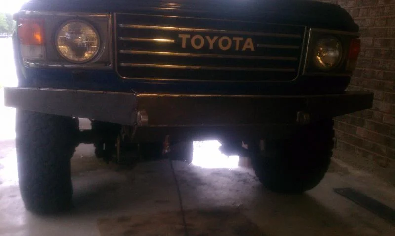

Man, if I had the skill set to do work like that, I'd do one for the LX in a heartbeat, and sell the ARB on mine to buy enough metal to do front AND back!!! I hadn't checked this thread in over a month, never saw that last (finished) pic. That turned out as good as any bumper I've seen, very clean lines.

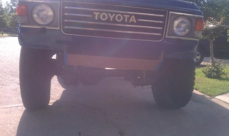

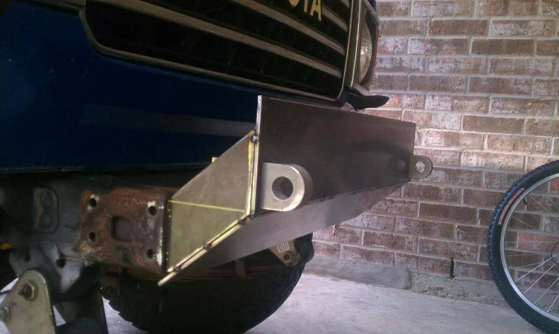

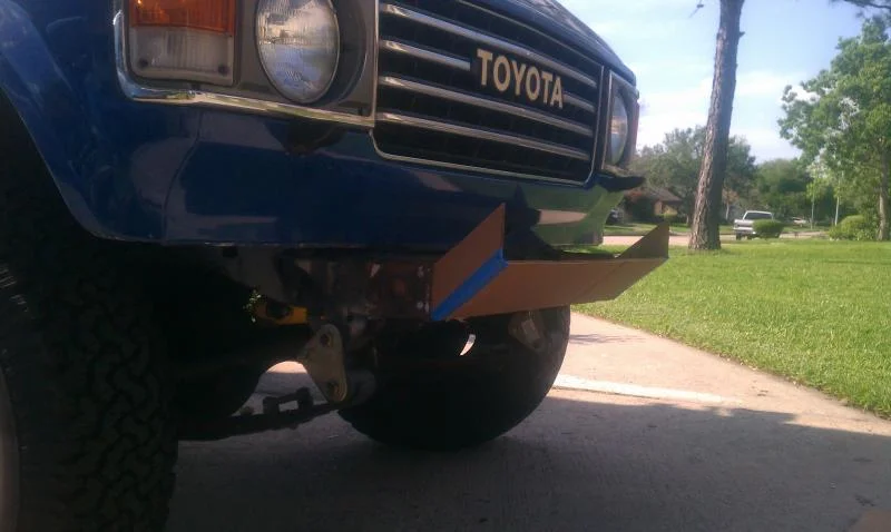

if you dont mind can you tell the angle you used coming off the frame where the skid portion of the bumper is. I know you used 6 in x 3/16 fat bar, but are the top, bottom and skid all 6 in or did you rip the front, top, bottom or did you just leave them 6 in. The pictures are at a 45 degree angle from frame.
No idea on the angle, but that looks pretty close. I used a strip of 8"x 1/4 flat stock to make a winch plate and built off of that. Everything else was ripped down to what I thought looked good as we were doing it.
