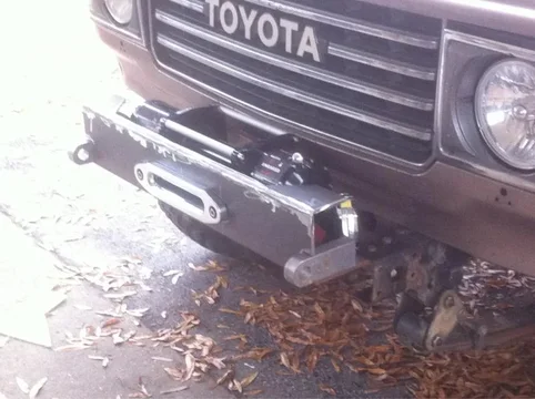

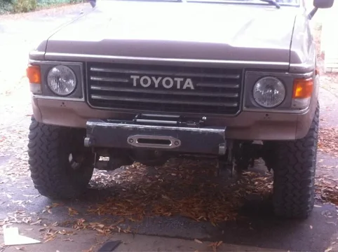

Since I haven't had a bumper for a few years, and since I recently got a winch, it is time to build a front bumper.

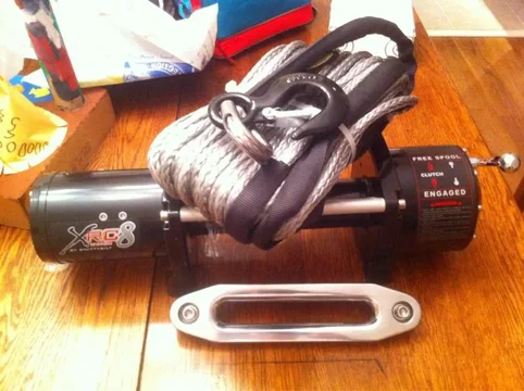

Here is my new super-duper Smittybilt winch with synthetic rope...

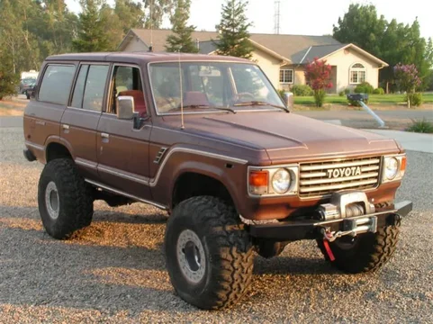

This is the look I was going for, but with a little more clearance since I am spring-under on 33's

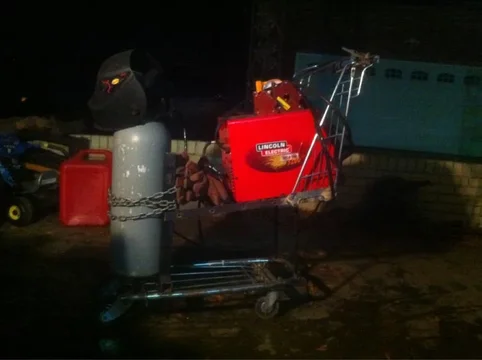

First, i had to fab a welding cart. It's part Super D mini shopping cart, and part iron fence. I swapped the wheels so it only has rear steer.
Sweet bumper! Hope to see it in action in a couple weeks.
Thanks!
We're going this weekend, though. Unfortunately the other one didn't work.

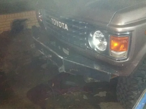

...thanks to my Makita 4 1/2" plasma cutter...

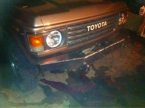

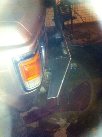

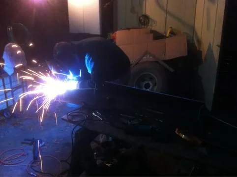

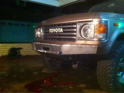

We got the rest of it tacked before it got dark.

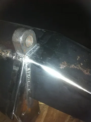

Then we got it all weldered up with the trusty Lincoln.

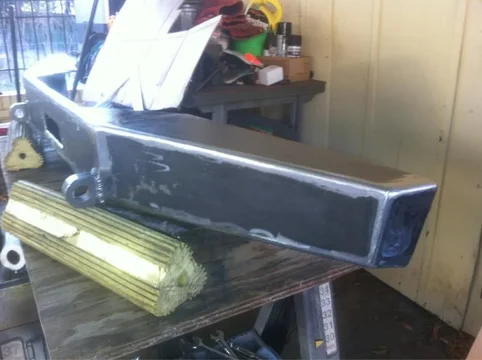

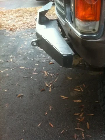

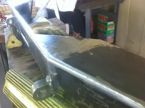

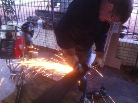

Got a lot of the finish grinding done. Just need to do the other wing and then clean up some of the wavy cuts and it'll be ready for paint.

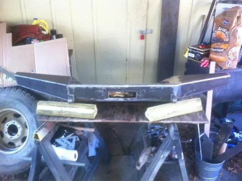

I saved my cardboard templates....
So far I've got about $170 in it. And way too many hours of labor to mention.
