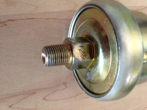

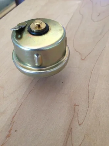

Picked up a oil pressure sender for my non working oil gauge from napa yesterday, was about to install it and noticed that the part they gave me was a 12volt part! Anyone know where I can get a 24volt oil pressure sender that's not crazy expensive OEM?
Hmm.. I think i put a 12v sender into my 24v bj70 and all that happened was the gauge just read higher.
Memory is a tad foggy tho so I'd get a second opinion....
Isn't there just a resistor inside you can change or bend a part or something? ... if it reads high?
It is just a resistor, I tried adjusting one that read low once, but nothing happened. Was a real pain in the ass to get open.
On the 70 it actually worked out pretty well. Needle was in a range that didn't make you nervous when you idled...:lol:
That gauge is a bit of a joke anyways. Not sure I'd spend a fortune on the correct sender just to get it working.
A warning light hooked up to the low oil switch is just as useful. Or a proper gauge with numbers...

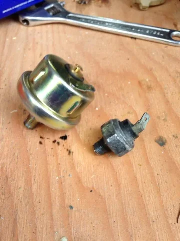

So, Cam was right, It is a oil pressure switch.
it turns out that the oil pressure switch and oil pressure sender go right into the same plug ins, and when my engine was rebulit, they just swapped in a pressure switch to plug the hole!
There are two wires that connect to the oil pressure sender, one is ground the other is positive, the interesting thing was that when we connected a ohmmeter to them, one way we had them in it was reading 12v and the other way it was reading 24v!
The one with the green electrical tape is "positive"
The intersting thing was that when we had both ends plugged in, the EDIC would shut off!
and when only the positive was plugged in, the engine would run, but there would be no reading from the oil pressure gauge on the dashboard
Could it be something to do with the oil pressure sender being 12v?
any help would be much appreciated
:confused:
