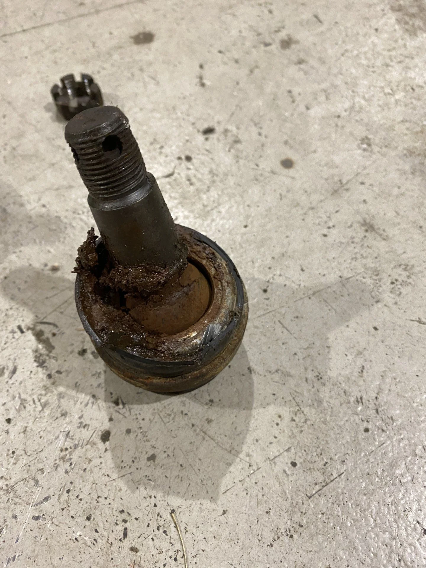

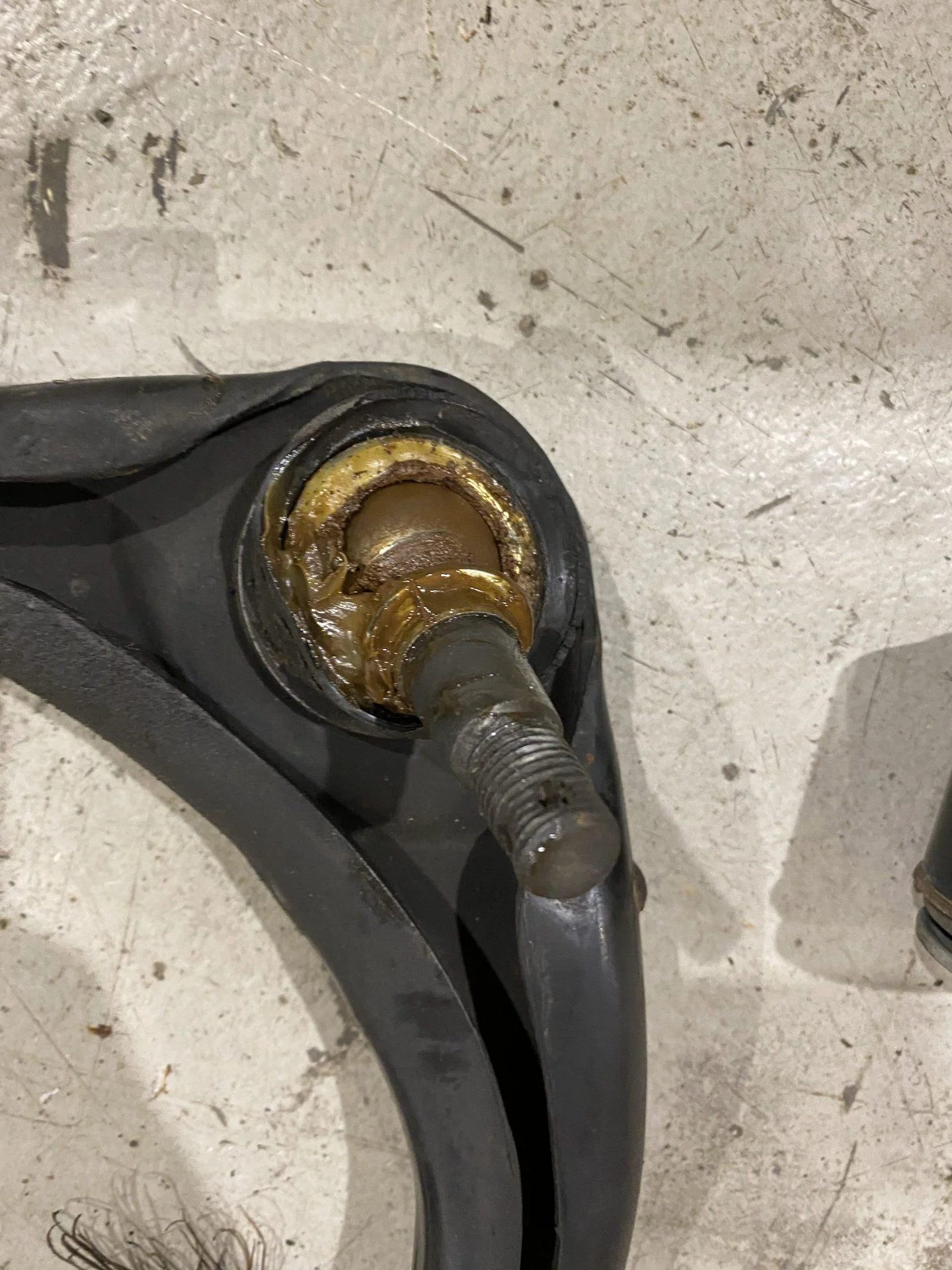

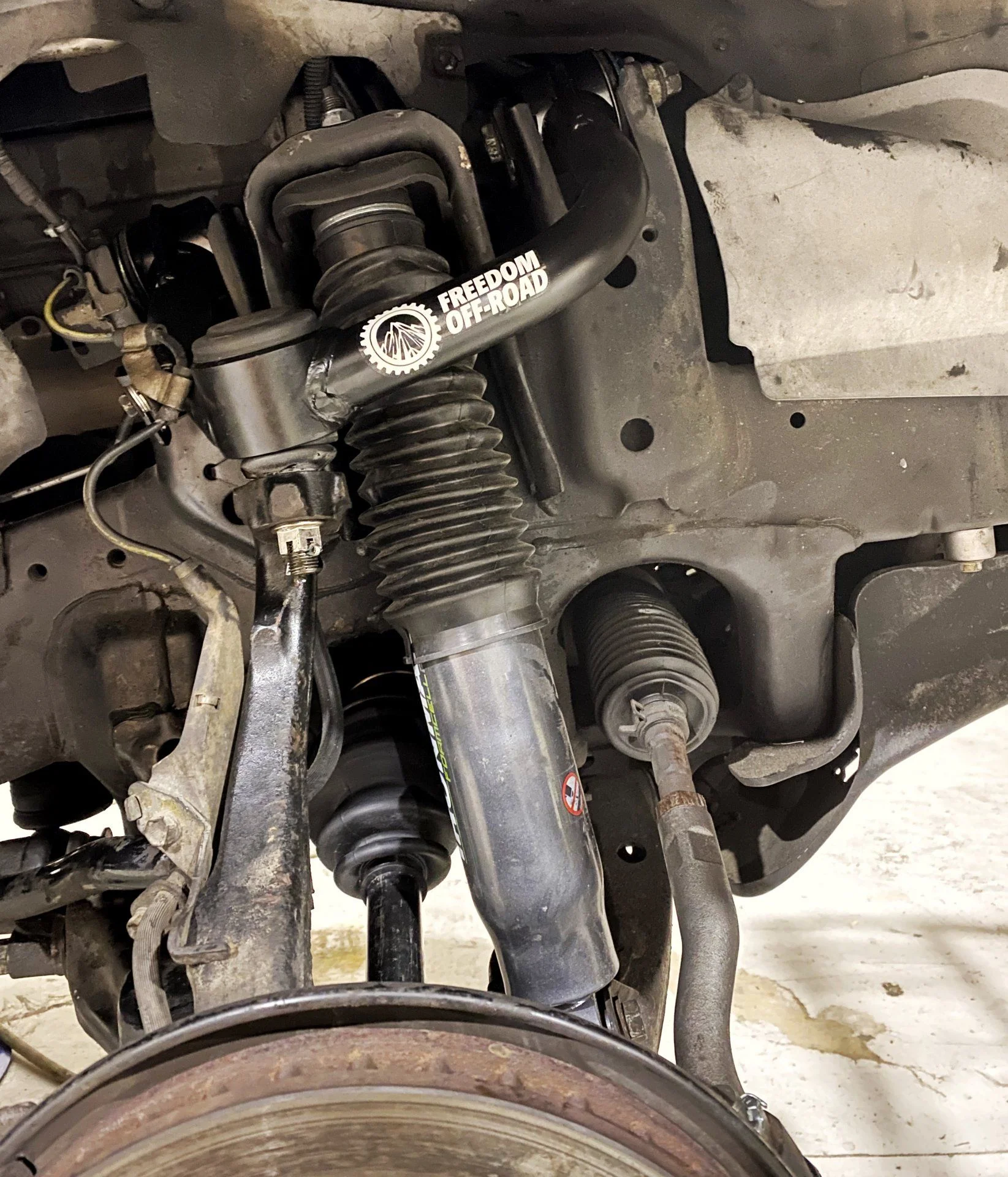

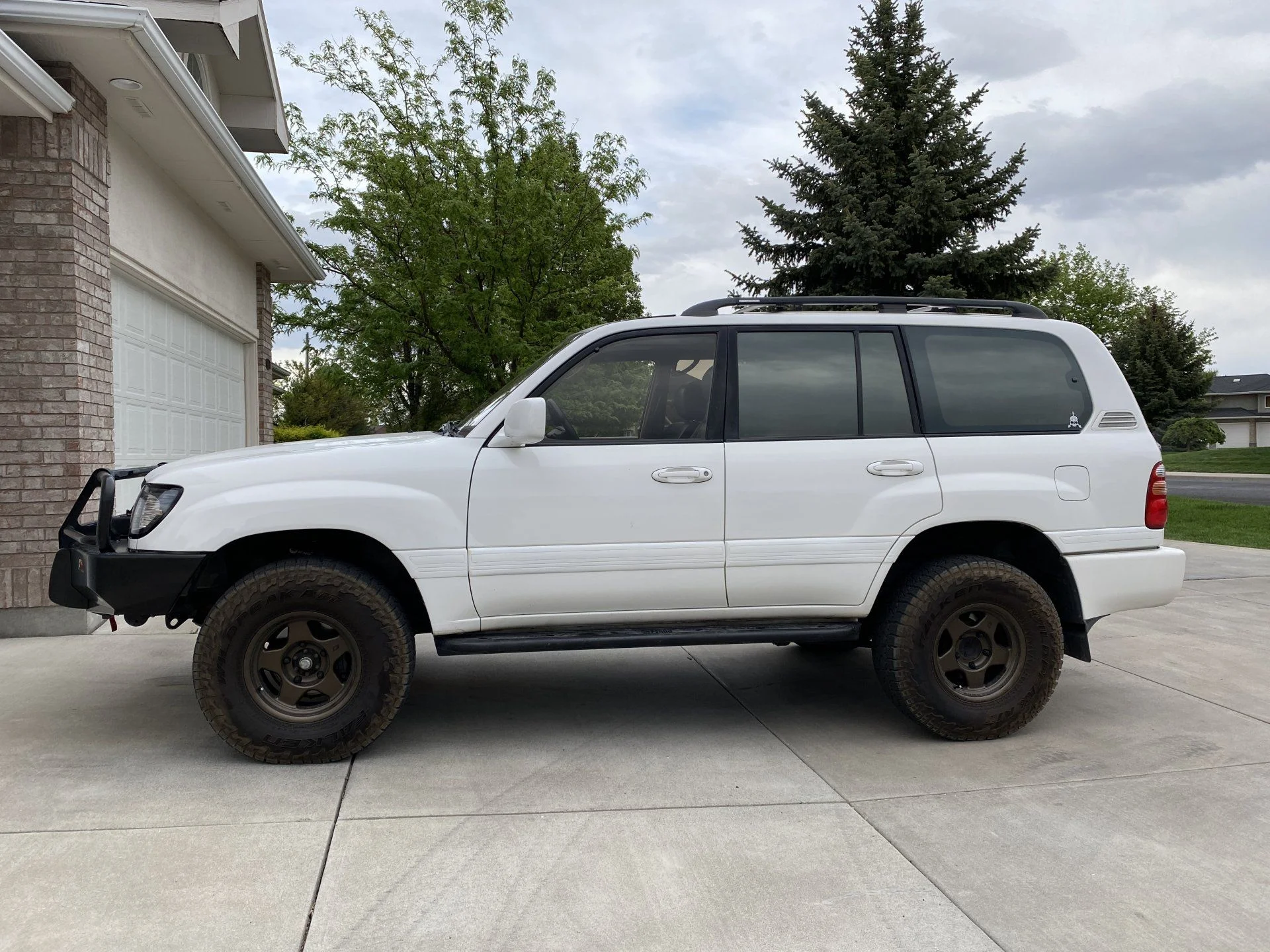

Here are some pics. Ironman Foam cell kit. Freedom UCA. New lower ball joints and new tie rods. Diff drop and extended sway bar link from Trail aTailor. Install was super easy. Everything went together well. Had it aligned and he kicked it out super quick. Drives great. You can see my ball joints and tie rods were destroyed on the right side.

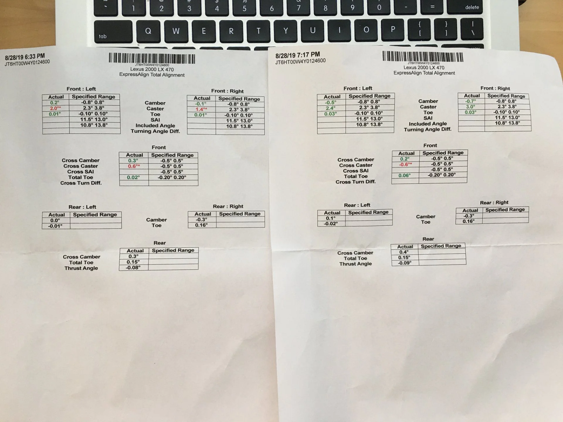

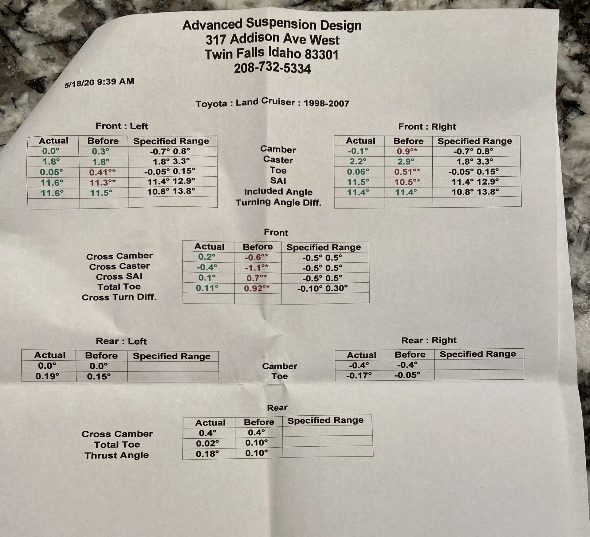

Here's my before and after alignment with STOCK UCAs. AHC delete, mild lift with sway-a-way torsion bar/ome 863/KONI shocks. My friend didn't want to mess with the cam bolts so I took the wheel on this alignment lol. Maxed out cam bolts pretty much border line ok with STOCK UCAs.
I wonder why the caster specs are a little different from the LX to LC.
