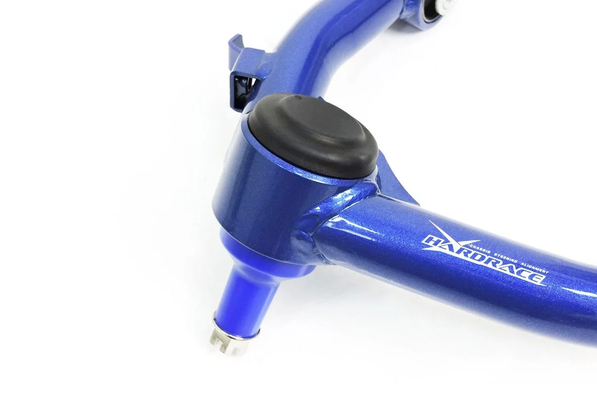

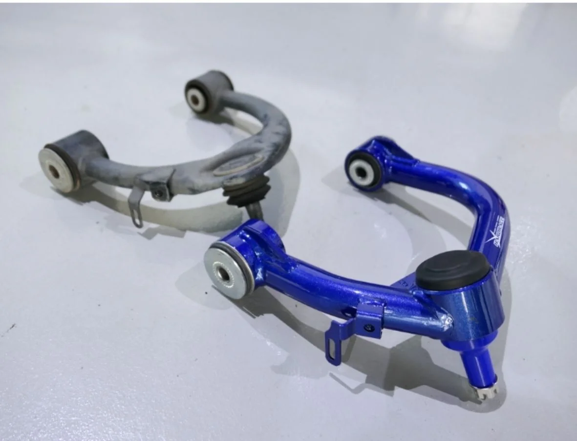

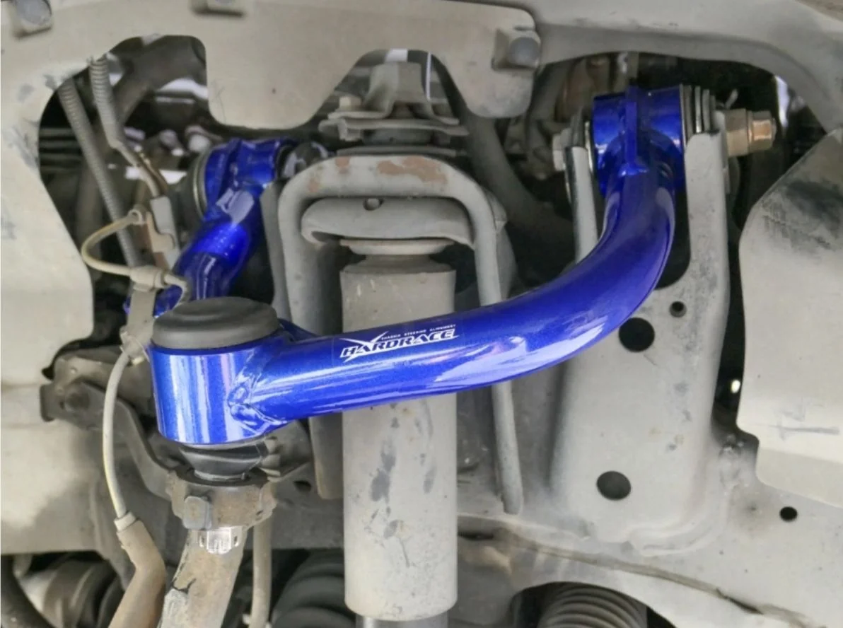

Its possible that the ball joint is sourced from HardRace (also Taiwan) Hard race is a highly sought after alternate solution for many race cars in South East Asia. Good, long lasting quality and normally on the cheaper side. I have a few of their bushings on my weekend racer.
A ball joint replacement for a Tacoma:
Looks very familiar now...

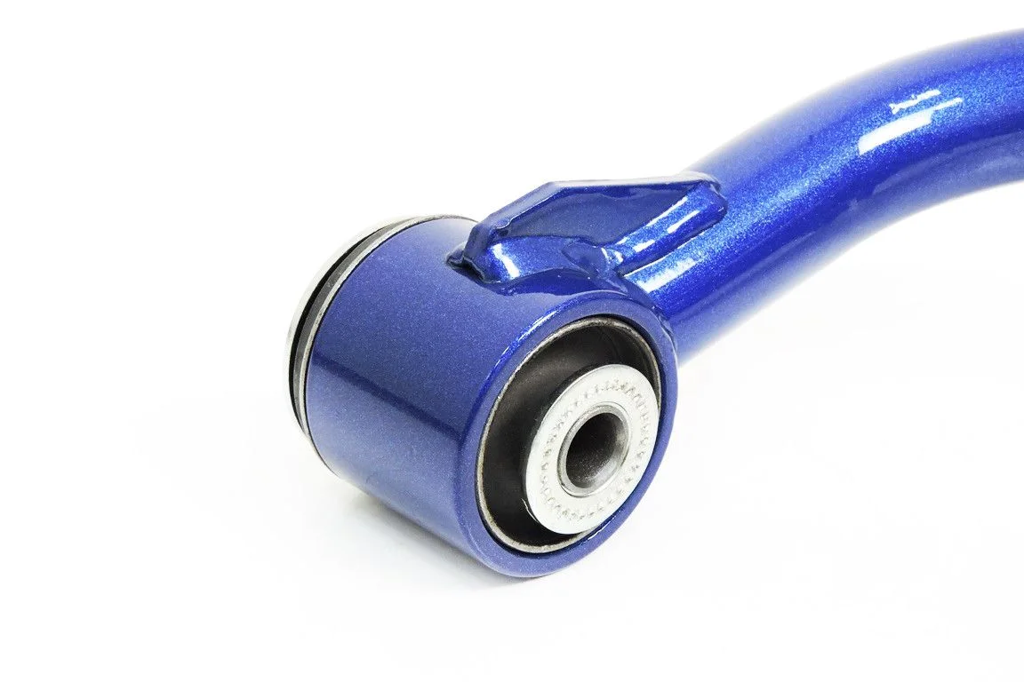

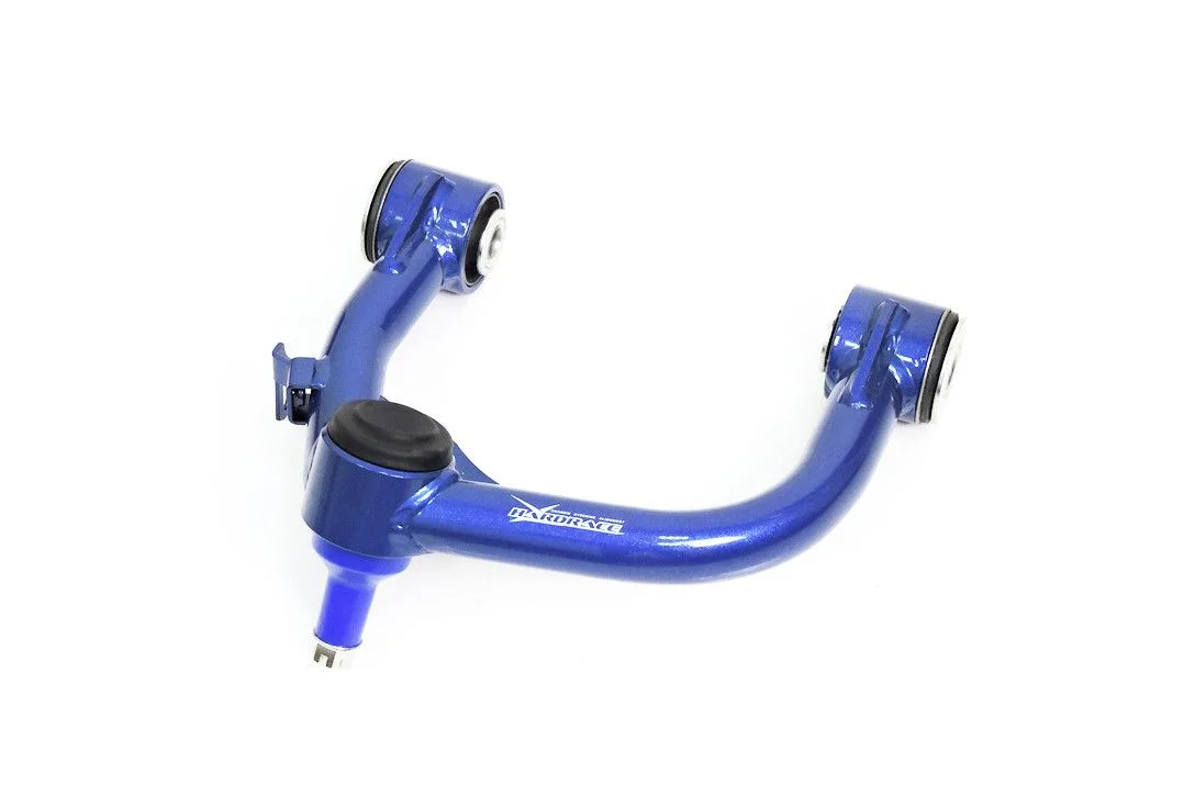

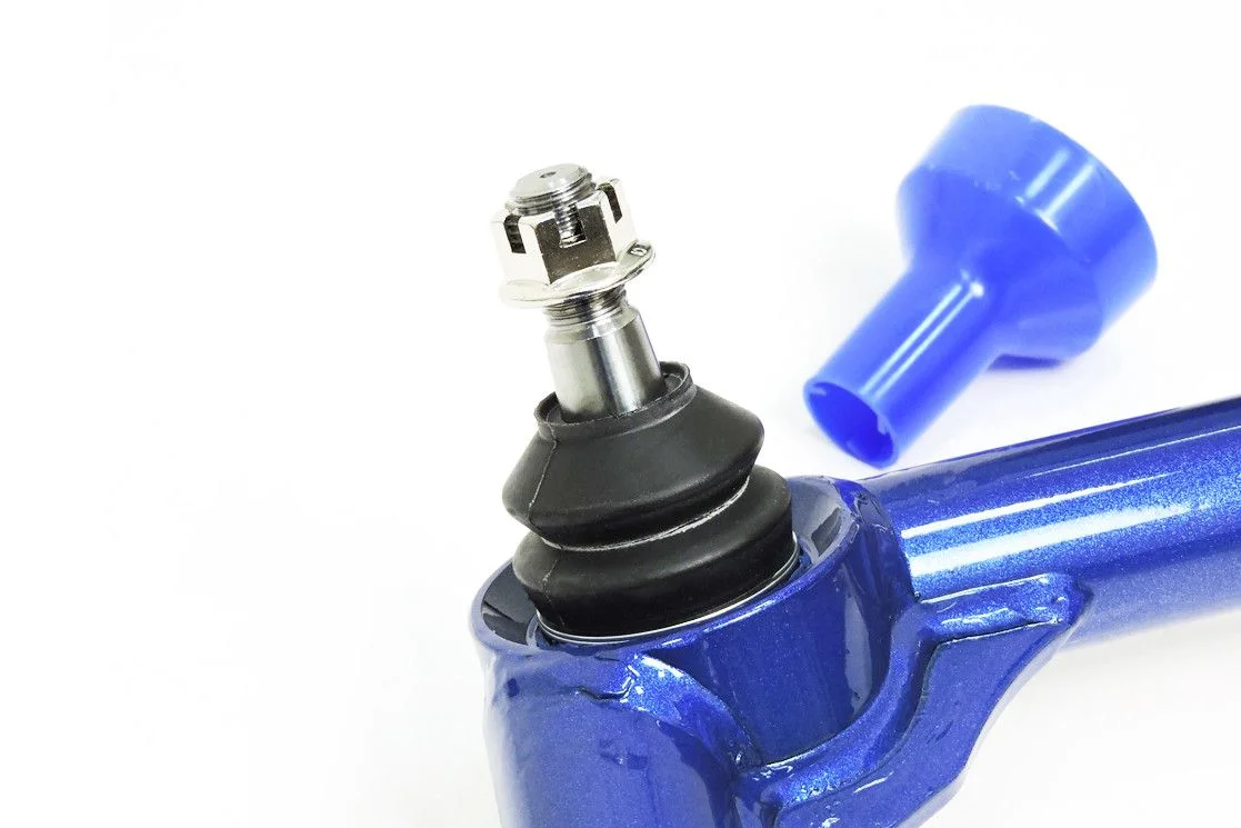

Hardrace upper control arms are made to correct ball joint angle on cars which have been fitted with lift kits over 2 inches.
Hardrace control arms made with hardened steel with superior harden rubber bushings, unlike polyurethane bushings which can easy broken, our High strength and anti-crack material extends the lifetime and provides solid steering response for years to come.
  • Increased 2.5+ Degrees of caster for better ride quality
  • Grease nuts ball joint design. (inside the upper black boot)
  • Super strong and durable
  • High strength steel tubes with 4mm tube wall thickness
  • CR-MO Ball Joint and special boot design, self anti-dust function
  • Equipped with superior harden rubber bushings
  • ED process and painting for the highest durability
  • OE direct replacement
  • Dramatically improving handling performance

Good eye!
Indeed! A premium if you want blue shipped to your door.😏
Well, if my $AU to $US conversion is correct, the site you found is ~$440 (US), which is a premium, but not as bad as it initially looks, and it is a pretty blue...

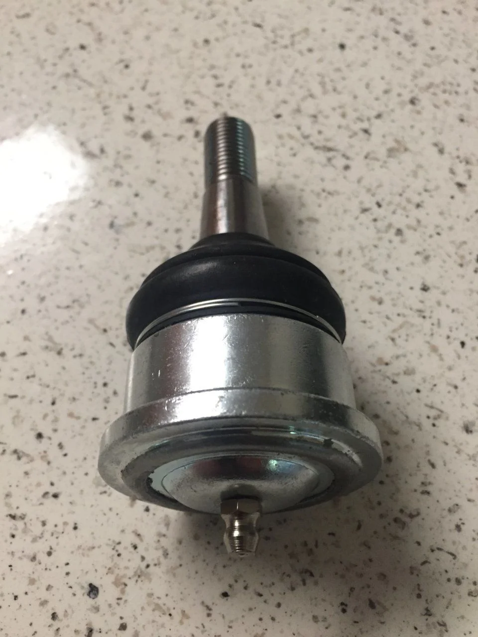

What is your reason for not trying the ball joint that it ships with?

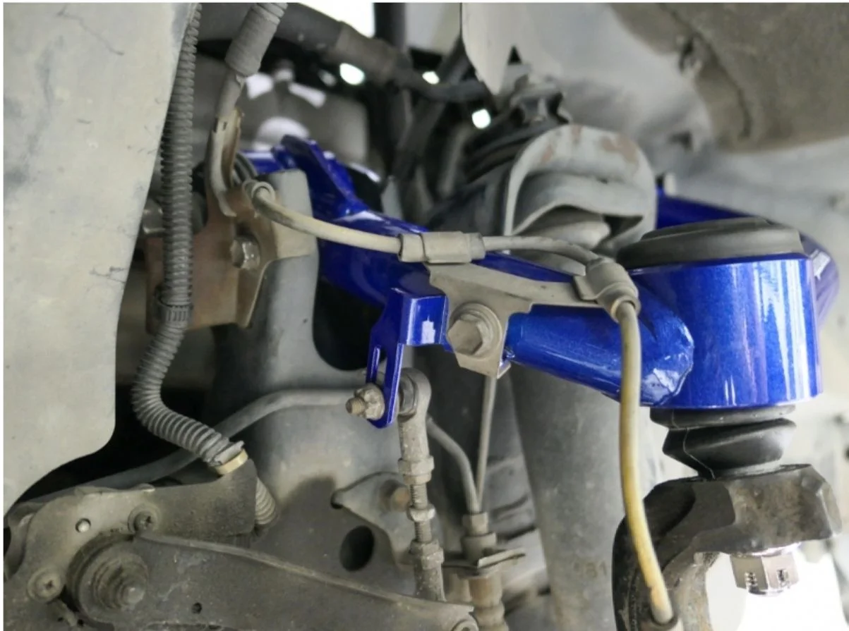

While I can say many positive things about their bushings, I have no idea what the quality is like on the ball joints long term. It would be nice to know if a quality brand 555 ball joint can pop right in down the road.
And here I was about to buy the new Dobinson UCAs. Glad I stumbled across this. Keep is updated with the install and results.
There is no advantage for a stock height vehicle with stock suspension travel. And the balljoints and bushings will certainly not last as long as OE.
Yeah, I was going to say something similar. Genuine Toyota will offer the best bushings, ball joints and fitment. These aftermarket options should only be considered, IMO, if you can't live with OE fitment due to a substantial conventional lift.
