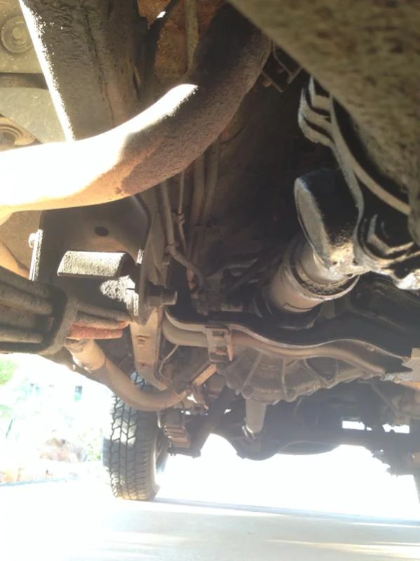

What is the point of going outside the frame rail when coming directly off the manifold? Are their clearance issues that necessitate it coming out? I would think that it would be better run something like the FJ60 where it is all run just inside the frame rail and then come out between the wheel and rear shackle (between the spring and the frame).
It's to tight with the fuel lines and transfer case. If it were possible I would agree with you.
-Daniel Kent
I run louvers.
These make the engine bay really dusty and once it rains it really get dirty under the hood...
I too would not run the exhaust pipes under the frame....
Judging by the pic above you got plenty of space to fit in a 2.5" exhaust pipe through there....
I run louvers. These make the engine bay really dusty and once it rains it really get dirty under the hood... I too would not run the exhaust pipes under the frame.... Judging by the pic above you got plenty of space to fit in a 2.5" exhaust pipe through there....

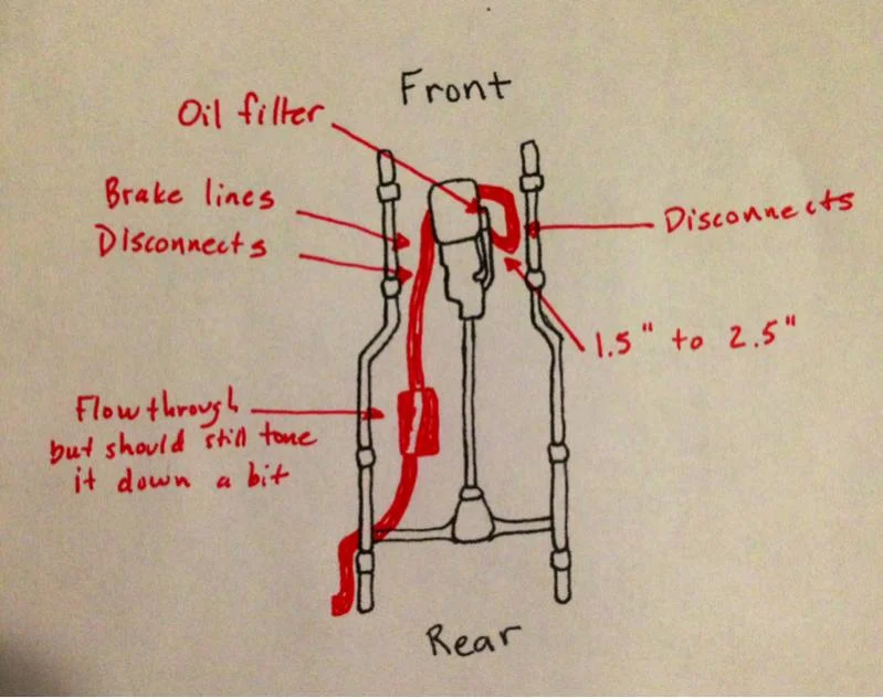

I assume which ever I run the dust would be great. I'm not looking forward to constantly washing the engine bay... I did go back to the muffler shop and we looked at it one more time and everything seems to be somewhat questionable as to possible issues. So we decided on what another MUD member did, which is to run it under the fuel pan and then straight down the driver side following OEM. I will put in two disconnects below the oil pan so I can just remove a section to work on engine parts (oil pan, etc). The only thing that's seems to be questionable is the exhaust will pass by the brake lines by the engine. I decided to go with 2.5" w/flow through Magnaflow muffler.
-Daniel Kent
Here's the new routing...
-Daniel Kent
aluminum heat shields will help with the brake lines.
If you are referring to the coil like brake line section these can be moved a few inches to avoid heat
aluminum heat shields will help with the brake lines. If you are referring to the coil like brake line section these can be moved a few inches to avoid heat

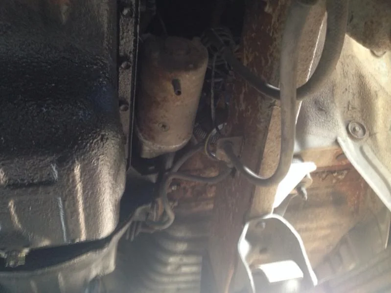

I'll see if they can make something to help shield it. I'm referring to this:
It will come under the high point of the oil pan and the go underneath the starter.
-Daniel Kent

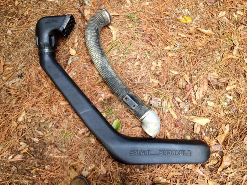

Anyone have a fender template for an FJ60 Safari Snorkel I can have or borrow?
-Daniel Kent
Found another resource for parts here:
http://www.4wdspares.com/
ARB also sent me a template for the snorkel install.
