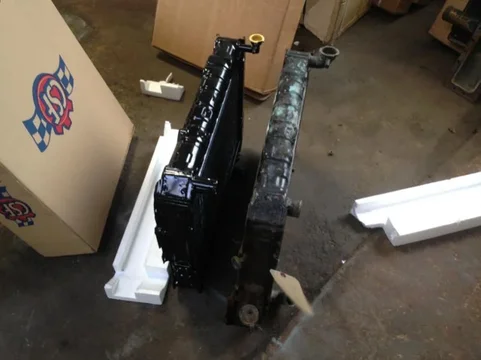

We also bought a used radiator with the hopes of having it redone since the current one is leaking. However it was discovered it was really to far gone to spend the money to "fix" it. The radiator shop found a new radiator for a FJ60 and then they had to cut the angled hose hookup on the bottom of the used radiator and put it on the correct side of the new one. They also had to cap the bottom hookup on the new one that was on he wrong side. Hope that makes sense! So now we have a brand new and expensive radiator. :D

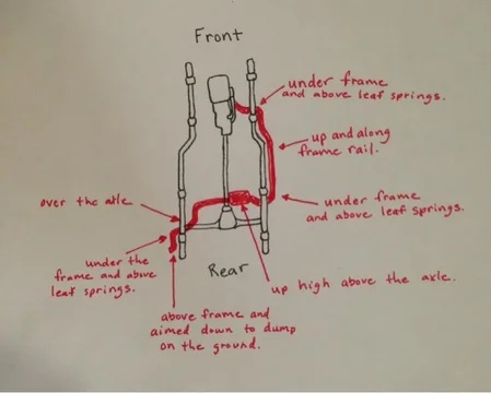

We need some advice on what route to go with on our exhaust. I've looked at loads of pics and read threads and I'm only finding pieces of my answers to my questions. I want to keep the exhaust short and simple.

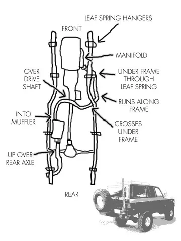

I found a schematic here on MUD of the original exhaust routing. Here:

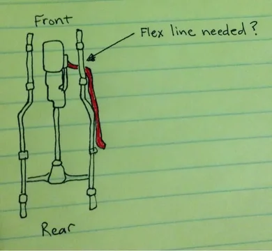

So first question is do I need to use a flex section in the exhaust like this?
Second question is should I go with 2", 2.5" or 3"?
Third question is can I route it like this without issues and would the fumes come up into the cab? The exhaust would run up high along the frame rail and dump just in front of the rear tire.

on the exhaust, it's better to have a few turns like your picture that goes out the drivers side. 2.5 inch pipe. also install an EGT gauge close to the outlet. Pre turbo if you get a turbo.
No muffler if you get a turbo, yes to a muffler if there is no turbo.

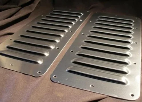

Hood scoop vs louvers...
I would have a scoop made something like this:
Big enough to also put our logo on top of it.
Or...
Louvers like these:
Pro vs Cons on both, personal experience would be good. Thank you!
