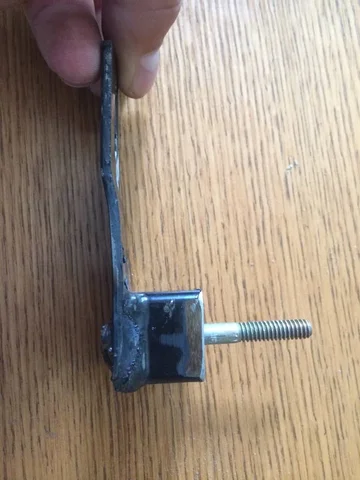

These little guys are replacing the 4 hooks that are stock

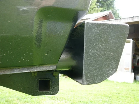

Looks like you have a lot of fun with your rig! West coast winter wheeling at it's best! That is a nice looking rear bumper, any more info you can pass along about it would be appreciated.
So you are going to build the inner platform without removing the second row seating?
The rear bumper was built by Geoff(604) 290-4321. Does a good weld.
Gonna keep the rear seats for work. And if you fold them down and put the head rest down first. My storage will be at the same height. So if i choose to sleep in the truck I can extend the storage flat. Got a mattress that fits perfectly in there. Just the humidity is terrible sleeping in the truck.
1989 hj61
You can tell Geoff that is really fine fab work. Have you hit it hard? I have to finish the corner of my build and these pics are
perfect to help me finish it off. I was planning on something similar, just haven't got to it yet.
Hit the right corner pretty hard. The 60 has a huge Arse! now the fuel tank door scrapes a little on the side bar. Bumpers not perfect, but I hope I won't drop the rear again that hard.
