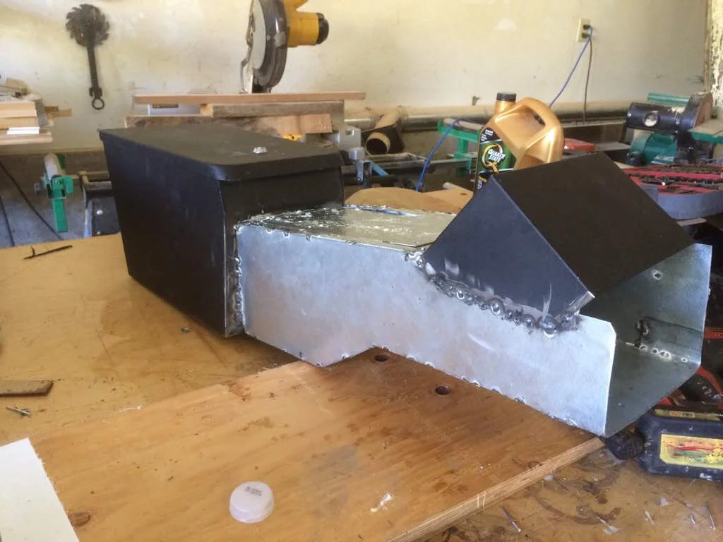

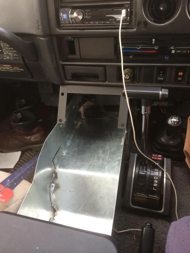

Therefore, being less driven and focused on Overlanding. There will be some exciting transitions to come. As a simple token to this transition my self and an other adventure enthusiast started to tackle a few things on the list.
A middle console for the cruiser that will hold a vhf, switches for lights, maps, fire extinguisher...Etc

Wow, looks like fun! Nice temperate west coast winter. I really like that console, I have a 5spd but thanks for something for me
to copy, the idea has been rolling around in my head - pics make it easier.
