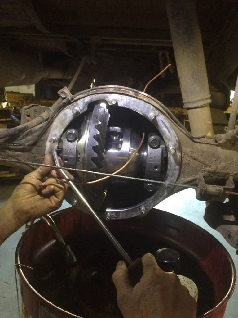

Having a problem...vibrations at 100kms.
Once again I have an auto. Long story short, as short as possible.
This vibration at a 100 is when the gas pedal is on. In action. At the speed of 100 (giver take 5) I can be at the speed of 100 and release the gas pedal -result - vibrations stop. Smooth sailing. Once I'm at 120 the vibration is there but not as loud. I can cruise comfortably at 130. Strange right!?

Was told to check my rear diff. But if something was wrong in the rear diff then would it not have a similar vibration the whole time?
Any insight would be greatly appreciated.

Could be a bad output bearing on transfer case, or pinion bearing on diff if all above checks out.
Is there any metal shavings or metal deposits on the magnetic drain plugs?
Also, is exhaust secured, not wandering or making contact when engine revs and tilts/moves?

I was going to say pinion bearing, but looks like you are in the rear now.
