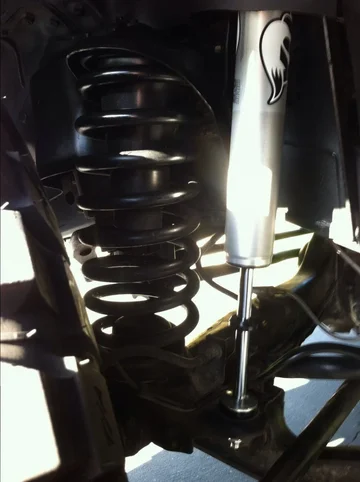

For those interested-
*500 mile report, mix around town/highway/16 miles graded dirt
(Set-up F&R) 50mm Constant rate King Coils (AUS) + Fox 2.0 IFP 1" - 2.5" lift version
315 BFG KM2 36 psi (highway) 20 psi (dirt)
Fairly light 80, ARB bullbar (no winch), Slee sliders, factory rear bumper, no 3rd row seat/empty cargo area
*Previous set-up, OME 850/860 (heavy/med) OME LTR's w/reservoirs
I had no complaints about my previous set-up other than after 8 years it was feeling tired, & I was unable to find anyone to re-build my LTR's (in the USA)
So far I'm very happy with the Fox IFP shocks, the valving front is spot on for my set-up, not to firm or to soft, feels very much under control. It also seems to handle the small & large bumps equally well.
The valving rear, may be too soft once I load up, but as of now it feels spot on. Overall I would not change a thing.

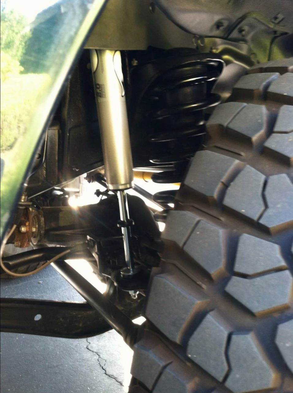

I just installed these shocks two days ago. My lift setup is OME 850+1/863's in the rear.
My truck had the bumpstop brackets when I bought it but I doubt they are factory. They are 2" blocks above the rear bumpstops.
Here is the truck on a forklift:
Fox IFP shocks/OME 863/850 +1" spacer
by RickaShay24, on Flickr
Rear tire was rubbing rear portion of the wheel well pretty good when I stopped, I would consider this very close to maximum articulation. Notice the remaining stroke on the shocks. Bumpstop was within 1/2" of contact. (ignore my ghetto bend brake line... lol) :
IMG_20140820_124449
I have only city driving on them so far. Compared to the near new OME "L" shocks I was previously running, these are a tiny bit softer but not much. The big difference is in the valving. It seems quite a bit slower on rebound than the OMEs which smooths out the ride considerably. Feel more controlled over large bumps etc. Will have a trail report in a week.
