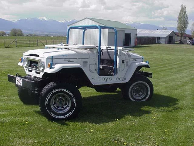

Dang, I remember the owner of that shop had a bad ass 40!!!

Also interesting who wrote that article. Harald is still around guiding people through the Rubicon. I usually run into him once a year or so but didn't see him last year. He rents clients an FJ40(he has 2), and he guides them through in his Jeep TJ.
Here is his website: http://4x4abc.com/4x4trips/competent.html
Danny Warden had a brown SOA late model FJ40. It was in nice condition but not particularly hard core by recent standards. V8 swap, SM420 etc.
