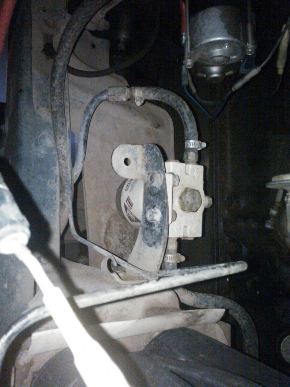

One of the best investments I have found to keep junk out of your carb (some of those inlines are just rock catchers). Ran them exclusively on the boat with rusty tanks, and decided to put one in the 40;
[120at]parker racor fuel filter/water separator, 10 micron
Well worth the money, mine even had a bracket to mount it.:cool:

Damn that's a good idea. Not cheap, but I may have to do that. Without using you as my google too much, are there cheaper options that do a decent job?
It is the initial expense for the body, then the occasional replacement of the filtering element (dependent on your supply situation).
I use the R12S. When running the boat with Mexican gas in Rocky Point (and cruddy tanks) I would replace after every season.
Racor R12S Replacement Element - R12S 2 micron Racor - Star Marine Depot
In the 40, I actually got 5 years after the first install before an element change and when it became time to rebuild the carb, it was spotless inside.:cool:

Awesome, great info. Makes sense that it's a housing with replaceable inner. Cheers!

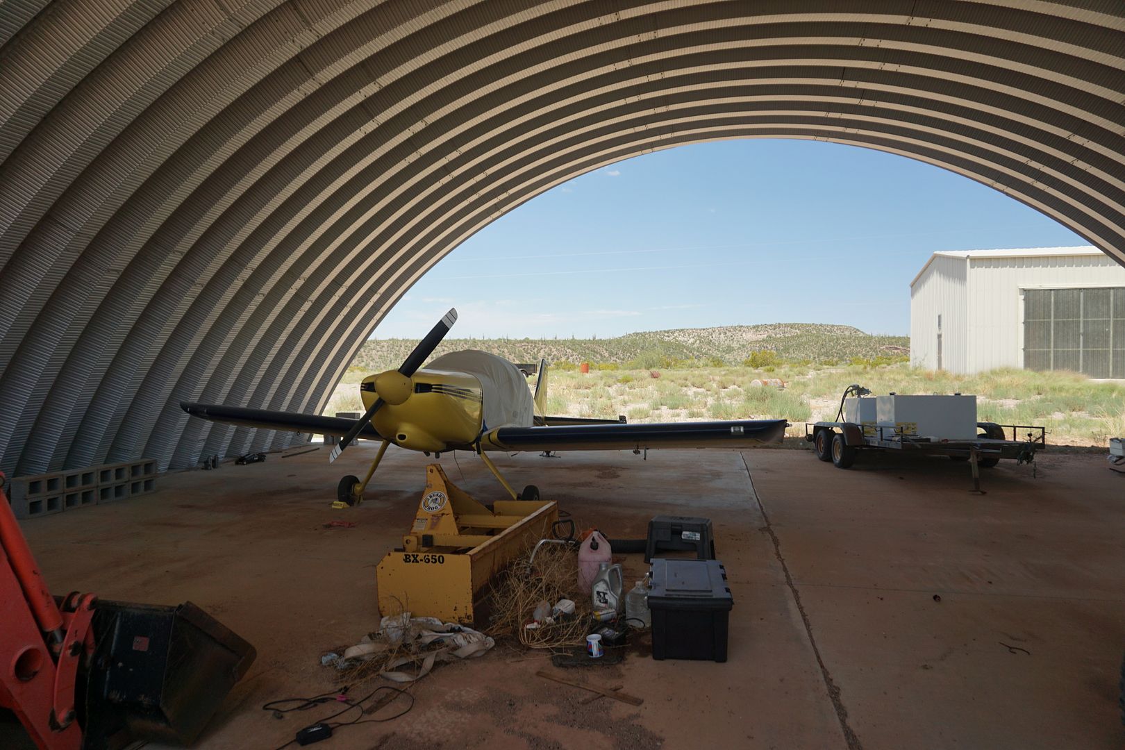

Out of curiosity, what kind of plane was the wasp nest on when you when to get the 40p..?? Looks like it was in need of rescuing too... Pitot tube was all blocked with dirt or something else... Shame!
Thanks! Fingers crossed. I am debating my next step. I like doing as much as I can myself, but I'm at the point where I need machinery I don't have. That plane had a prop strike at the dirt air field a few years back. The owner and mechanic are planning to head down and get it flyable again soon they said.
